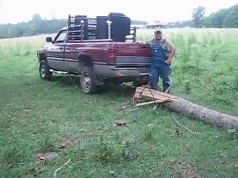

Trying to save the paint job on that log skidder?
I like the tree stand wayne I just wish my vehicles wore out like yours . there are no box left or floor or anything bellow most moldings

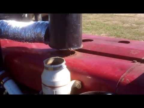

With some wood gasifiers it is possible to have them start up pretty fast and with no smoke . After reading the above I went out and video my first start up this morning . Also fired it up again in a couple of hours to run the wife shopping.
I think in some cases if I have open roads I could be 40-50 km down the road in the half hour you mention .
Thanks
Wayne
Ha! Wayne, you beat me to it.
Kristijan, I do the exact same thing as in the first video when I’m in the parking lot at work. I leave with a no more than 2 min delay. Another 10 s of gasoline on the fly and the fuelpump is shut off.
