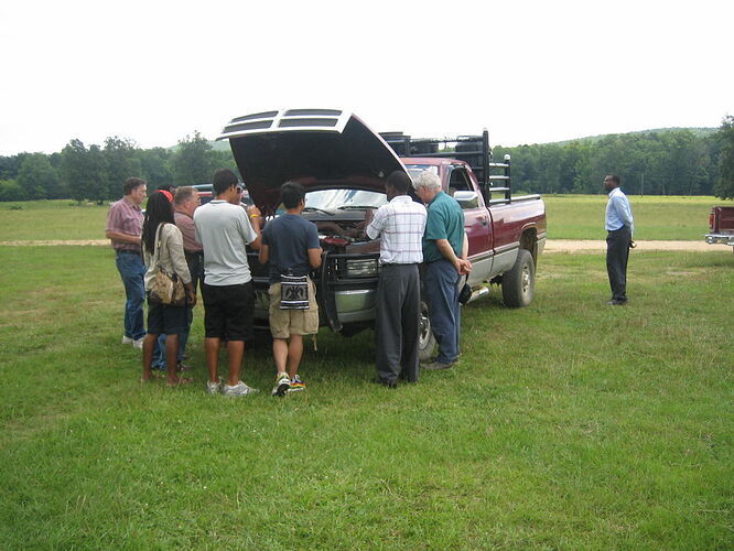

I took off long enough yesterday to show Dr. Larry Winiarski and some folks from Haiti, Nigeria, Honduras and Guatemala the V-10 and Dakotas. Sorry I can’t remember all the names.
great photo wayne, i think you and your gasifier has gotten world wide fame, it would be great if enough people would build gasigiers to make an impact on gas supply and prices.

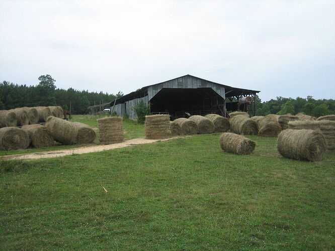

I work the V-10 good this morning. I hauled in about 15 tons of hay from about five miles out and then made another trip to haul my tractor in.
I used no gasoline except for starting.
I beat the rain; the hay is in the barn!

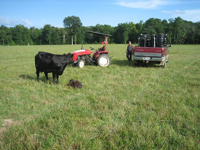

Wood power calf pulling,

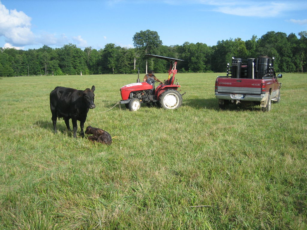

It was all in a days work for the ram. We chased a heifer for a while around the pasture with my son driving and me in the back. I finally roped the heifer and tied her to the truck (lucky she didn’t bang it up) we took the little tractor and between the two strung her out and was able to pull the calf and save mama and baby.
Hooray for woodgas! Now you have to think of a clever name for the calf. How about Roper?
Course we always called ours Hamburger…
