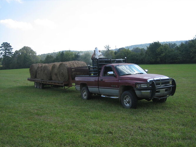

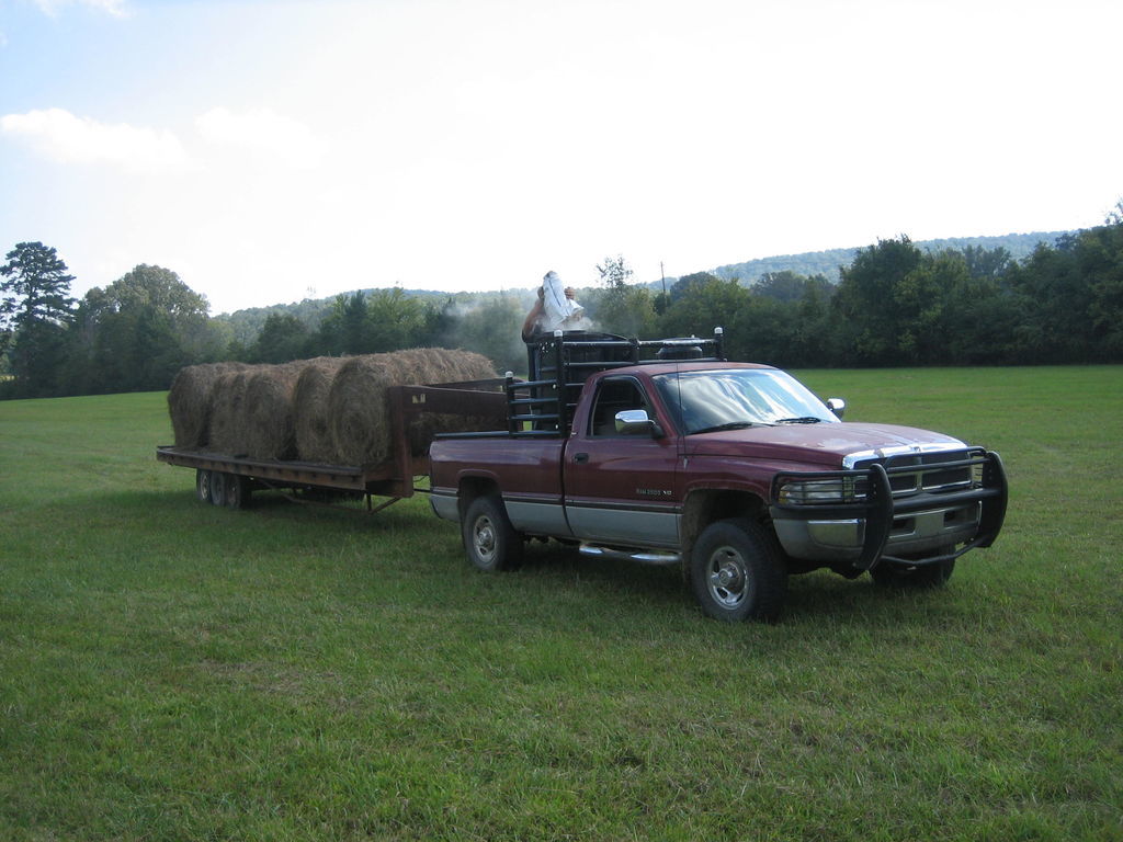

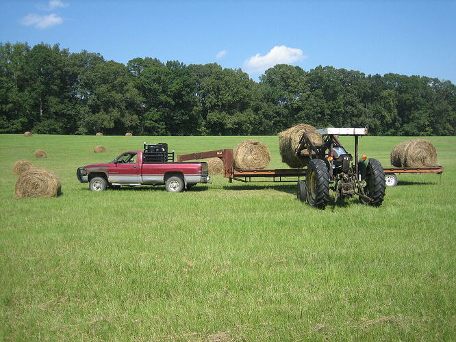

I put about 75 miles on the ram today but worked it all day long and dark caught me with no lights on the trailer.. I put 12-15 sack of wood through it. A lot of the driving was through hay fields, pasture and my dirt road. Hope to finish with hay by mid week.
Picture below are son loading hay and fueling the truck.

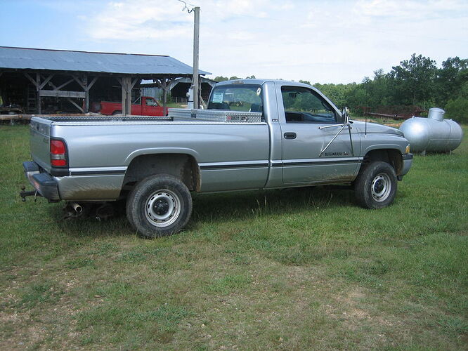

I have picked a truck I think will fit his life style( he loves hunting and fishing ) , full size 94 Ram, 318,4x4, full size bed, plane Jane. 95 % of his driving will be in a 15 mile radius of home (driving to school, town, feed store, feeding cattle). The ram will use a lot more wood than the Dakotas. (We have a lot of wood)
I will be adding a gooseneck hitch in the bed so he can help with pulling trailers and also he can us it to pick up extra $, selling fire wood, odd job, ect.
It would be a back up for my v-10 if for any reason the v-10 was side lined.
When he is a little older and needs to make longer trips I’m sure I would loan him a Dakota.
