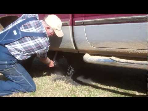

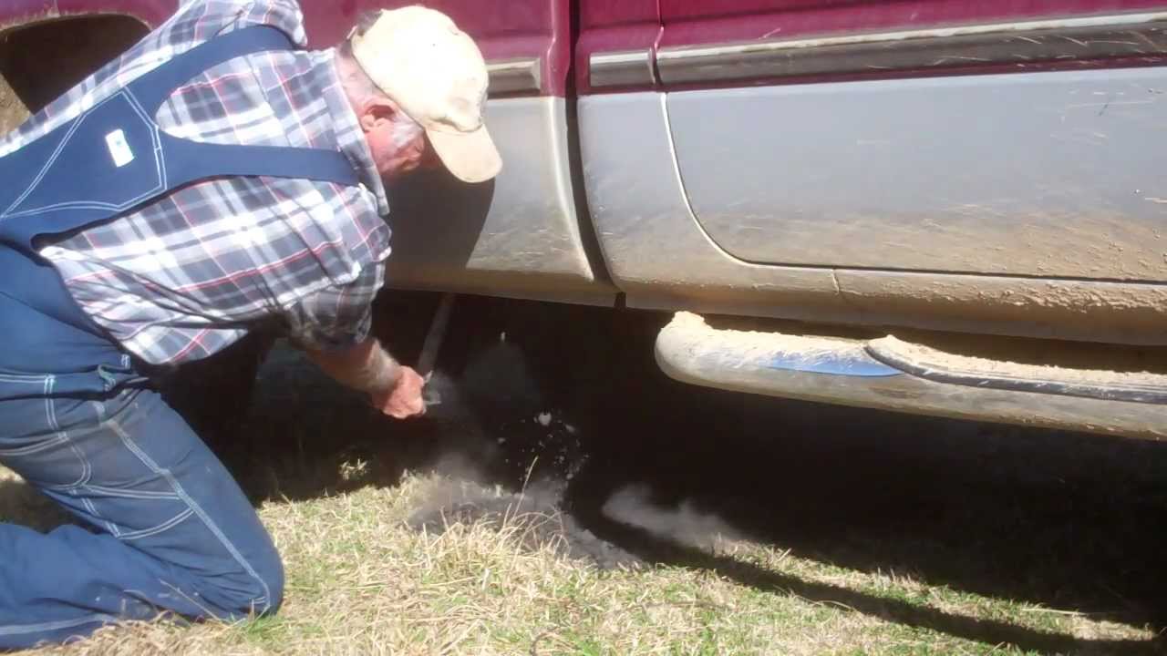

In response to the YouTube channel I was ask if I had to take the gasifier apart to clean the ash.
My repley,
It’s easy and can be done as quickly as a few seconds or as long as a few minutes.
I feel sure he didn’t believe me so I made a little clip to post.
Less than 5 sec.
BBB

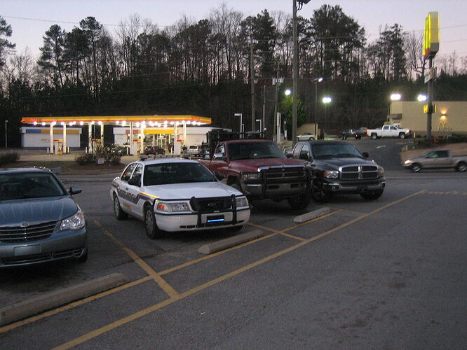

The family and I went out to eat tonight in the V-10. I took the below picture just as an officer walked out of the restaurant and to his car. I mention to the officer the reason I took the picture of his car with my truck in the background was that I have a lot of people asking the reaction of the police when they see my wood burning truck (gesturing at the truck as I spoke)
He gave a very polite little laugh, gave the truck no attention at all, looked at me as he was getting in his cruiser with a inquisitive look, like what the hell was I talking about.
He didn’t have a clue. He has seen this truck a hundred times and noticed it none.
One other note , 3-4 minutes before the picture was made the truck was going 70 mph ( interstate highway ) , it had been shut down less than a minute.
On the way home after we got out of town and traffic I let the Son drive.
