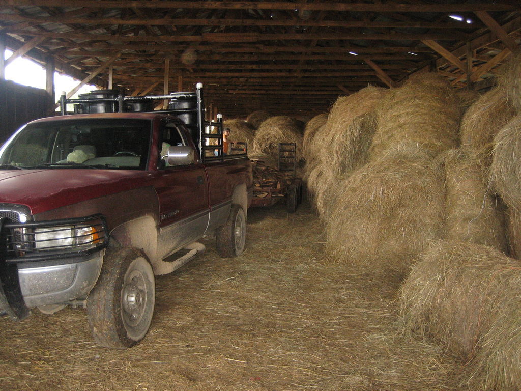

A pleasant surprise this morning while driving out to feed cattle. (25 mile round trip)
Down here it is said that a seven coarse meal consist of a POSSUM AND A SIX PACK. Looks like a substitution will be in good order!!

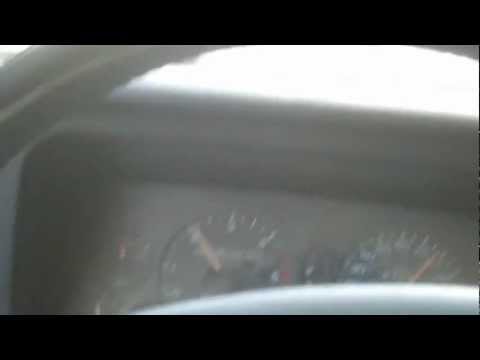

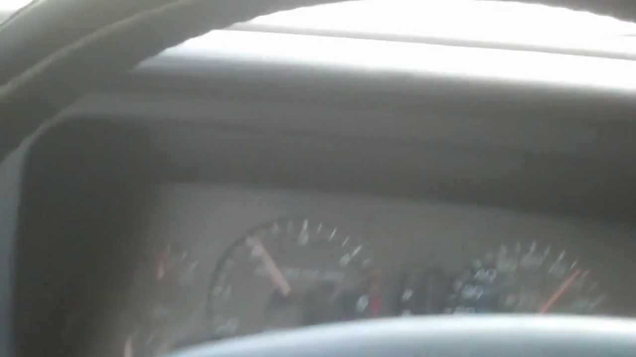

The V-10 has some very low gears but also some high . Below is a 30 second clip showing high gear.
2100 rmp and 80 mph.

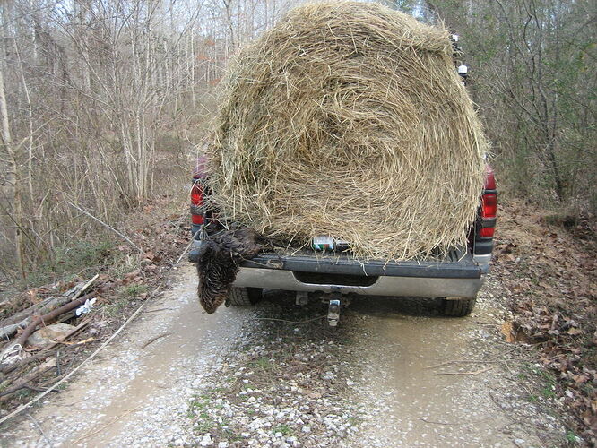

Hey Wayne
Looks like the cows were gonna get a drink and feed in every bite…Hey how much does one of those roll weigh?
Hey Neil,
I can roll the hay in different sizes and can go on up to about 1200 pound but I think most of mine will be 800-1000 pounds.

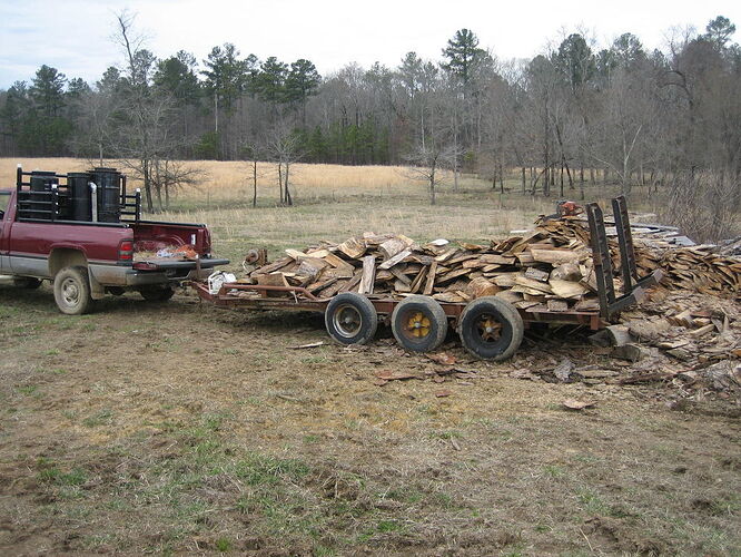

I hauled cattle this afternoon with the Ram. It was a 36 mile round trip , no gasoline was used except to start back up after being shut down while loading cattle . I can’t remember going over half throttle , no car passed me nor was I holding up any traffic running near the speed limit 55 mph.
I believe it’s the best it has ever performed ? Used dry pine for fuel ( or as dry as it will get here in Alabama )

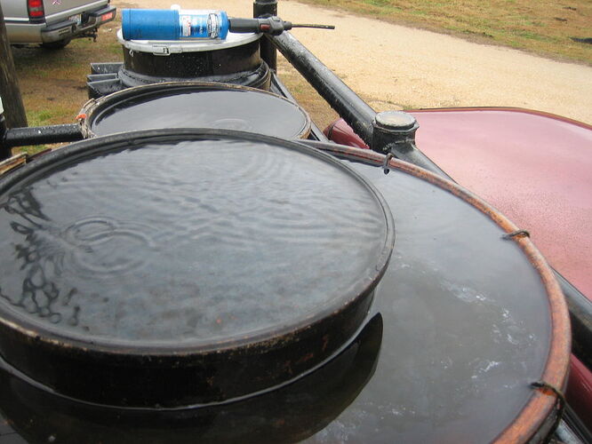

As you can tell from the below photo with water standing on the containers it is a wet rainy day in Alabama. Truck ran great while feeding cattle and a 20 mile trip. I will be putting about another 20 miles on it this afternoon.
SWEM  even in rain,rain,rain and mud,mud,mud.
The worst part is when you go fast, all that sooty water blows all over the back of the truck!

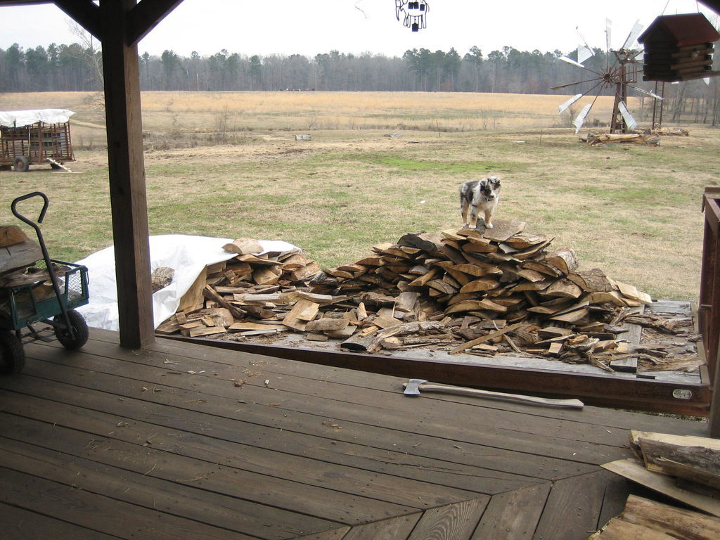

The wife and I just cut a load of fire wood and set the trailer down in the barn.  As soon as we use the wood on the trailer beside the porch I will switch out trailers.
I must admit we used some gasoline, about a pint for the chain saw but none for the truck.
We live close to Mother Earth, our out of pocket heating expense ( fuel cost ) for a year is near $10 also no fossil fuels are used and no tree was cut for heating. All is scrap material.
