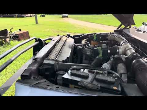

Do you have 2 fans under the hood of your work car?
Good morning Jan .
There are no fans under the hood. I do have fans under the bed of the truck at the rear .
You can notice two pop off valves ( big check valves ) under the hood that look very much like small fans .
Excuse me if I interfere, it is good to have the starter blower installed behind the gas cooler, that way we push the initial “dirty” gas into the surroundings and do not lubricate the filter and the rest of the installation, well, this blower should work for a short time, and then I would start the blower, which would push fresh air through the nozzles of the gasifier, since this way we heat up the hot zone much faster. This method also preserves the durability of the blowers themselves, at least that’s what I think. ![]()
That makes good sense, though if you see the way Wayne cold start all his trucks, it seems too work the sooner heat up ready too roll, and he has no fan failures that I know of.?? If your fans fail using them as the book says, it is likely that your wood had too much moisture in it.
