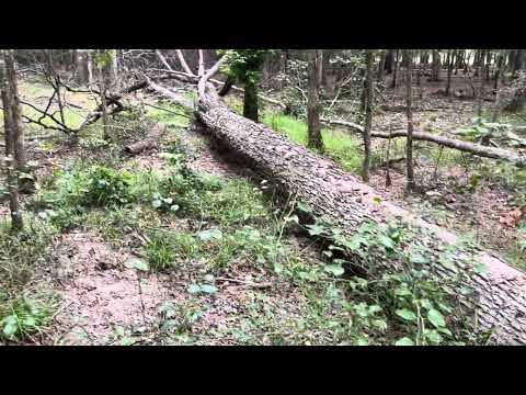

Wayne that’s a really nice size tree. If that was chunked up you won’t need to chunk for the rest of the year at least. I really appreciate you showing us the forest you have down there. It turns out I was out in the bush filming too.

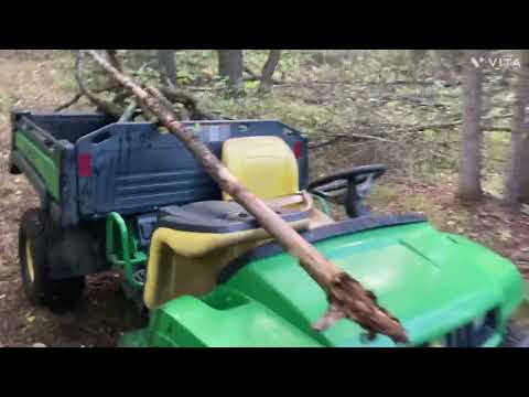

The trees we have here aren’t nearly as big as Wayne’s but there is a lot of dead trees that can come out. Today I was getting some small diameter trees that will fit into the chunker without a lot of processing. I was hoping to get just oak but ended up getting a few spruce since they were already down and were the right size.

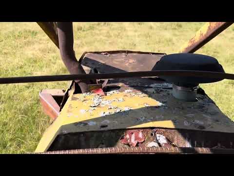

I was trying to get a tree up that had blown down and was still attached to the root ball . A little too much for a farm tractor so I put ole yellow to it . :grinning:
Wayne, you may have missed a few spots when you last polished the hood and instrument cluster area :joy:
Yes JO
I see many spots I failed to polish :grinning:

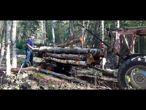

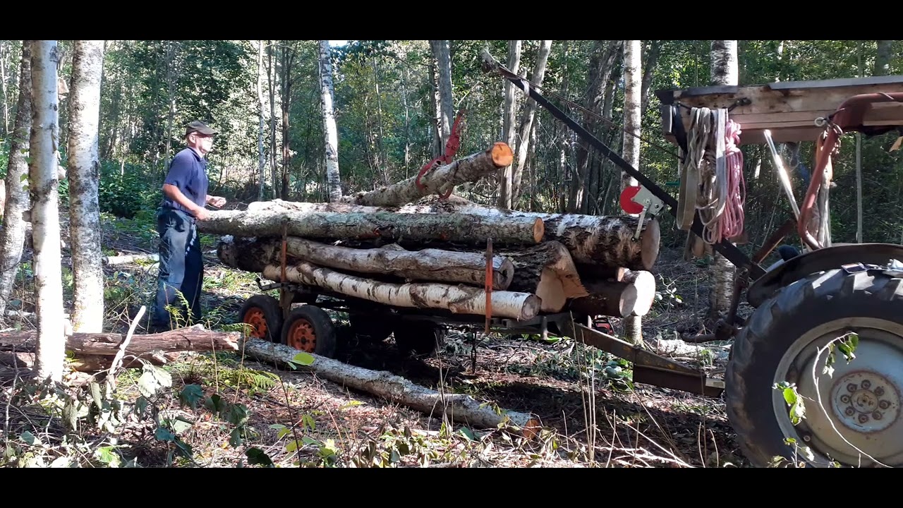

Put ole little gray to the first load of next year’s firewood.
I forgot about the camera at load no2. This is no3.
Tell me if you want me to stop. There will be about 10 more next few weeks :smile:
No4
I didn’t really pay any attention to that boom on the tractor before. Did you load the logs in that first picture with that? I’m surprised it didn’t bend extended that much. Didn’t notice the ladders either. What do you use those for? I like the overhead storage. Nice setup all around.
I think what Tom just said was we need a start to finish video on load #8
And I would have to concur :grin:
Tom, I made the boom just last year. I haven’t tried it out much until now. It’s only 2" square tubing, but if you look closely it’s brazed with a couple 1/2" rebar rods.
Yes, those sturdy logs in the first pic are loaded with the boom. The tractor’s hudraulic arm power and also its weight in the front are the limiting factors - not enough to bend the boom. I usually lift the front end of the log up first. If the hudraulic arms struggle, it’s enough to help the log a little by hand. Also, I can easily move the pully further back on the boom if needed.
The rear end of the log, with the overhang, is the heaviest. I kind of parbuckle that end up with the boom, which cuts the weight in half. Wayne’s expression “Poor folks have poor ways” comes to mind :smile:
About the ladder. I don’t usually bring one, but one of the cabin owners down by the river (close to our woodlot) wanted me to help him knock down a big birch that was leaning towards the building. I used the ladder to attach a rope high enough to bring it down safely.

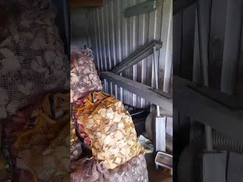

Bagged up some wood chunks today. Got almost twelve bags of wood here.
I don’t have a proper place to store the bags yet. Putting them on top of this stack of pallets will work for now. At least it will be under a roof.
