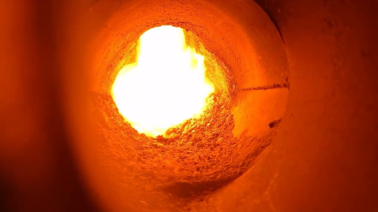

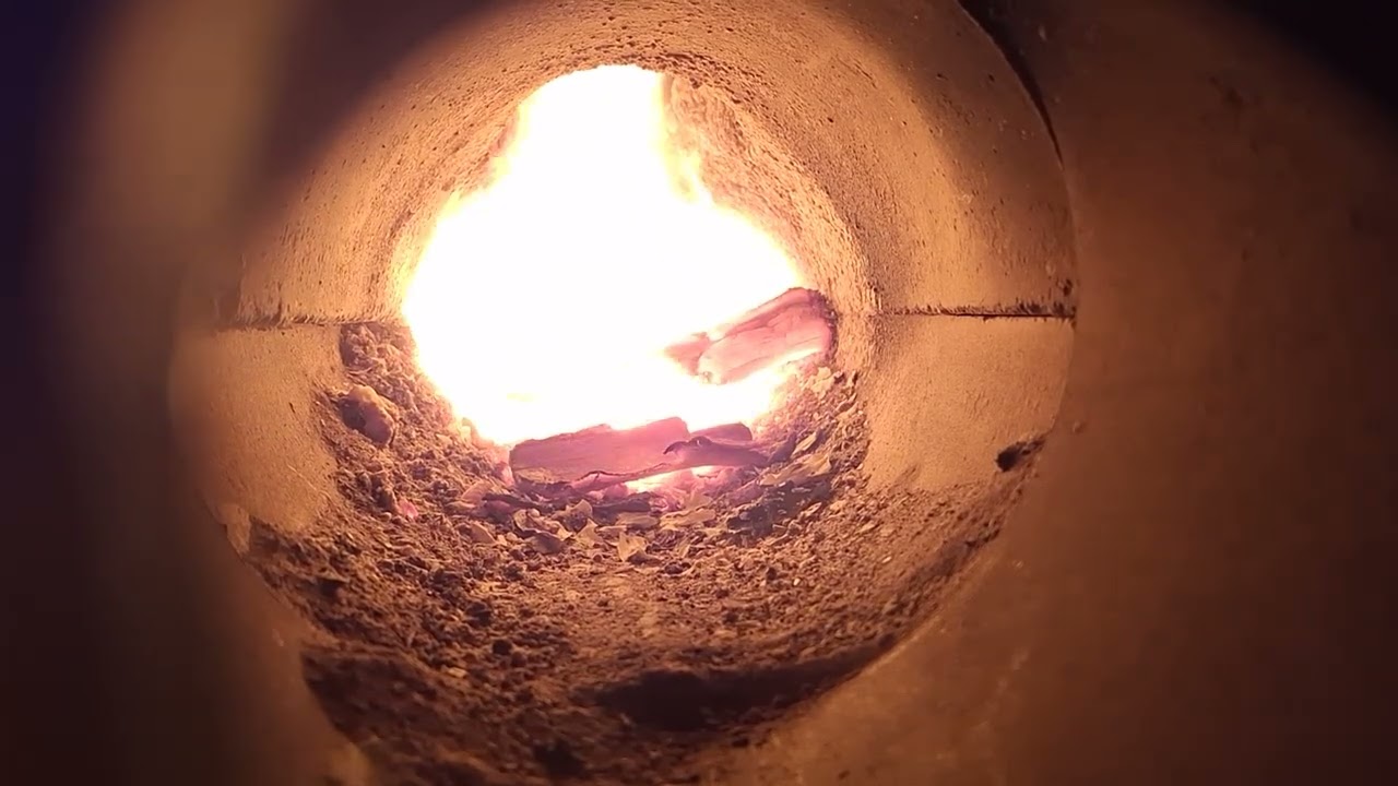

I know - you’ve seen my flames before, but I’m bored. It’s been raining sideways for a couple days now.
To all combustion nerds - I made two videos. All natural draft. No1 is within a minute or two from ligtup. No2 is about 10min into a 2,5 - 3h burn.
A confined insulated space with as much turbulence you can afford draft-wise makes for a complete combustion before the hot exhaust hit the water cooled tubes. The 23 yo refractory casting is still holding up. I have a new one stored away, so the boiler should last until I pass 80 :smile:
Thanks JO, really hot! Cant compete with you either. Your startup at best and the boiler is full with electronics :joy::frowning:. I still have a batchrocket from Peter Berg somewhere….when I retire…
Joep, I’m unsure wether you’re refering to mine or your boiler. Anyway, mine has one solionid to keep the gravity closed air inlet hatch open and two old fashion thermostats with gas tubes (similar to a fridge). One to close the air inlet when flue temp is down (end of a burn) and the other one to do the same if water for some reason should climb towards boiling temp - that’s all. Fits my ideology - to have as few things as possible you can’t fix yourself. Why I keep picking at @JohanM with his touchscreen boiler :rofl:
