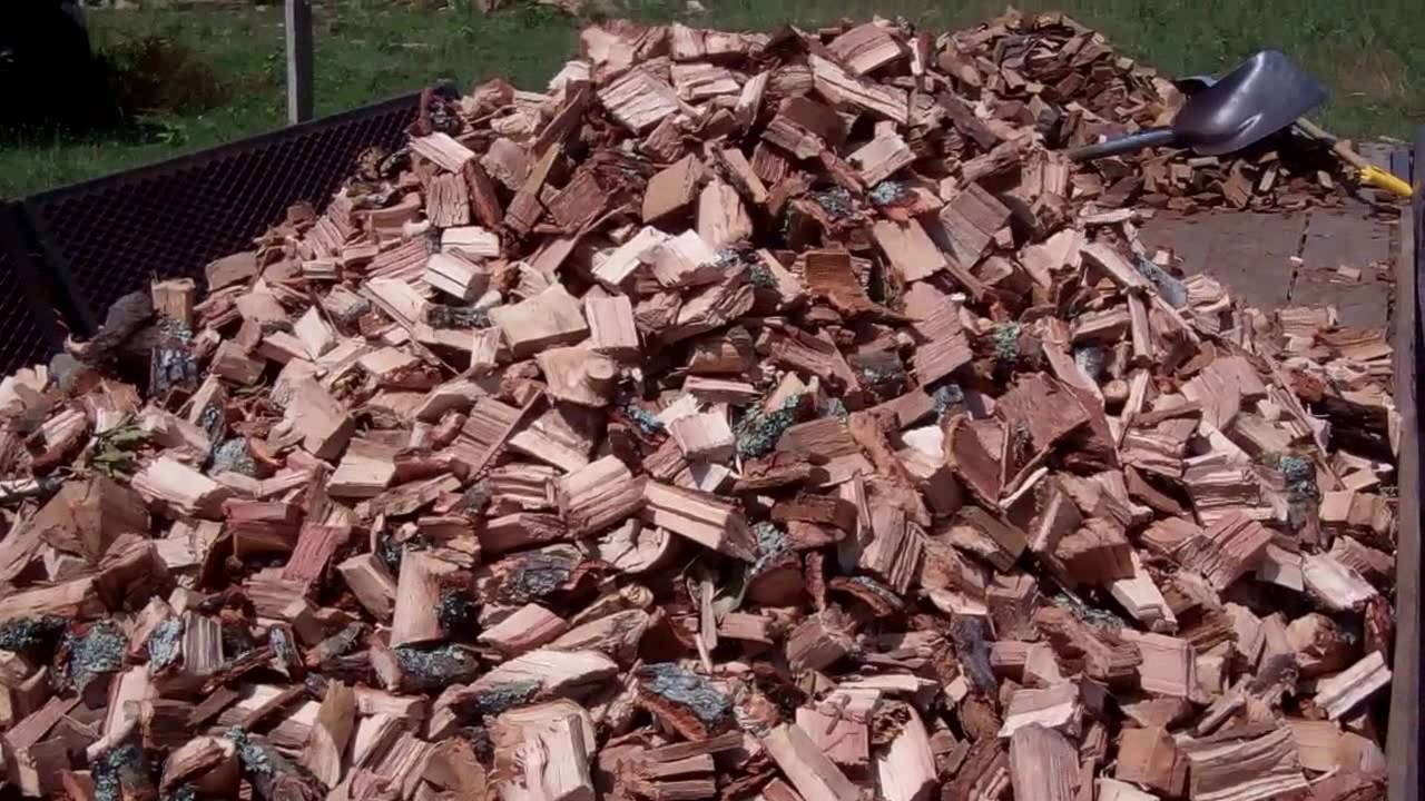

Just for the fun of it!!!
Thanks Herb now I know how to get through that pile of patties faster. I never thought to use my camera !
That is making some mighty fine chunks. Seeing, you sold the Caddy, how about shipping some chunks this way. Just don’t ship me any with fingers or finger tips in them. TomC
hey if there is free chunks out there I’m not picky i’ll take fingers and all
Hello Wayne
Good wood pile, Do you think wood can get to old and dry to make good fuel.
I chopped some boards out of a bran that had ben dry for at least 70 years they burn good but with not as much power. They were like petrified oak maybe to dry.
Hi Jim, all wood dries to a level consistant with the relative humility of the air around it. The south is a little higher than the north, which is a little higher than the southwest. Air drying will yield about 20-25% moisture in the south. For 1" or 2" boards, 6 months is the same as 6 years. That’s why a kiln is required to reach optimum levels for cabinetry (8-12%) or a little higher for framing lumber. Wood will deteriorate due to extreme heat or high moisture levels, and wood that has undergone some mold or mildew can never be restored to original quality.

The wood can get too dry to chunk in a hurry but as for too dry to use in the gasifier I don’t know .
I think Carl nailed it pretty good.
The humidity here as I type is 93%
Hello Wayne & Carl
I guess I used the wrong words when I said to dry.
Should have said old and brittle, when prying off 1x6 boards a lot of them will just break before they pop loose. But not rotten just rock hard giving the appearance of being bone dry so to speak.
Cut this up with a table saw and some times I could see sparks. Mixed some fresh cut green chunks with it and made the old truck run like a wild cat.
I’m no expert on this, but I seem to remember some discussion of adding a bit of water for more hydrogen in the gas. Perhaps if this wood is dryer than normal, it is containing less hydrogen and less power. Since you gained power when you added some wetter stuff with it, seems to support that idea.
Green wood would also have a lot of the sap (sugars and tars) in it, which are energy-dense. Since the rest of the wood was so dry, the average moisture content would still be low, allowing extra heat energy to be used to breakdown the sap chemicals.
You are absolutley right Jim, wood looses its energy density over time. The air, heat, fungi, bacteria ect. slowly break down wood to a point eaven if it is kept dry.
