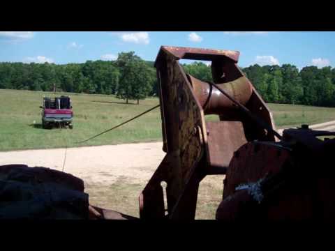

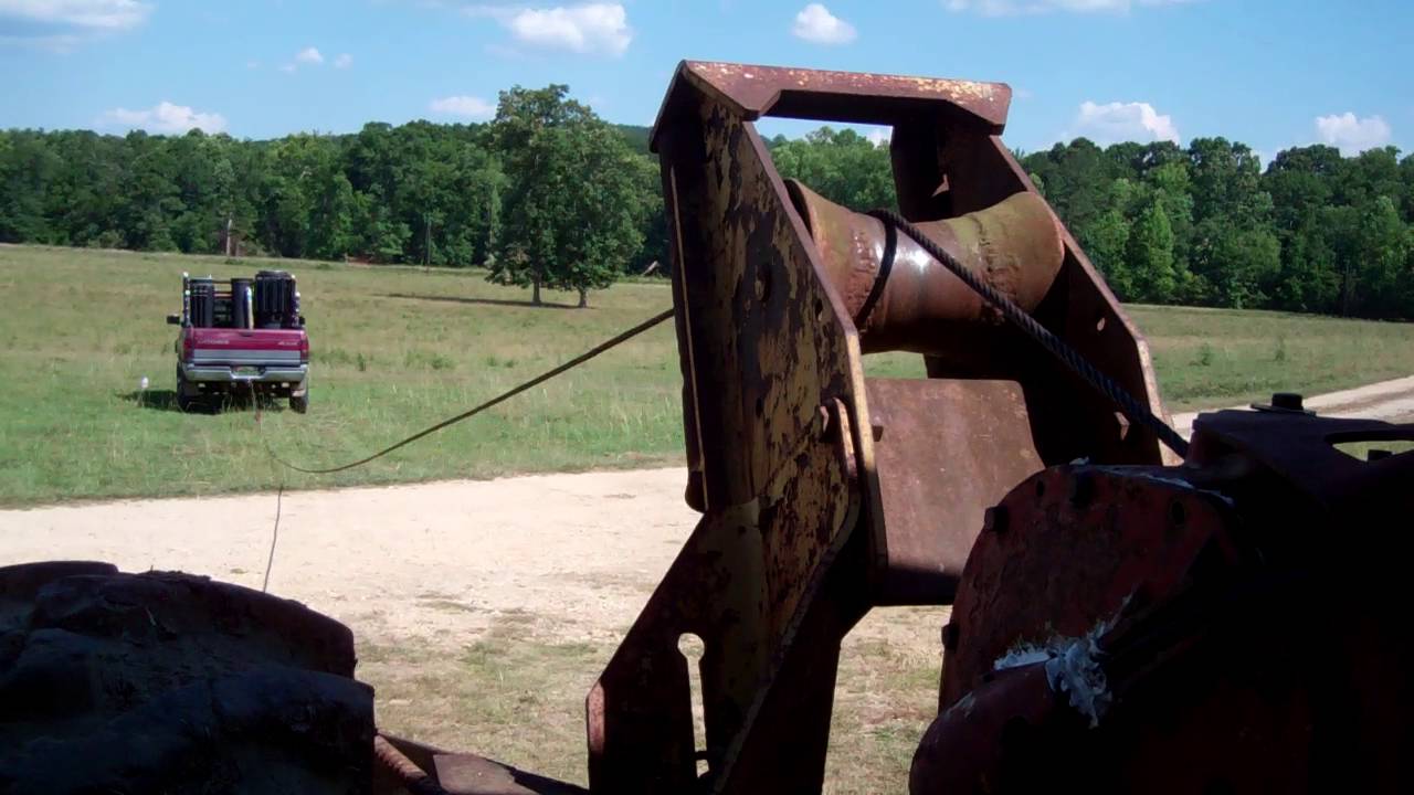

That sure is a nice machine. I’m surprised that it doesn’t see more use… :grinning:
Thanks Jeff .
I think it will see some use this summer . I have a lot of big trees down with most of them in the creek . The 150 ft of cable will be handy there.
Hell Jim Goes .
I took the little live swivel apart and figured out how it works and gave it a good cleaning and now it seems to be working well .
I sure hated to spend 150 bucks for a little part the size of your thumb.
The hydraulic cylinders that controls the blade are leaking bad and hope to reseal them next week . I was able to work the winch some today without wasting a lot of hydraulic fluid . :grin:
Hello Wayne
Good that its working, did you have any problem getting the little screw for the spool drag freed up, I found some that was really stuck.
The hydraulic cylinders are simple to rebuild and not real expensive.
Hello Jim .
Yes I got the screw out but the spring was missing. . I will put a drag spring in it as soon as it frees some. Right now it is all I can do to pull the cable of by hand . Once I have the skidder going and hook to a stump I think I can polish the drum so it will release properly .
Wayne
One little trick you can try if it keeps being a pain is to pump the handle down fast a couple times then jerk it up on release. I don’t know way but it will make them free wheel better.
Yes Jim . It’s kinda like pumping the brakes up on an old car.
I think I am getting the full stroke on the hand pump . I rebuilt it and the two cylinders in the winch .

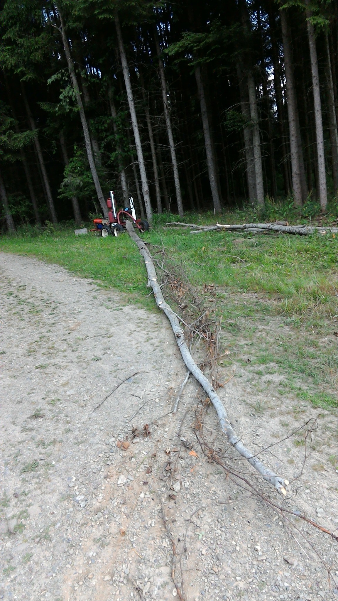

Dad was running the Chomper and I was fetching stems for him. Too long for this rig but it did it.
And here’s the movie. The saw logs were twitched out with the skid steer. Blow downs are hard work. :anguished_face:
