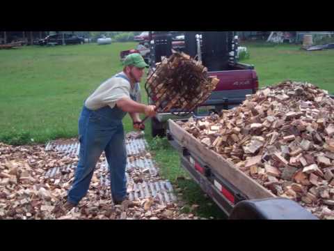

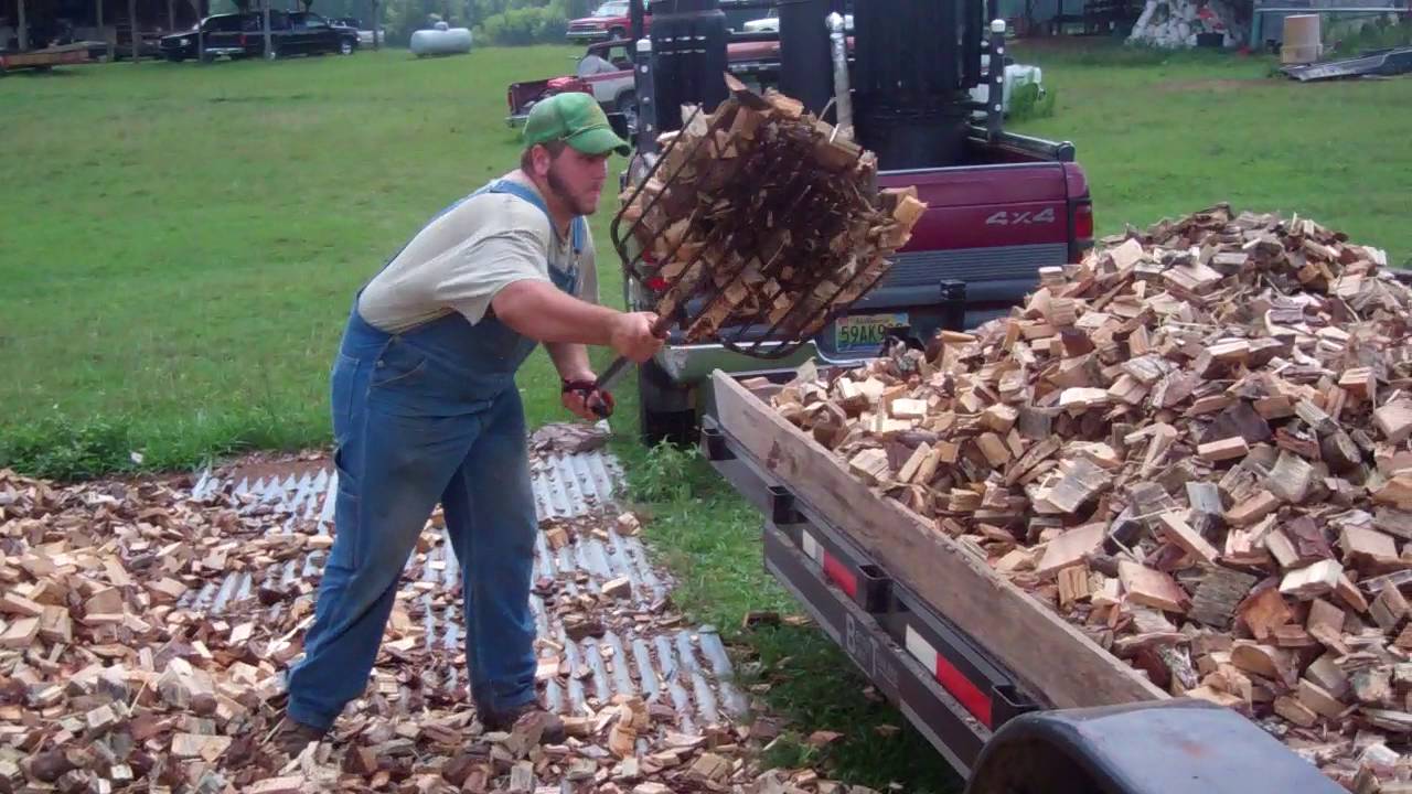

Have Wood Will Travel :grinning:
Ok Wayne, you can delite my posting from yesterday :angry:
You make us all look silly.
But on the other hand I save 3-4$ on every scoop :grin:

This big ole wood hog needs much more wood than your VW.
I really don’t need anymore wood right now but the wood is piling up on me and I have to do something with it.
I have been doing a lot of unnecessary driving but wood keeps coming .:grinning:
Wayne ,it looks like by now you must have enough wood to supply the military in the event of a fuel shortage. Probably enough wood burners for the local sheriffs dept as well.

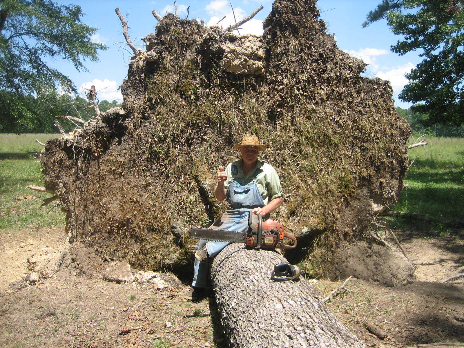

These down trees that have 5-6 tons of dirt on the root ball can be sawed off at about 30 foot down the log while sitting or standing on the log and really go for a ride . Kinda like a sling shot :joy:
Did you get a free ride, i think i like wood gas better than sling shot rides

No sling shot ride .
I learned a long time ago that these down trees have to be handled differently than others .
I did show my son where he would likely get hurt sawing into these logs . .
How does it behave when you saw close to the root ball? Just trying to learn from your experience

If I saw close to the root ball from the top side of the log the log will split. That is OK if it is for fire wood but not if sawing in to lumber . It should be sawed from the bottom of the log until about to pinch but hard to do that because the log is pushed in the dirt.
I skipped on up the log to make my first cut at about 12 foot. Cutting on the bottom of the log until about to pinch and then finished from the top side . Being very careful because the base of the tree stood back up after cutting .
