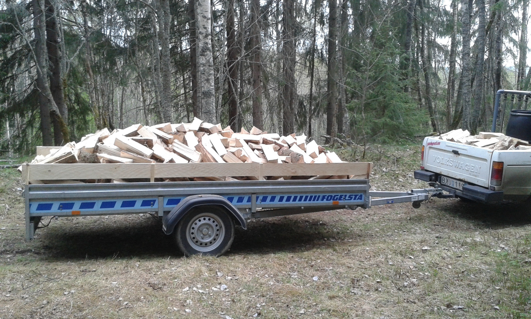

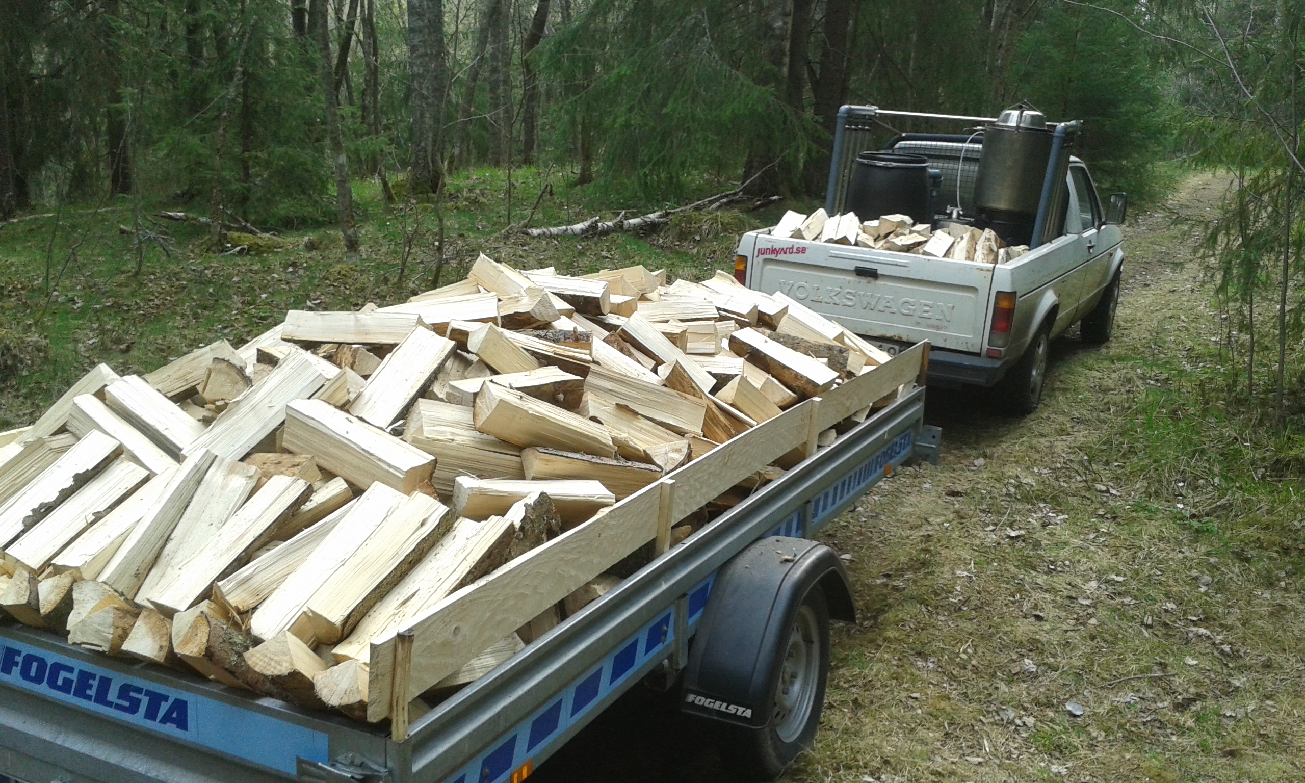

The Rabbit got only a short rest while the gasifier was fixed and then back to work again. A late firewood order ment knocking down a few dead standing spruces. Two loads, 25 mile roundtrips, delivered to the customer.
That Rabbit sure can haul a load…always suprising what it can do!
Bryan
Hauling a load is the only time the suspension feels anything near comfortable

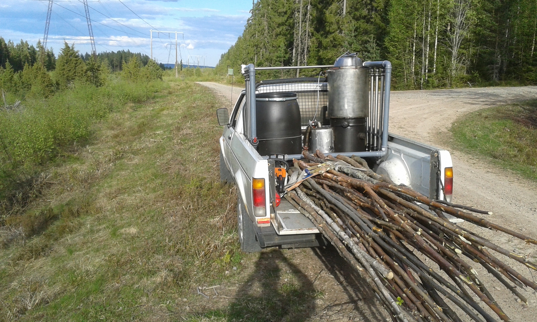

I went clearing a few birch bushes under the power line. Brought them home and chunked them emediately. Another 200 miles of fuel drying. The weather is said to be nice and warm during the weekend ![]()
Looks like the treebuds exploded there! In your last report all was still asleep.
