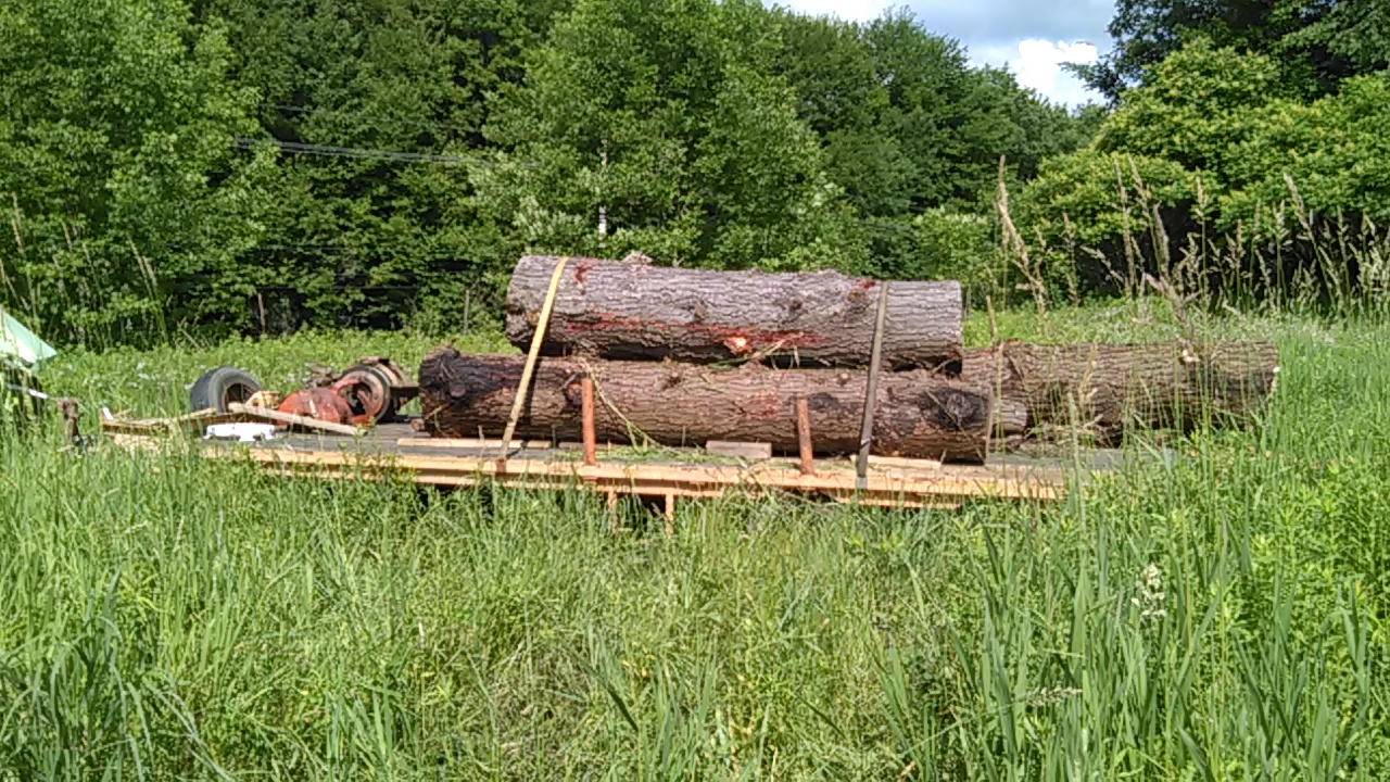

Moving a load of hemlock today. It’s a small load because I still have to get the brakes on the trailer working.
