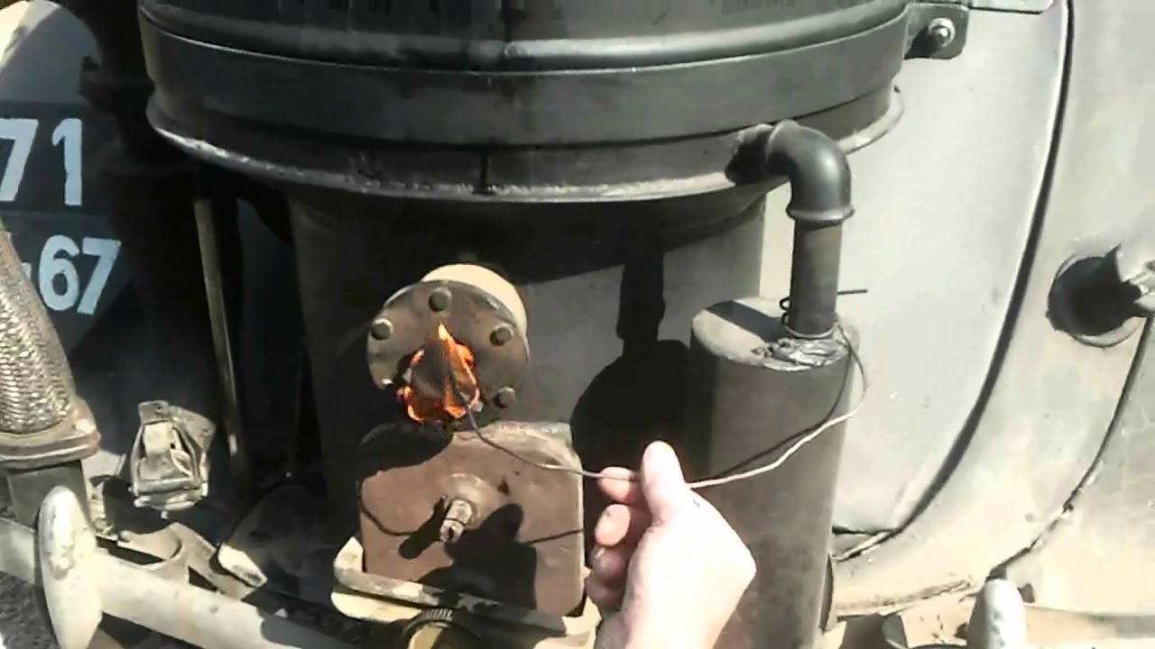

Drive test on charcoal Seat Arosa1.0 on charcoal

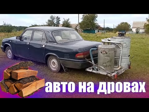

This was my first ever car project. I was 18 at the time and you have to start somewhere somehow… l DO NOT recomend coppying this by anyone. I poisoned my self once with CO (not in the cabbin but trying to start the autosyphon on the water cooling with my mouth - it leaked gas in water sistem) and l literaly set one back seat on fire when the gasifier overheated.
But all the failiures lead me to develop the “flute nozzle” to combat problems in this sistem and since then, many people started using it with good sucsess, so l guess it was all worth it ![]()
Just do not use your self as a test subject again like that. We want to keep you around for many years to come at DOW. You are our youth to carry the wood/charcoal torch of DOW into the future for others.
Excellent, excellent find SteveB.
CC is enabled. He is Ukranian. And it does Gear-tool translate over well into English at ~85%. He and the questioning interviewer fellow are speaking clearly to make this possible.
Very long at almost 60 minutes.
But well worth viewing all of the way through.
He presents like Wayne Kieth and MarcusN…
First showing how to fire-up. And get up to good operation.
How, what, and why to chunks fuel.
What it will do for you power producing driving. With all of the problems and characteristics.
Then white board illustrated where internally he has have evolved to.
18 evolved revisions. Three engine valves tarring ups.
And he says I still strive for better, simpler.
I very humble man.
Watch for details such as his hopper steam out vent when warmed up and sitting. Second added lower rows of air jets adding in lower oxygen at times.

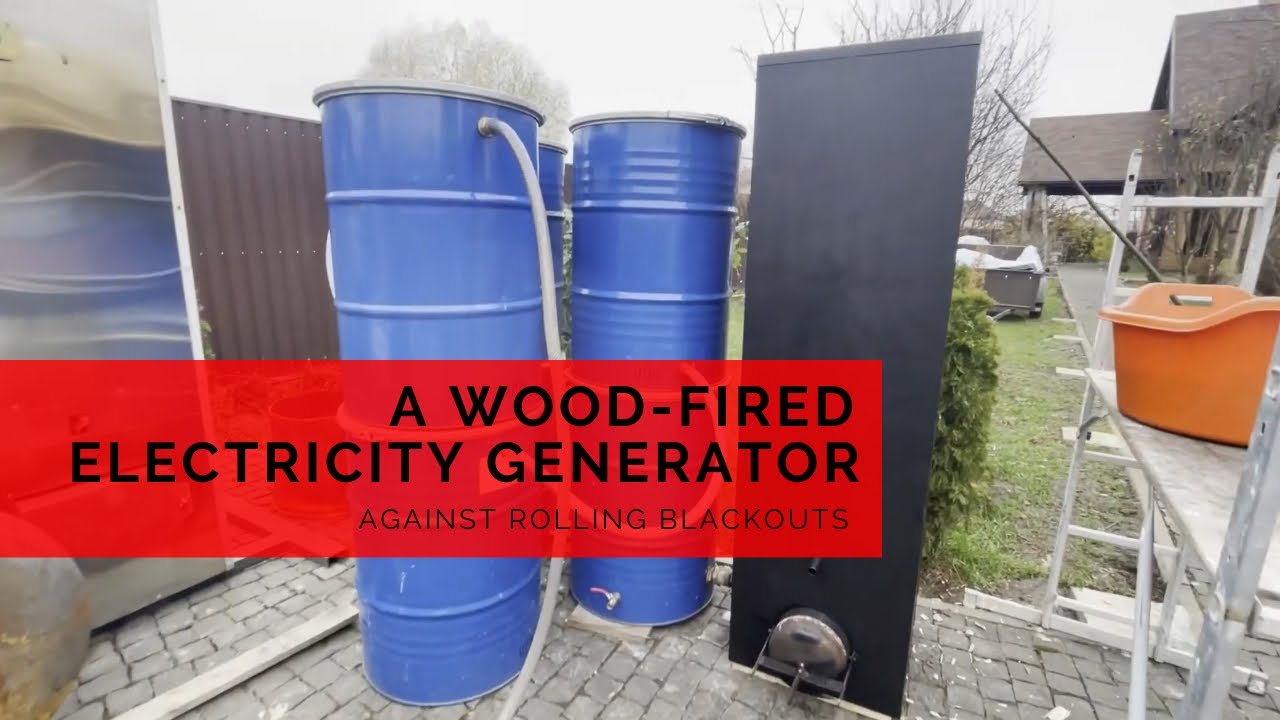

Here is a new woodgas running an electrical generator:
Designed and offered up by our member SergeyL.
A good designer-builder makes for the specific usage. Automotive systems must be light-weight, and compact.
Stationary you can go big, bulky, and tall.
And very, very simple.
The old, in-English wisdom is: “but The Devil is in the Details”, (the difficulties overcome are in the fine details).
Note the tall, tall fuel stack to allow this to be an air controlled open top. Note the long, tall steel poker rod for this system. That 13 hp engine at 3000 rpm will be at least a 389-420 CC.
The large directly driven generator head is a MeccAlta world class unit. Both large to heat load the system well. Six cooling filter barrels? Why not. Simple does it better in personal usage stationary.
