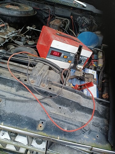

Had some spare-time to tinker with the truck, fixing some wiring, and mounted a new temperature probe before the mixer.
Still some leaks to fix, but weather dont allow working with silicone or tape.

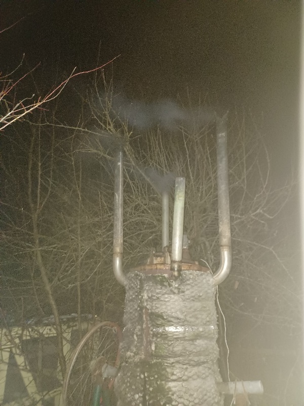

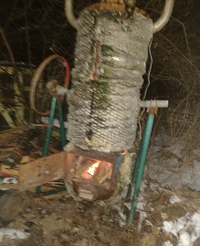

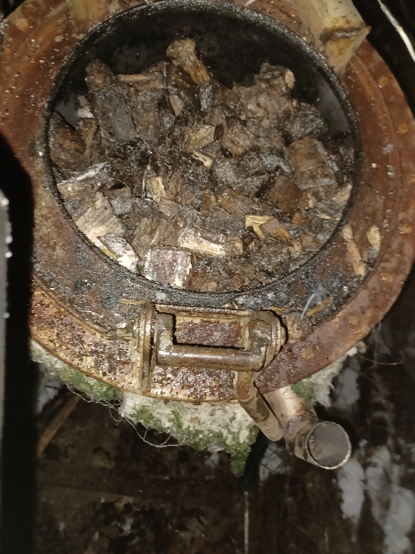

One problem is im out of wood, or dry wood to be specific, i have 15 bags of chunks that has been left uncovered some 3 years, the chunks are like wet sponges, so i do some experimenting: i loaded my charcoal retort with wet chunks, and boil them dry, will report the results tomorrow when it cooled down.
Loaded with wet and icy chunks.

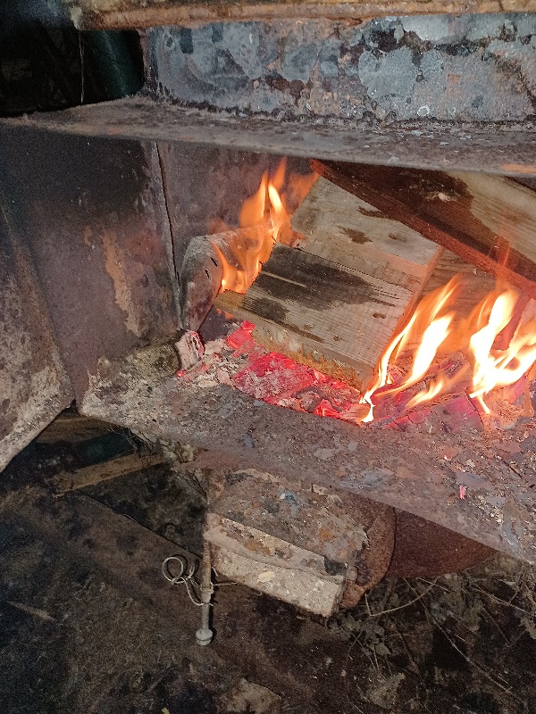

Started a fire in the firebox.
When making charcoal the pyrolyzis gas is directed to the “nozzles” in the firebox, one nozzle visible to the left.

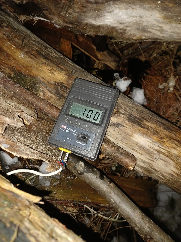

Now just letting the steam out, when steam no longer visible the chunks probably should be dry.
I check the temperature in the gas outlet, steady on 100°c, when it raises fast i “shut it down”.
I know, much work to get dry wood, but i really want to drive some in the truck soon
And: i had an enormous pile of scrap wood, (fiber board, bark, twigs, paper) good for burning in the retort.

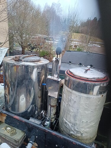

Did a little fixing on the truck today.

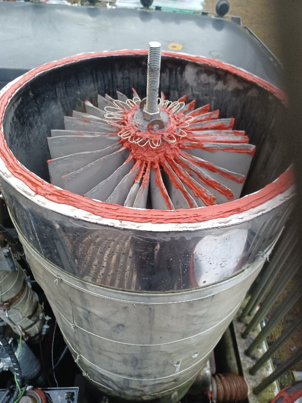

There was a leak under the gasket on the filter lid, there was a weld making the seal surface uneven, i decided to smooth out the surface with silicone.
Some thin plastic wrapping to let the lid seat the surface.
I really want the filter airtight, there are sayings a hot/cloth filter be completely destroyed by glowing particles setting the soot-cake and fabric on fire, my believes is there are no risk of a filter-fire as long as there are no oxygen present. The glowing particles should “suffocate” before reaching the filter, what i think proves it is on my setup there must be glowing pieces leaving the gasifier, and i havent noticed any burns on the old filter.
Something i believe in theory helps, is when i shutting down, i dont close the filter, the “after-gassing” leaves small amounts of moisture in the filter, quenching any glow before oxygen reaches the soot. Just some theories though

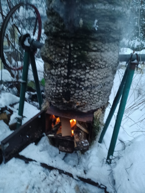

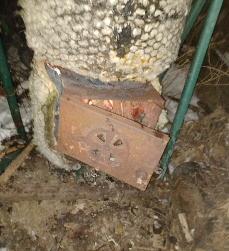

Stuffing the charcoal-retort.
Burning some scrap

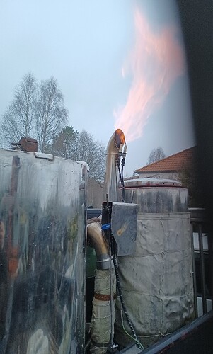

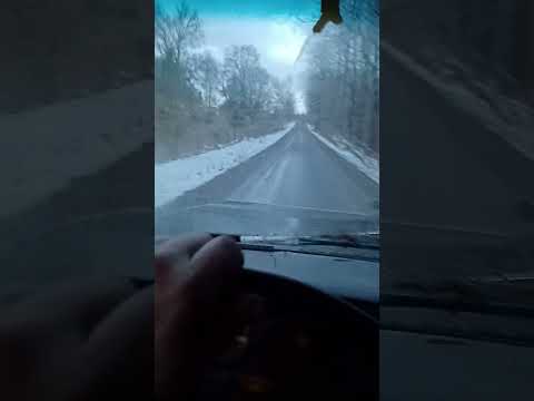

Finally, woodgas friends, welcome to take a ride with me. ![]()
Sorry for the blurry, shaky, video, and all the stuttering.
Also learned it maybe better to tilt the phone, to film “wider” but it was so hard to hold it that way… and that cover flapped down in the way… ![]()
Light-up
Stand by! CLEAR!
We have a flare!
Still as exiting to drive on wood, feels like the first time i managed to run an engine on wood!
Celebrating with a cup of coffee, totally shaky! No woodgas-poisoning, just happy and exited i hope
Thanks very much Goran for the ride !!
That made my day.
That was a wonderful wood gas drive in your truck Goran, glad the snow has melted away so you can drive the truck around. You have a very nice DOW truck.
What Wayne and Bob said.
Göran, I could hear you smiling when accellerating ![]()
Goran, I love your posts, especially the movies, well, it sounds like your truck is breathing heavy gas, when idling it sounds like a race car ![]()
Thanks mr Wayne and mr Bob, yes as for the snow, more is coming tonight, but im going to take a snow-ride soon
, i have no studded tires for this truck so i probably don’t film when driving then.
Thanks JO, yes that smile are still visible, my face starts to feel sore ![]()
Thanks Tone, yes it felt very strong, but the sound are more due to some big rust holes in the exhaust i found today (more work…) also i have to adjust the timing somewhat earlier, i’ve found it sounds funny when timing is “late” maybe due to exhaust still “burning” on it’s way out the manifolds, just a theory, but exhaust use to be louder when timing is retarded.

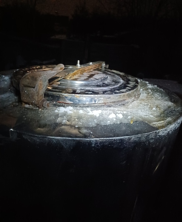

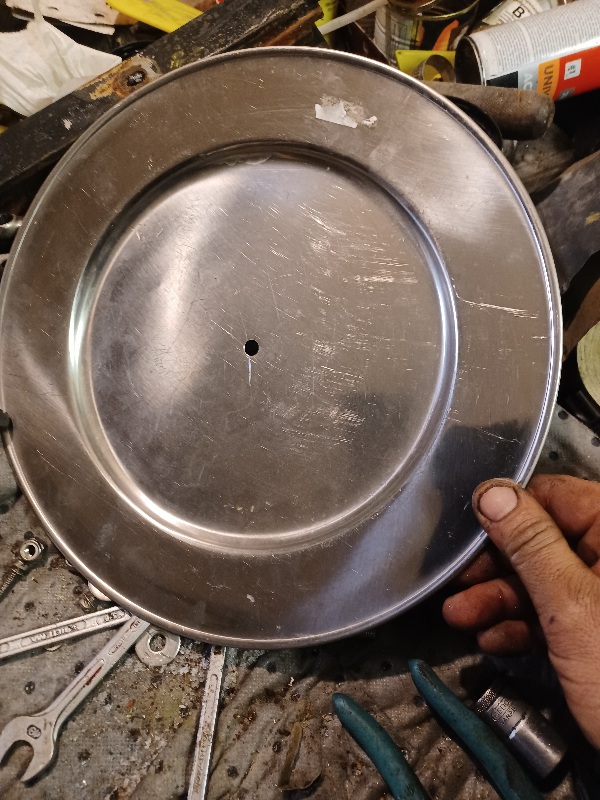

As i rebuilt the hopper lid, i made it flat, because it was cumbersome to shape the stainless dome-shaped as the original lid.
I wasn’t happy with it, it tended to collapse in the middle, and don’t become tight enough, no big problem, but i don’t like the prolonged “smouldering” after shut-down.
When visiting a thrift store it hit me… i bought this stainless serving plate.
Drilled holes for the hinge/spring.
Welding the plate upside-down on top of the lid.
Out in the dark, mounting the lid, much better and even pressure all around the seal now
