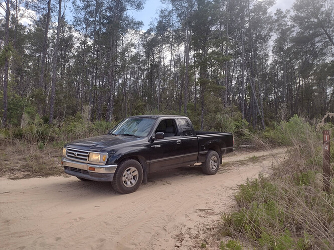

This is it’s good side lol. Most reliable truck I’ve had. 147k miles. And thank you! I’m looking forward to it!
