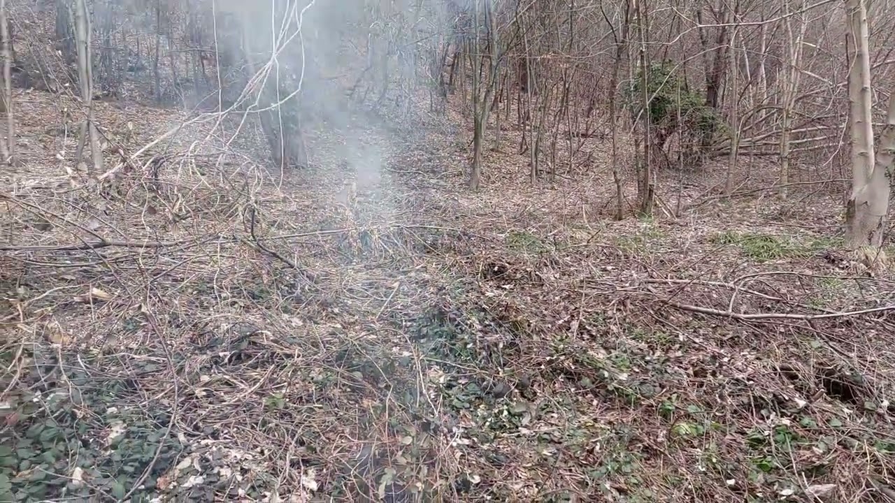

Charcoal from twigs...simple, quick and effective without smoke
inspired from chuck whitlock´s flame cap coal making we tried this system in bath tubs …and it works really very well,

hello kristijan, yes, it goes really fast, for a full bath tub- 200 liters- about 1 our or so, i dont looked on the clock. we made two of the long bath tubs in the morning, and there was a little pile , what not enters more, so i used another bath tub the short sitting bath design, half long as the others…what a difference! with the short tub the air cannot enter so good and it needs much more time for charring as with the long tubs…
procedure: a shovel of glowing charcoal from the kitchen stove in the bath tub…
than always twigs on…
til it is full…
some bigger pieces of the last load i raked beside, because needs more time to finish charring…meanwhile i coverd the redy coal with a layer of ash -5 cm high- for stopping air contact…bevore giving the ash on i pressed the glowing coal a bit with the shovel…
also the ash is pressed a bit with the shovel…
at least i cover the bath tub with a metal sheet against wind and rain…
really impressive that there was nearly no smoke, but this depends also on the twigs…they were from winter cut without leaves…twigs a year old…
