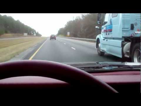

Usualy the 3/4 ton trucks will run 50-60 mph on the road . This is the last gasifier I built . 96 dodge ram 2500 4x4 8L . It seems to do very well at 70 mph on the flat road.

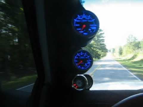

The below is a 360 degree video that Koen made at Argos last year . In the upper left hand you can control the camera to see whatever . I like to watch the smile on Koen face .

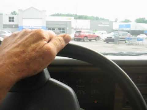

Hello Barry .
You were asking about shutting down so while out running around this morning I videoed a short clip for you .
