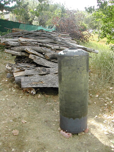

I’m probably dangling by a thread from the bottom of that list. But I have managed to get a 3KW genset running on charcoal.
I used a $20 angle grinder, a $100 welder, and I splurged on an 11lb spool of flux core weld wire for $44. The i960s generator came from Craigslist for $60. Someone gave me an old water heater and bbq grill that I cut up.
So, this is small, but I think it is a beginning.

LOL. That’s just the epoxy coating that was inside the water heater. You can’t burn it with a propane torch. Not bad though. It has kept the steel from rusting. I have thought that maybe I should get some of that and coat high temp things with it. But probably very poisonous. Making a big (50gal) TLUD from the tank. Going to fire it probably tomorrow and see how it works. Chunking all that wood by hand was a bear. I’m beginning to see that a chunker is sort of central to any woodgas system.
