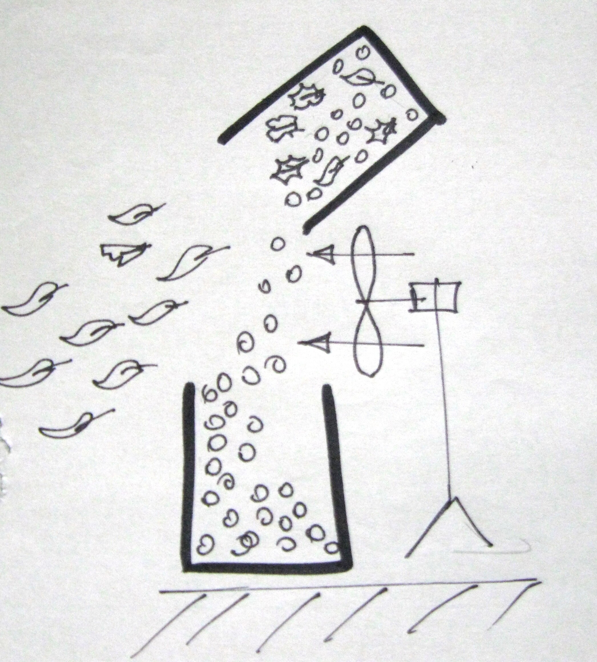

My neighbors rack them out from under the trees. They give it to me in bags mixed with leaves. Then I separate the acorns from the leaves with the the next âvery sophisticated systemâ:
