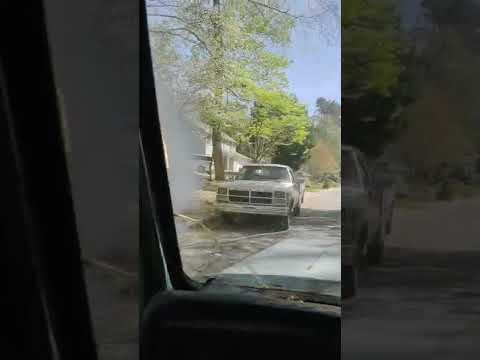

Truck ran on woodgas today. Still letting it setup a good char-bed but it’s looking like tomorrow will be a driving day. Lemons are ready.

The first run earlier today was just a soft drive around the block. Getting the charcoal settled in mostly. Did as many laps as I could and got it up to maybe 40mph. Not pushing it. Had the mixture locked with the adjustment screw and no pull cable just yet. Got a bit excited to drive lol. I could tell it was ok at idle but higher speeds was bogging. So I’ll start on installing my automixer soon. I’ll still have to see if this Peterson style will be a good fit. It should be but I always have a Keith ready to build for it if it’s not producing enough
Sounds good to me! 40mph with a fresh char bed sounds like there’s nowhere to go but up once it’s settled in.
Sounds rowdy! I like it
Thanks for the ride Kyle .
Looks like it is running well
So I clocked 20 miles today and she runs well. Turndown ratio could be better so far but that’s why I have tunable options. If it wasn’t the horrible downpour halfway thru the drive then I could have got another sack of wood worth in. Made a stop at at friend’s house to grace his family and witness a refuel but had to keep moving shortly after due to the fuel getting weak at idle. Still had them giddy with excitement as much as I was. Open highway driving at 50mph is happy. It’s just the stop and go that is touchy right now. So I won’t be going to work in this soon till I get it right. Pic is ten miles into the trip.
