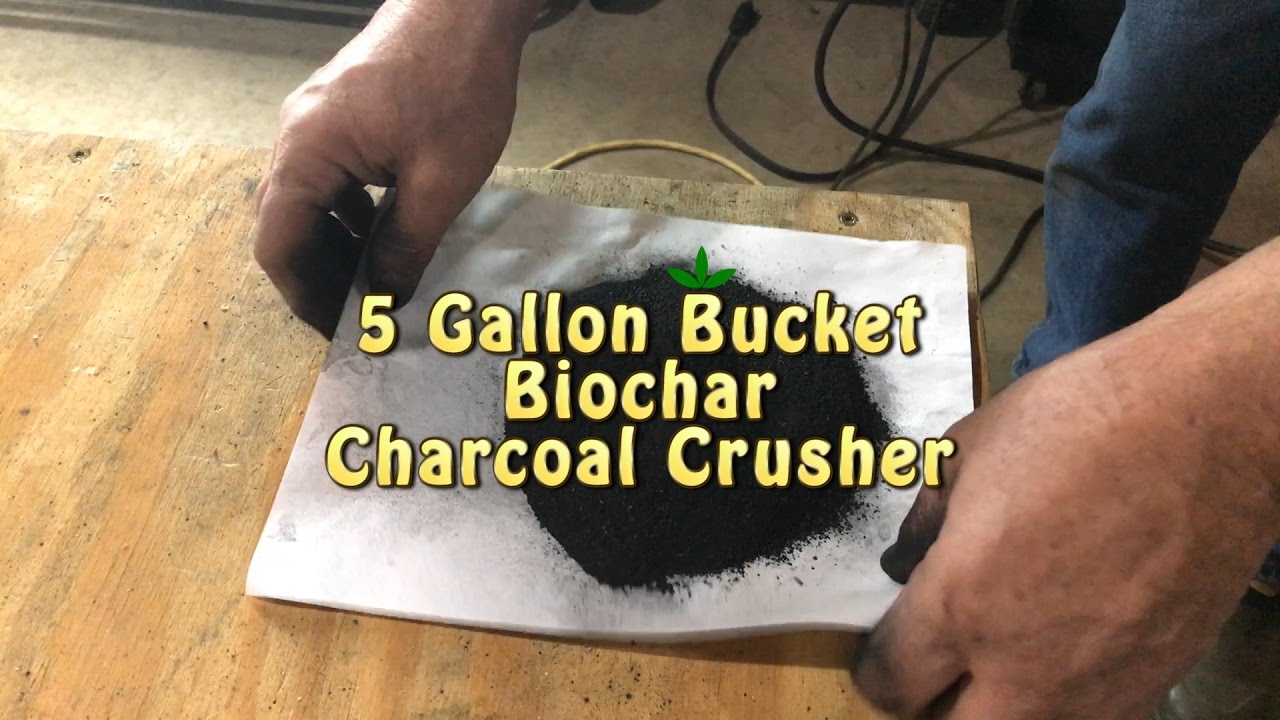

I mounted a 12/24 volt wheel chair motor and gearbox onto the back of my little garden mulcher /shredder and can get the speed right to the point of low dust and those motors have a lotts torque , so just set the belt slightly looser and if you happen to get any unchard brands it will slip the belt and allow you to pull them out if you want .
I was looking at making something like this video, but granted It is dusty, and I don’t know if you can do fuel grade sizes with it. It looks a lot faster then the meat grinder for biochar though. The trommel worked okay but slow with a rock in it, but I totally understand wanting to use something else to break stuff up with first.
The high speed flailing action looks bound to produce a lot of fines.
My thinking is that a mincing action might also give good results, but any slow speed grinding/ breaking action is probably similar.
And then there’s rock crusher designs. Given that they have surfaces that never contact, they probably are the most efficient. And will also deal with stones, nails, no problem.
Hi Garry, just breaking charcoal up in my hands produce char dust. There is no way to crush it to the size needed dry with out making the black dust. Containing it when breaking it up is the best solution that I have found and then using the powder and small fines in the garden or compost pile.
I agree, any process will produce dust.
The only way to figure if one process produces less fines than another is to test side by side, same charcoal. I think there will be some differences, but only a gradation between some dust, and lots.
Soft wood makes more charcoal dust than hard wood Charcoal, and the better quality charcoal makes less dust is what I have noticed. All of it being what I have made. Camp fire charcoal is not as good quality as my retort barrel charcoal.
