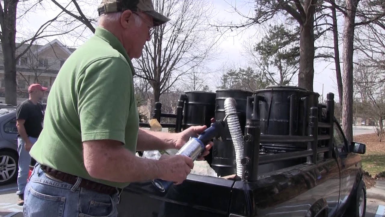

Here are a couple of older posted up video’s showing WayneK talking about his systems.
He traveled ~400+ miles of highways to get from his farm in northern Alabama to this Kansas location.
He used an earlier version of his system to go east coast to west coast and then participate in a use NO Gasoline long rally race.
He did from his larger V-8 engine system once it was V-8 engine warmed up and stabilized; woodgas fuel a smaller portable generator he carried along. The power from that running an electric table saw to cut up road-sides brush woods. And behind stores broken shipping pallet woods.

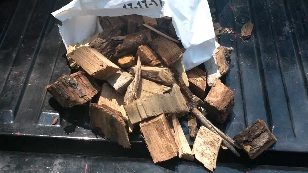

This time focus on the easier to make large wood chunk sizing he shows. (And the many questions asked, he answered on the fly.)
The sad, sad truth found by many of us is the smaller the engine system then making a smaller woodgasifier you must make much smaller wood chunks. Labor intensive unless you make a shearing chunker using sap-down, winter woods; with twigs stripped off branches, and sucker growths.

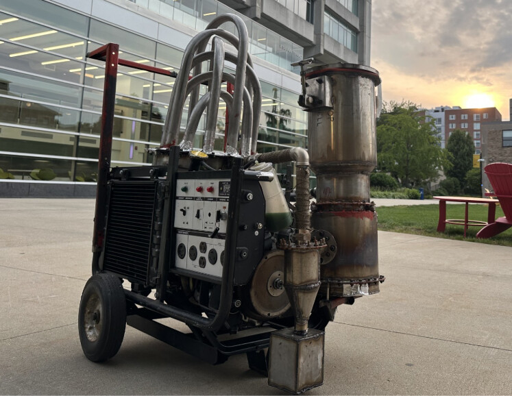

Sure can, my capstone group and I built one for a 359cc,12 hp thats in the the ES6500 generator. it Worked and we fit through every door and elevator. Ran for an hour which was our estimate to run through all the wood. School budget squeezed the quality of the build big time but got it around the 1k mark minus the ES6500, i got that from fb for dirt cheap.
