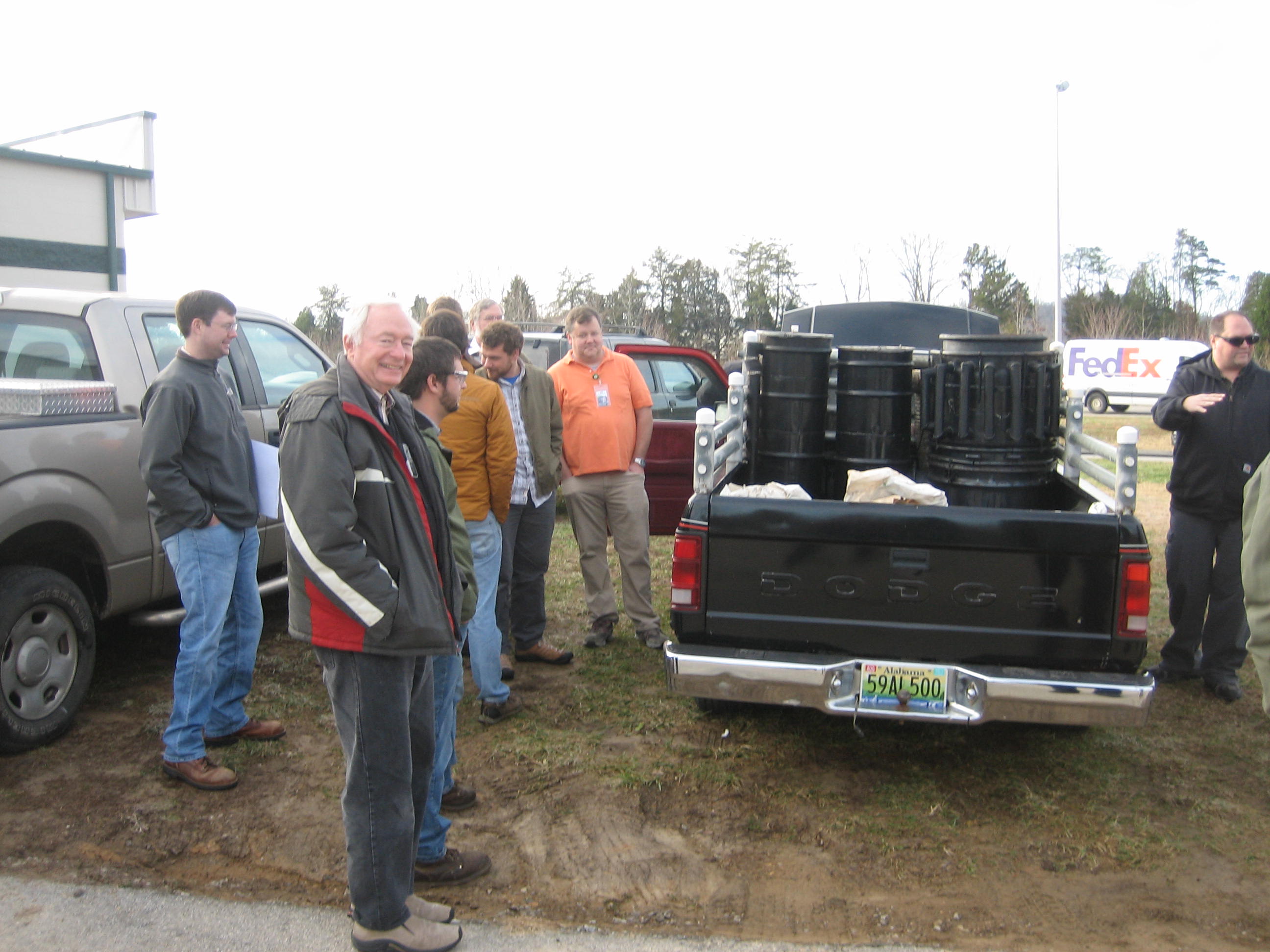

In 2014 I was asked to come up to Oak Ridge Tn to show off my truck and tour the proton power site.
Standing in the foreground in the picture is Sam Weaver the head of proton power. He and a couple of his engineers have seen near 80 mph on woodgas :smiley:
