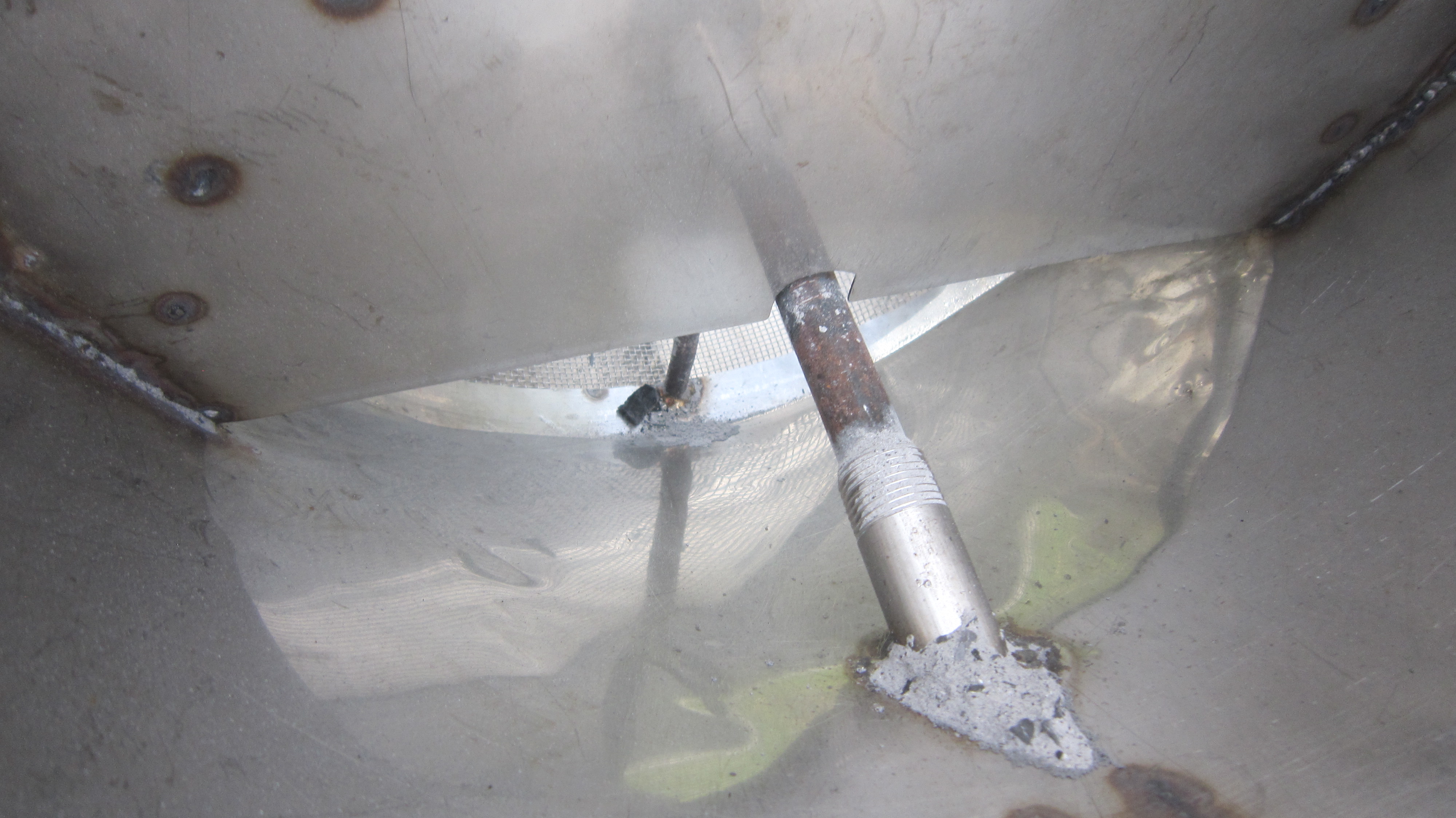

actually 7 bath tubs coaled…yet some work remains…

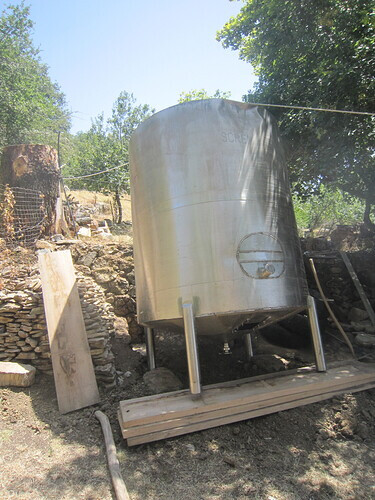

in the backgrond the new coal container…a longer dream comes true, one big container for all the coal instead of here and there a lot of barrels…5000 liters capacity…
Wow, that is a nice and shiny tank. It will be nice to have all the charcoal in one spot but how do you get it out when you need some?
in the bottom is a opening with a sliding door…so no more shuffeling out from barrels…
picture from summer when we lifted the container up
inside in the tank is a sliding sheet , so the coal can be centered over the sliding gate

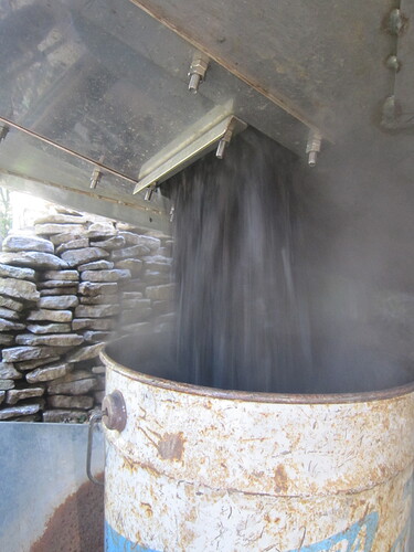

a provisorium is as good as patience reaches…so we modyfird the drum sieve…is very effective now…in the new funnel enters more than a bucket …
sieve cylinder longer and optimal mesh size…
ash collector works nearly automatically
the axle goes through the funnel…
