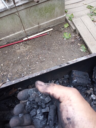

I tried smothering my fire with a lid, water and a blanket:
Crappy charcoal.
Very soft, very oily, lots of wood left uncharred.
These problems are probably due to the feedstock.
It was dry but also rotting,punky and of various sizes.
I was able to crush it with one hand and I needed soap to get it clean.
I guess I will sift this mess, for practice.
In the future I will avoid mixing dimensional lumber and tree trimmings.
There are plenty of pallets in the world, ready to be processed into stringers and deck boards.
Tree debris might be better suited for the wood chipper, or in a hugelmound.
