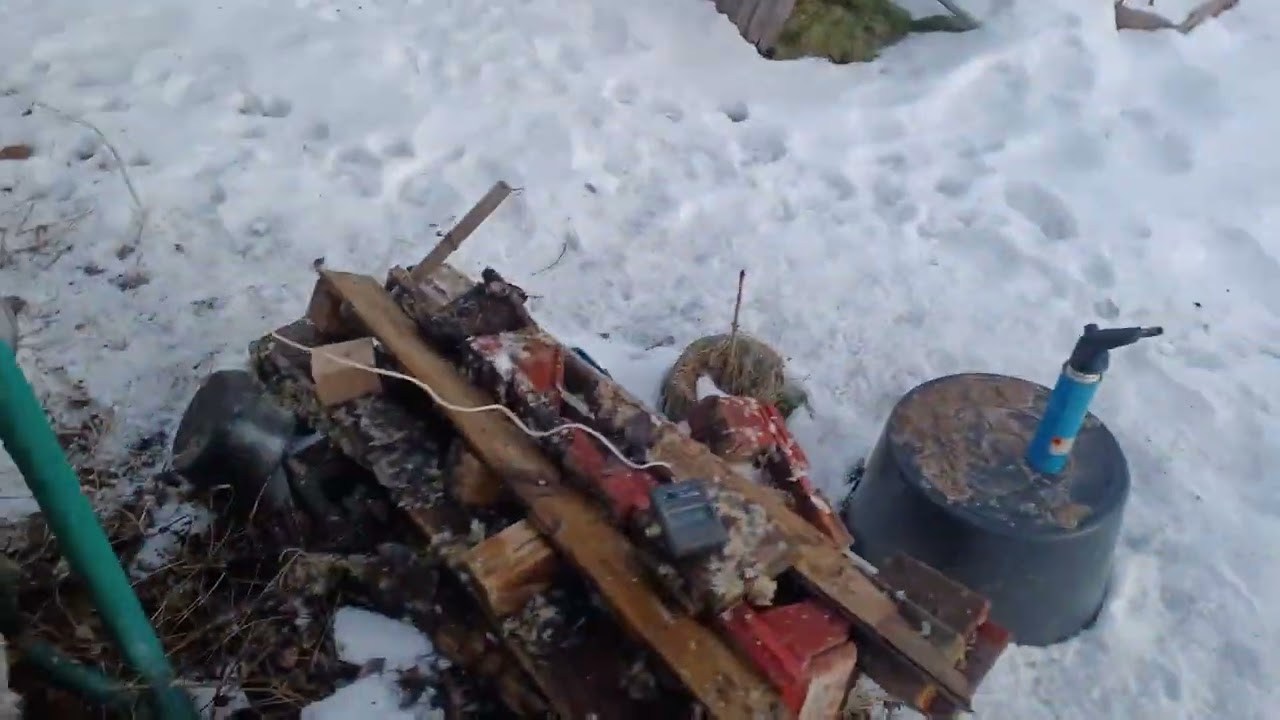

Thought i could post this here too, i made a video of yesterdays charcoal making.
This is my first try to video with my phone in a holder on my hat, so it’s pretty crappy filmed, but with some training maybe…
Nice video Göran, as always. But when summer comes I think you will regret charcoaling your garden furniture.
Haha, no way, those cracked, rickety old chairs was a danger to life to sit on, after endless repairs, i finally lost it, and made them into firewood with some help from a sledge hammer ![]()
If you would have just charred them a bit and tarred them back together. Then they will become odor eater chairs. (sorry I watched the other video and realized people buy those small quantities of charcoal for odor eating among other things.)
Good idea, but those chairs deserved to be totally charred after all times they collapsed under me, or pinched my a**, or nails wandering out to rip clothes…
