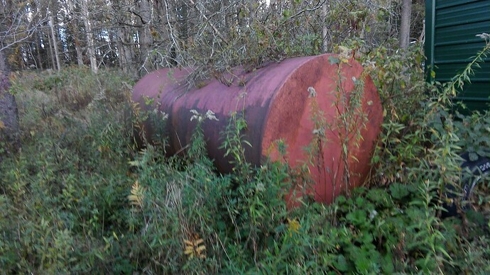

Need to get the Kemp on a trailer and up higher for a screen etc.. Been thinking about building a trailer and all the material it would suck up. Well now, I was mowing to day and in the weeds I found an old auction score… :smiling_face:
Was thinking about using the tank to store hot heating water some day but now I’m thinking charcoal silo.. It’s fiber glass.

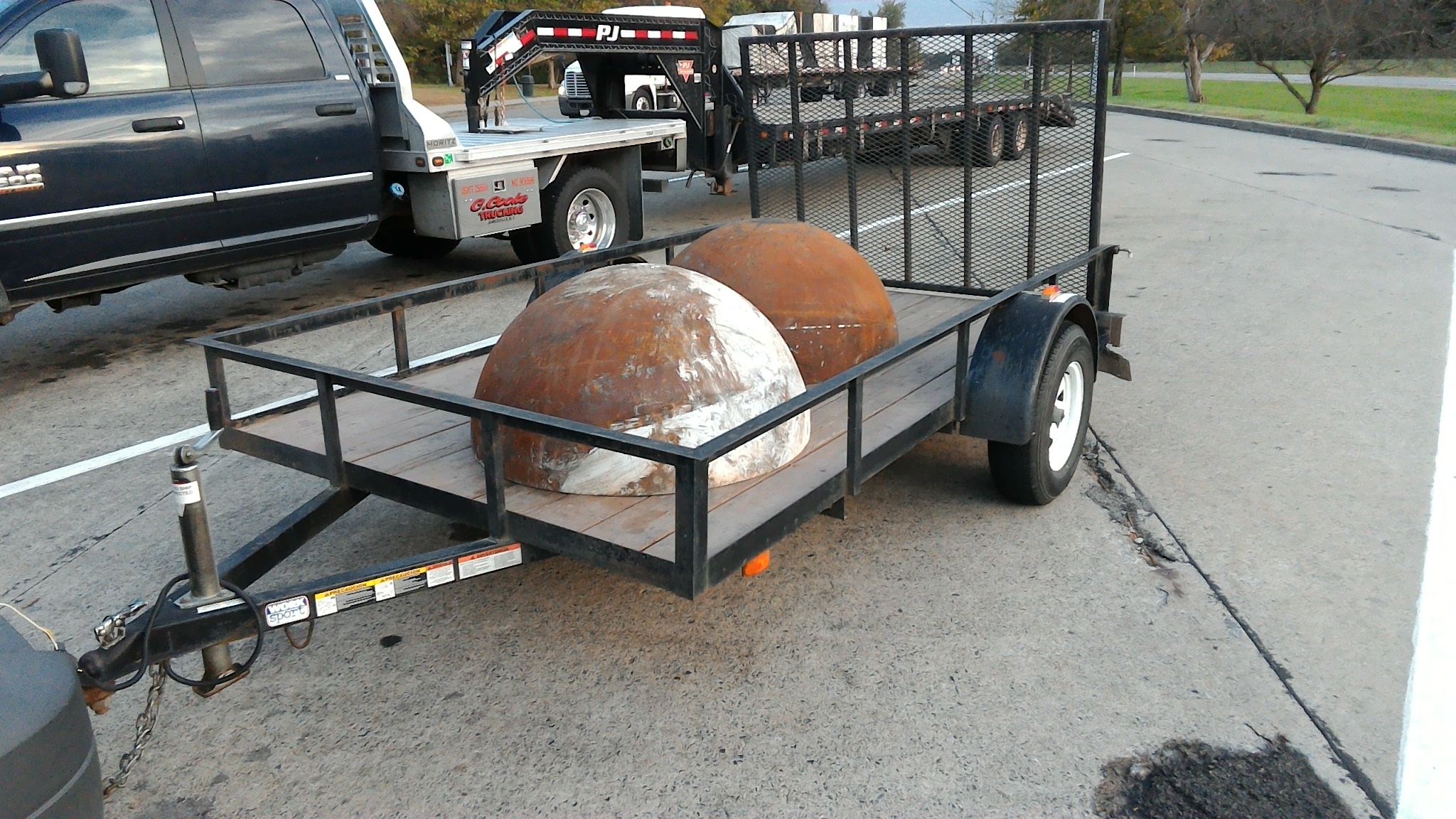

Went for a drive after work and to my surprise something followed me home.
Looks like the end caps of a home heating propane tank. :smirk:
They will probably work good as cone kilns. surround with a sheet metal skirt air space at bottom like the Kon tiki.
Hi Mike and Bruce,
I was thinking propane tank also but no. Something from a mill. I think steel mill. Something is delivered to the “mill” inside of some kind of container. And these things are part of the container. These two are 40 inches in diameter. Hope it is not radioactive! :open_mouth:
Always wanted a cone kiln so I hope this shape will work. I would like to make a continuous version. I also have a 2000 gallon tank that I could stand on end, cut a door in and have the cone inside a fire proof housing. :relaxed:

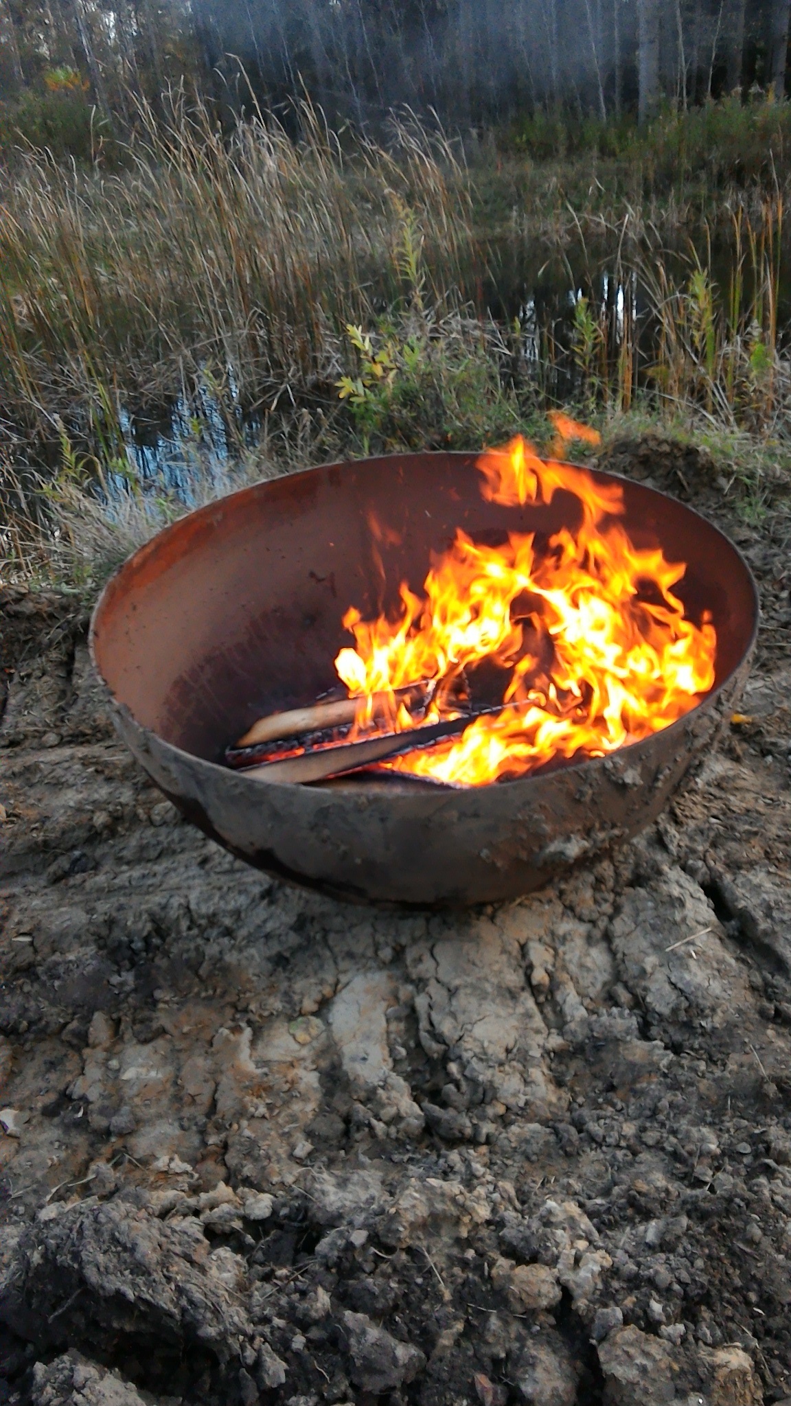

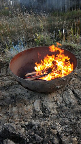

Had some time to give it a try. Well almost, I was doing about three other things at the same time so could not devote the quality time it deserves.
Need to work on my start up skills but I honestly believe that this is a keeper! I think this will obsolete the barrel system for me.

For startup it is recommended to build a small “log cabin” stack to get things going. That works good for starting the fire down in the bottom of my curtain kiln barrel.
Yes, air tight for cooling.
For the above first run I used a shovel to scoop out the red hot char and into an air tight 55 gallon drum. After every third scoop I stuck the end of the shovel In to the pond water to keep from damaging the wood handle.
