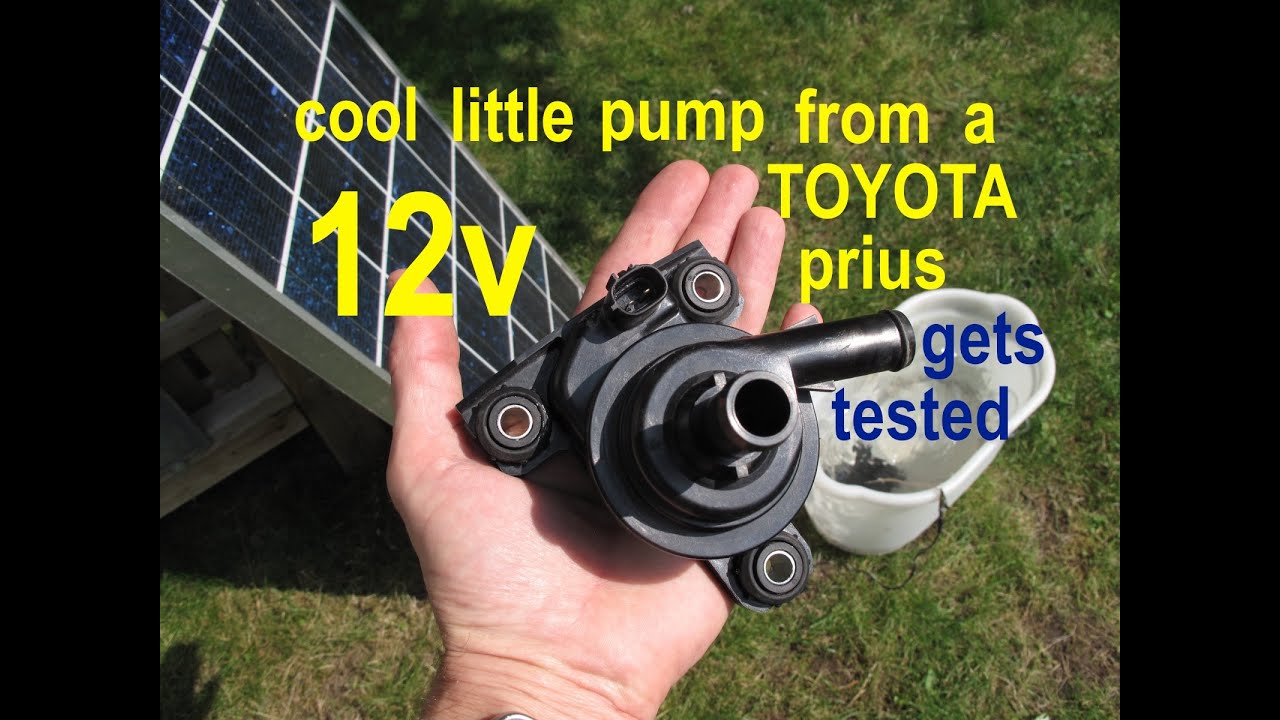

Has anyone got an idea where to get a 12V dc water pump? The aquarium shop hasnt got anything of interest…

For the water pump I’ve seen auxiliary pumps in cooling systems on foreign cars (I’m in the US) for a long time. Some BMW, Audi, VW and Mercedes that I’ve seen in the junkyards have had these. Not sure how much flow they would have on their own though.
http://www.ebay.com/itm/VW-Volkswagen-Golf-Audi-TT-Electric-Water-Pump-Engine-Auxiliary-Water-Pump-New-/231734482195?hash=item35f4739513:g:ebMAAOxyni9TCL5H&vxp=mtr
Ran across this video today and thought of your quest for a pump.
Neat video Andy!!
