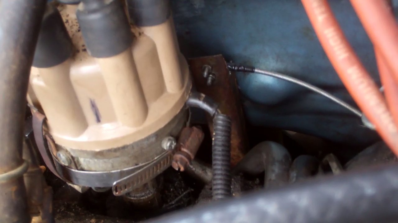

Most of us have adjustable timing from the drivers seat. Just loosen the distributor and attach a cable to it. For gasoline, timing down. For charcoal, timing up about 20 degrees.
Ok i had no clue thats eaven possible! How exactly do you do that? Can this be done with every type of distributor? My distributor looks like this:<img src="//dow.nyc3.digitaloceanspaces.com/original/2X/1/1c70c8dc1f78f6632219c10fcc00f1e4de27fb87.png" width=“666” height=“500”
Kristijant My guess would be you might have to cut the ears off where the hold down bolts go and just screw a bolt into that hole in the block. Have an oversized washer on the bolt so the edge of the washer will catch that ledge and hold the distributor down. The bolt would not be down tight, just enough to hold the distributor in place but allow it to be rotated.

Like Tom said, you need to keep the distributor from falling out but still able to rotate with some friction.
To make it rotate, use a large hose clamp to attach a tab on the side, then the cable goes through a hole in your tab. The cable sheath is held by a clamp on a non-rotating part.
Something like this:
Well that sounds like a plan :wink: Just how much power does the 20* timing advance give you?
