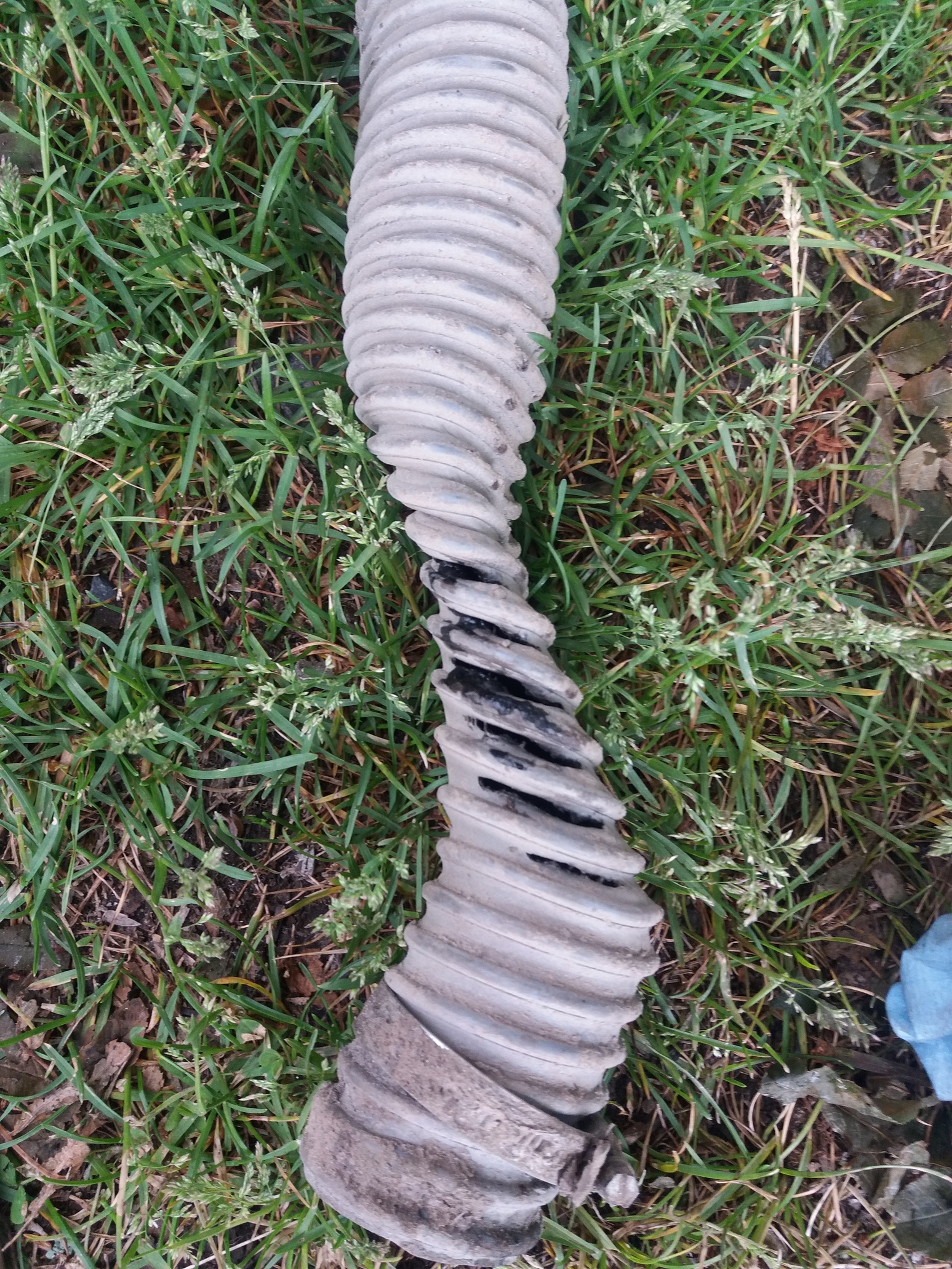

I wonder if this is the fault that the car has been so weak the last few times?

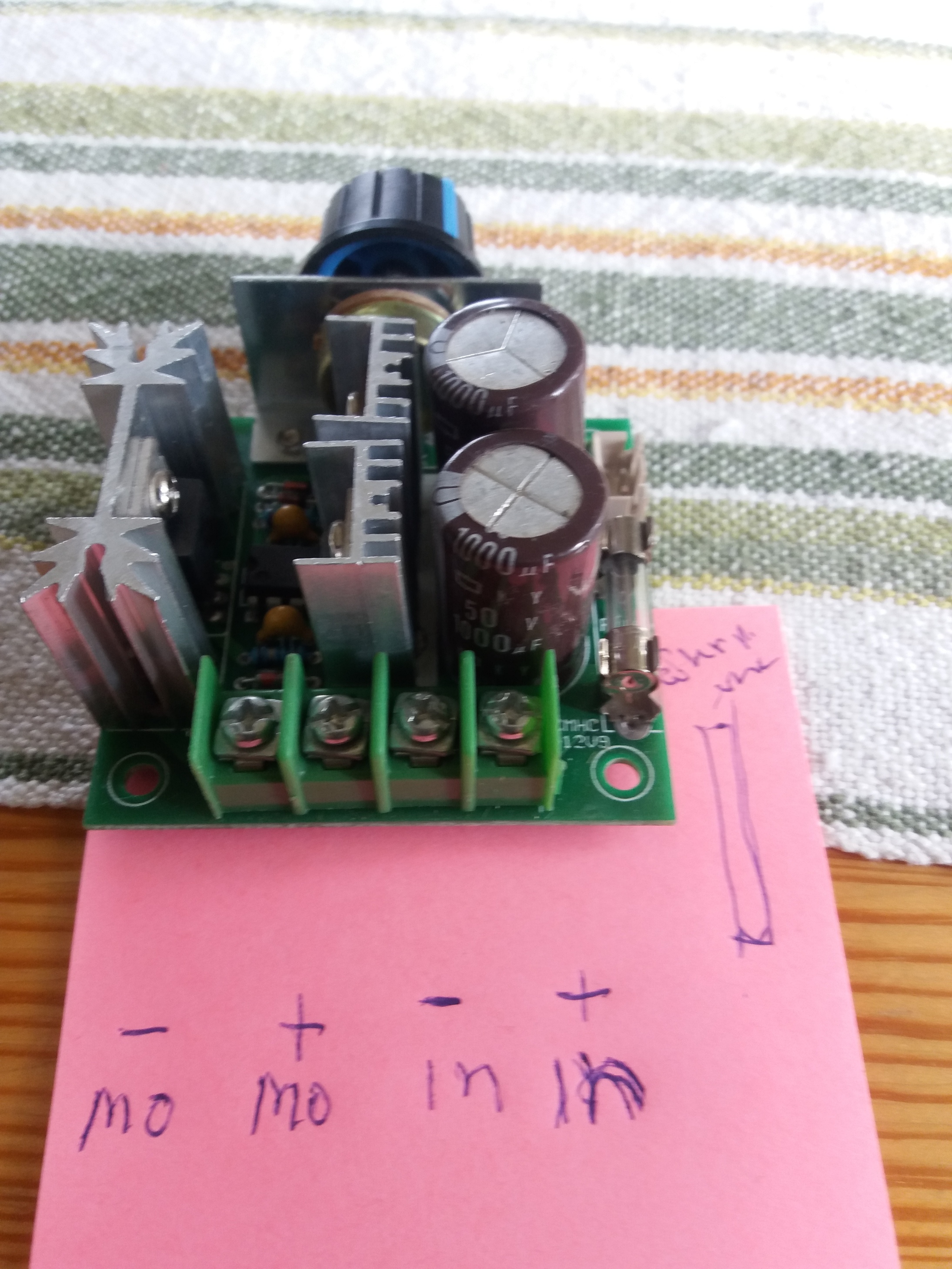

Can I connect the earth together on this and have incoming on + and other end out to motor on M +?
Yes, the flat hose could be the reason.

Yes, they will be connected via the chassis anyway.

The black stripes on the hose are holes, strange that the car worked.
Ha, most leaks can be compensated for with the air mixing valve
Do any of you have a link to a pwm or rheostat that I can use to control the gasoline pump?
They are all over Ebay
how about a link, all I can find is 4 terminal ones.
Wayne is using a dimmer rheostat for dashboard  instrument lights. Itâs a little weak and will probably fry if used too much. I wonder how a fan speed control from a junked out car would work?
At one point I was even tempted to experiment with a set of parallell bulbs in series with the pump but I never got to it.
Another option would be to try alter the voltage coming from the tps. To spoof the computer to think you using less throttle should be possible.
Ha, l did just that on my Seat
 later l winded thin wire around a thick metal pipe to serve as a heat sink. That simple sturdy resistor worked wery well and is simple to make and adjust (by the number of winds)
All I have ever used is the four leg ones.

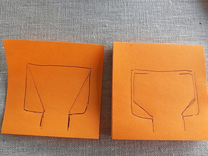

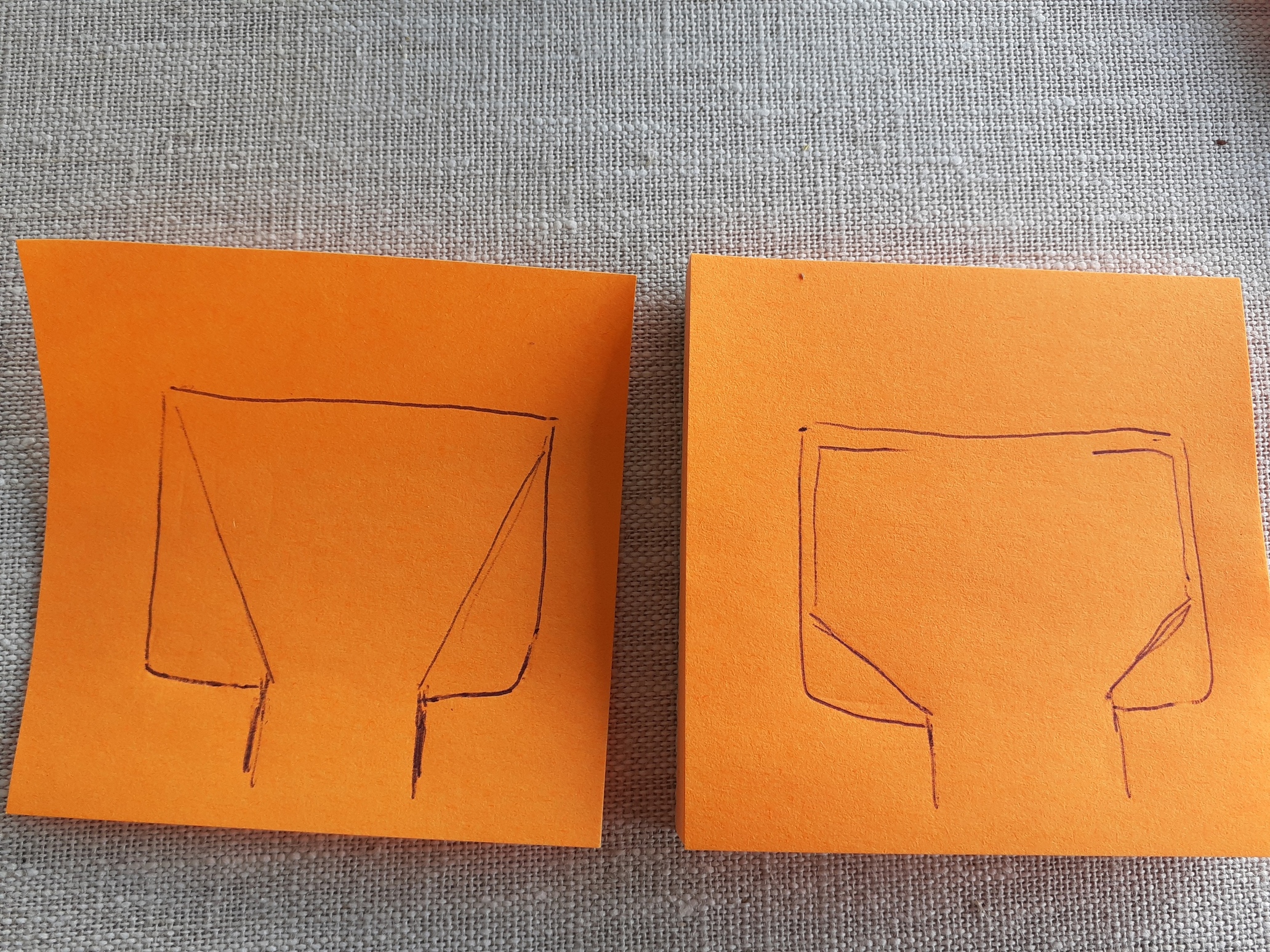

Personally I would try experiment with the shape of the funnel. Your high cone, reaching the entire hight of the hopper, could maybe be one reason for bridging. From what I understand thatâs pretty much the only difference between our hoppers.
I donât think it brews so much with this wood, but donât you think I make over with a lot of wood?
