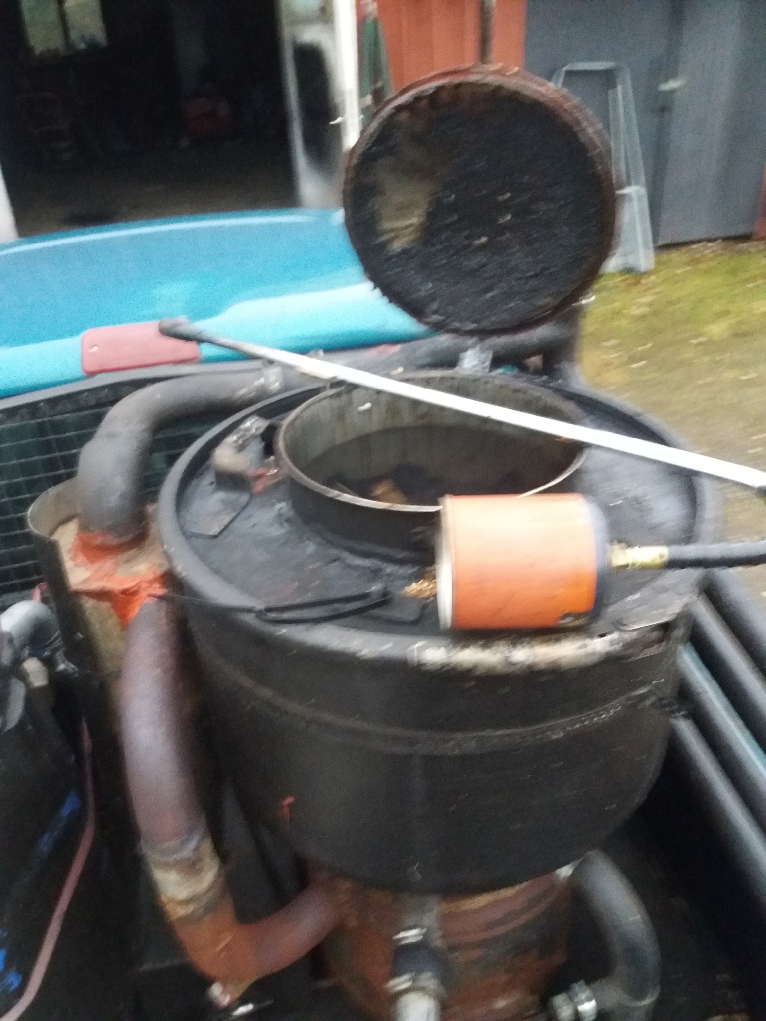

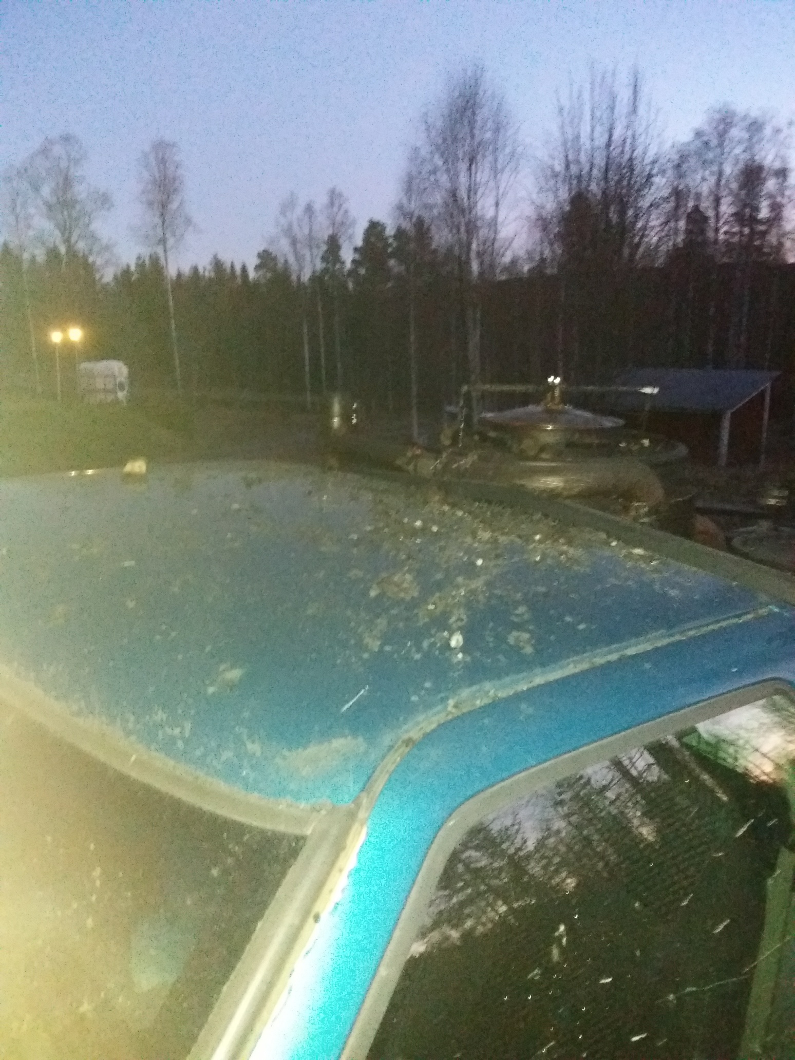

I started the fan this morning but did not put it on the pipe, but lit the boiler with LPG, and there was an explosion, so coal and wood spread over the ground in front of the garage, the entire roof and the bed of the car.
Got to go on petrol today.![]()
Jan, wow. Everybody OK?
That is not supposed to happen.
“This is not the day I had anticipated”
Det här är inte den typ av dag som vi hade förväntat oss
Woodgas power! A/F-ratio just right
Happens 1 of a 1,000 times if you’re not following your daily routine.
Is that the restriction blown away and landed on top of the wood? Must have been a powerful puff
It went well thanks to the lighter having so far tubes (weed burner).
Yes, it is restriction that is on top of the wood that remained, had wood all the way down to the grate, when I cleaned it last night.
Could have been me… I do the same typical things… Glad no one got hurt. Big blast it was!

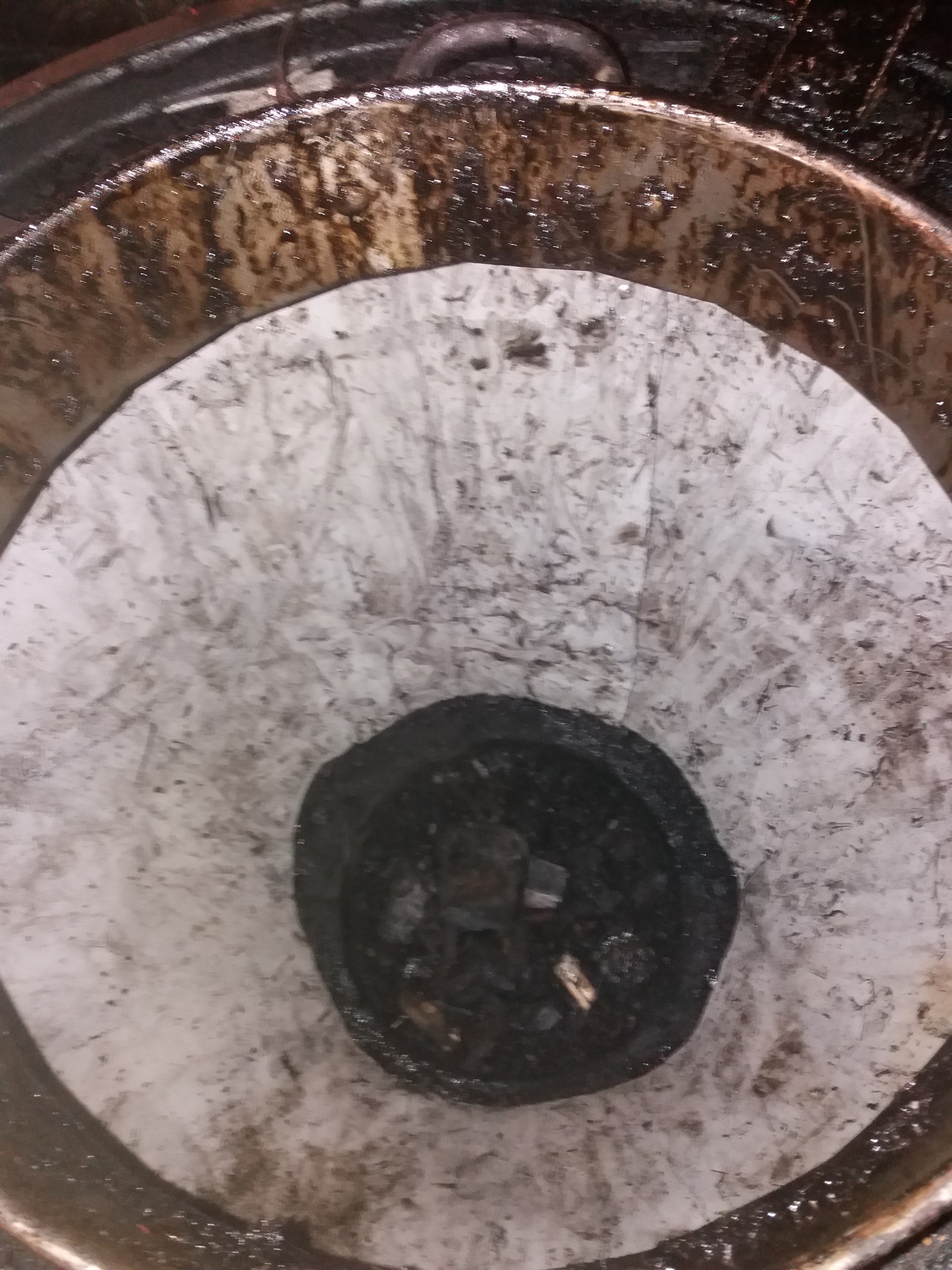

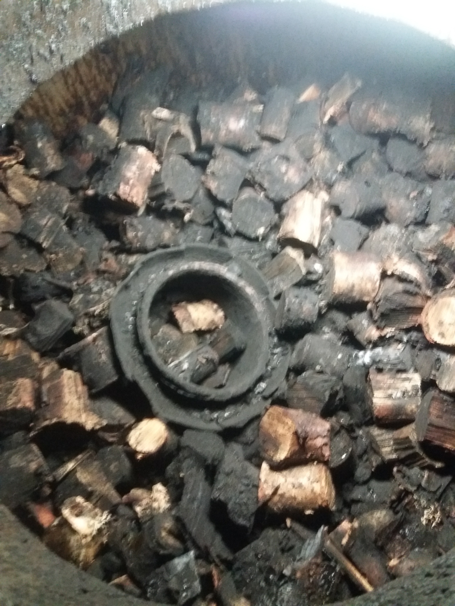

Tried yesterday to make a cone of more than 60 degrees to the unit yesterday, to avoid hanging.

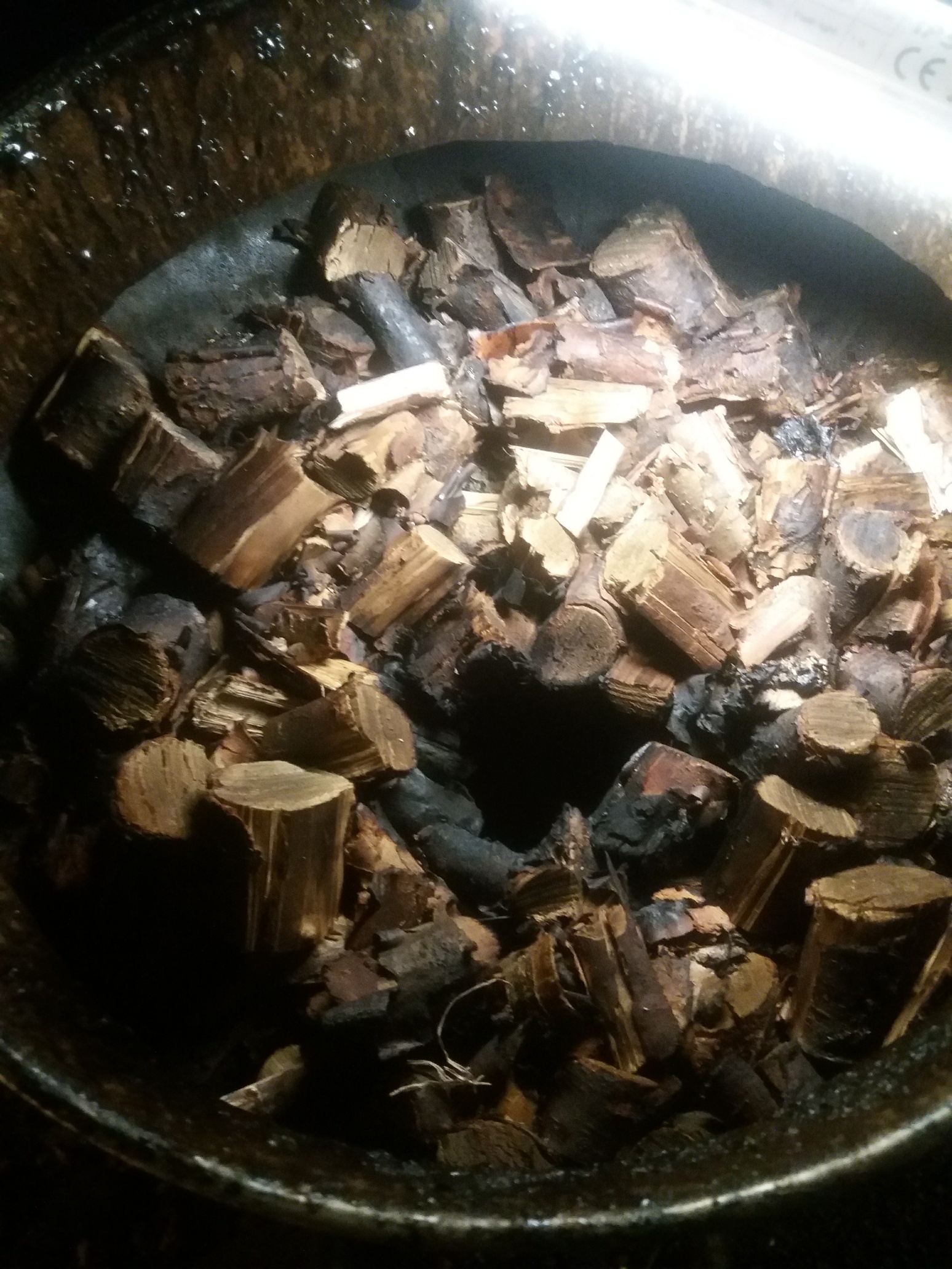

Tested today and it turned out worse than usual, what is it that makes the wood hang so easily?
Hi Jan, this a easy one to answer. Sticky Wood Tar in the hopper. I have had wood stuck on the straight vertical walls of my hopper when it cooled down. So here is the secret if my hopper gets to 200 degrees F. / 93.3 Celsius the wood seems to slide into the fire tube. Also try cutting your wood a little smaller might help if you can. I have a 12" opening where yours is smaller. One other thing you might try is to put a light coat of oil on your new cone. Used motor oil will work and see if this will help.
Jan, in the second picture it looks like the wood is locking up against each other like what happens in wood bridging over the fire tube. Try making your pieces smaller. Maybe half the size.

I think I understand what you mean Max, but I’m hesitant about the result.
I would probably need a reverse cone to be sure.
The problem is probably that the wood that I have run through my woodcut was a bit dry, which causes the wood to break into smaller pieces.
Joni had an idea to raise the nozzles, but I do not understand how this would work.

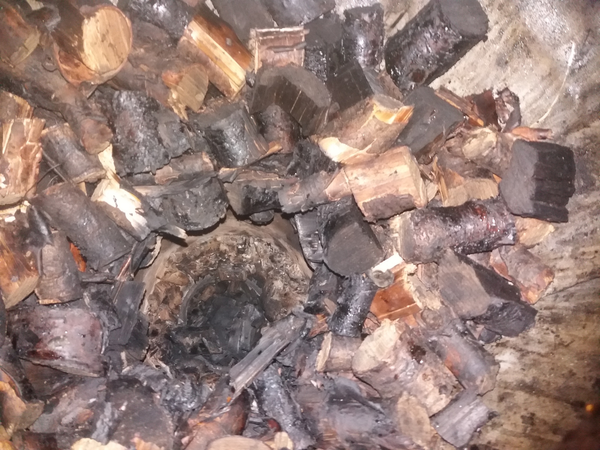

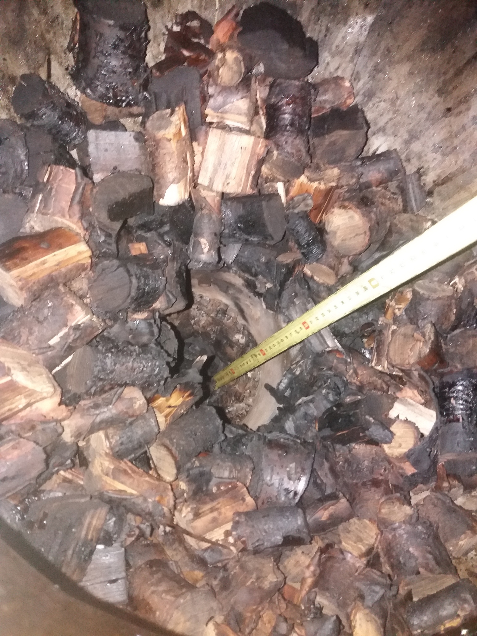

I tried again yesterday with the cone, could go about 5-6 miles, then the temperature rose sharply in the wood container and the car stopped, when I would then go home it only went on 4-5 cylinders for a while, not good.
This is what it looked like last night when I got home.
