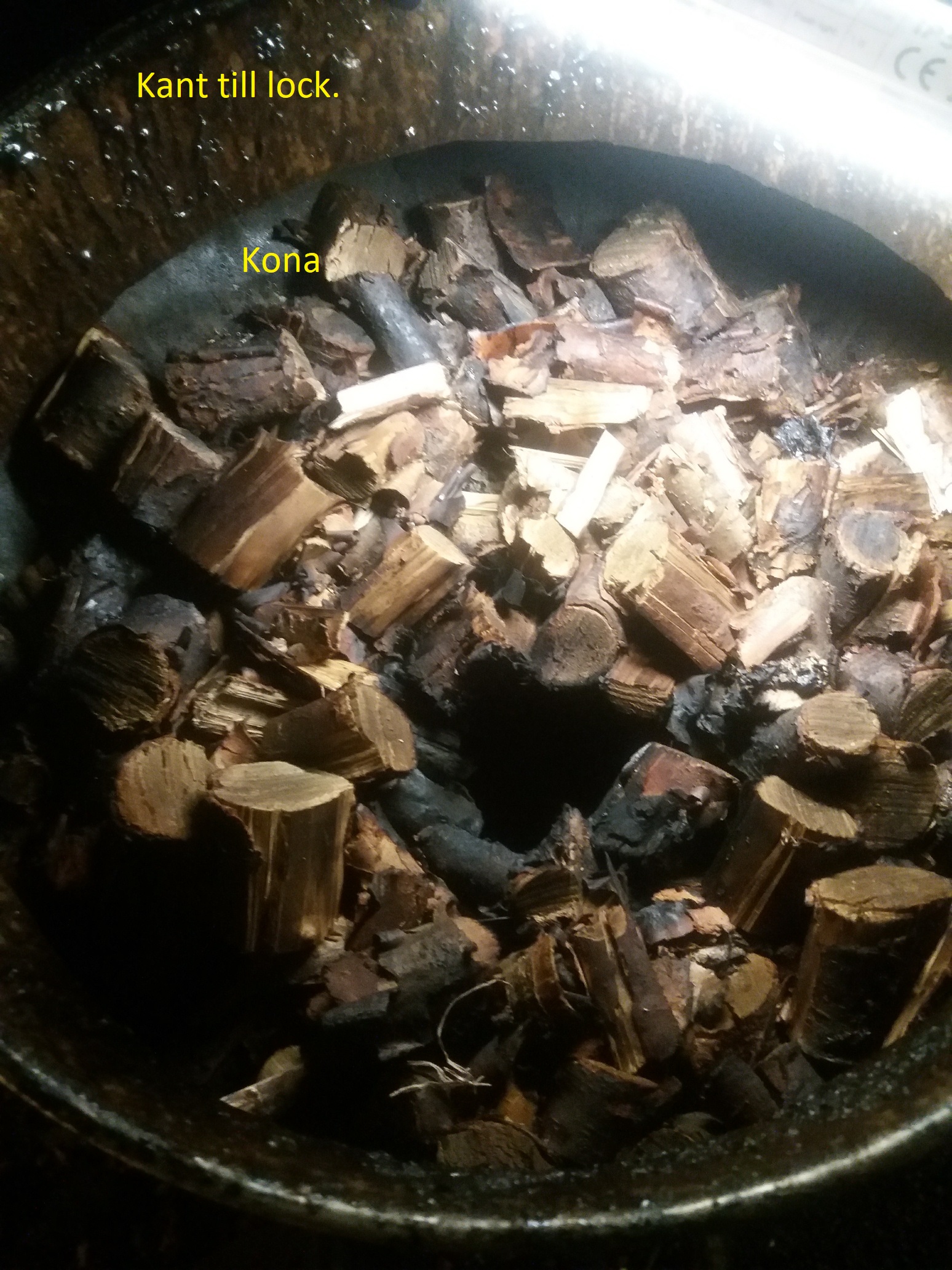

Is this picture showing the upper end of the funnel?
The idea with the 1/3 circle steps (staircase) is to “uphold” part of the wood pillar and thereby introduce an unsymmetric avalanche, which would not “reconstruct” a stable “plugg”.
The loose fuel would hopefully creep down the funnel…
Max
OK, but it works better without the cone, so if I reduce the volume more, I think it can be worse than then.
Kanten iill locket = The edge of the lid

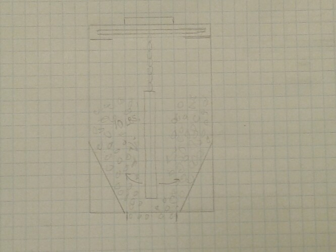

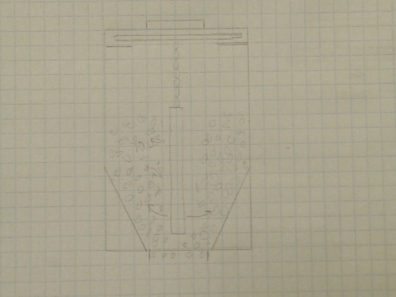

Hi Jan, here is a idea I never had to use once I figure out the right fuel sizing for my hopper and fire tube opening. My wood is really fractured and is in many different sizes, as big has my fist and as small as my fingers.
I call it the gong on a chain, when you drive down the road that 10 lbs. Bar is going to move if you give it some space. Especially if you start from a stop, turn a corner or step on your brakes. Weight and momentum changing directions.

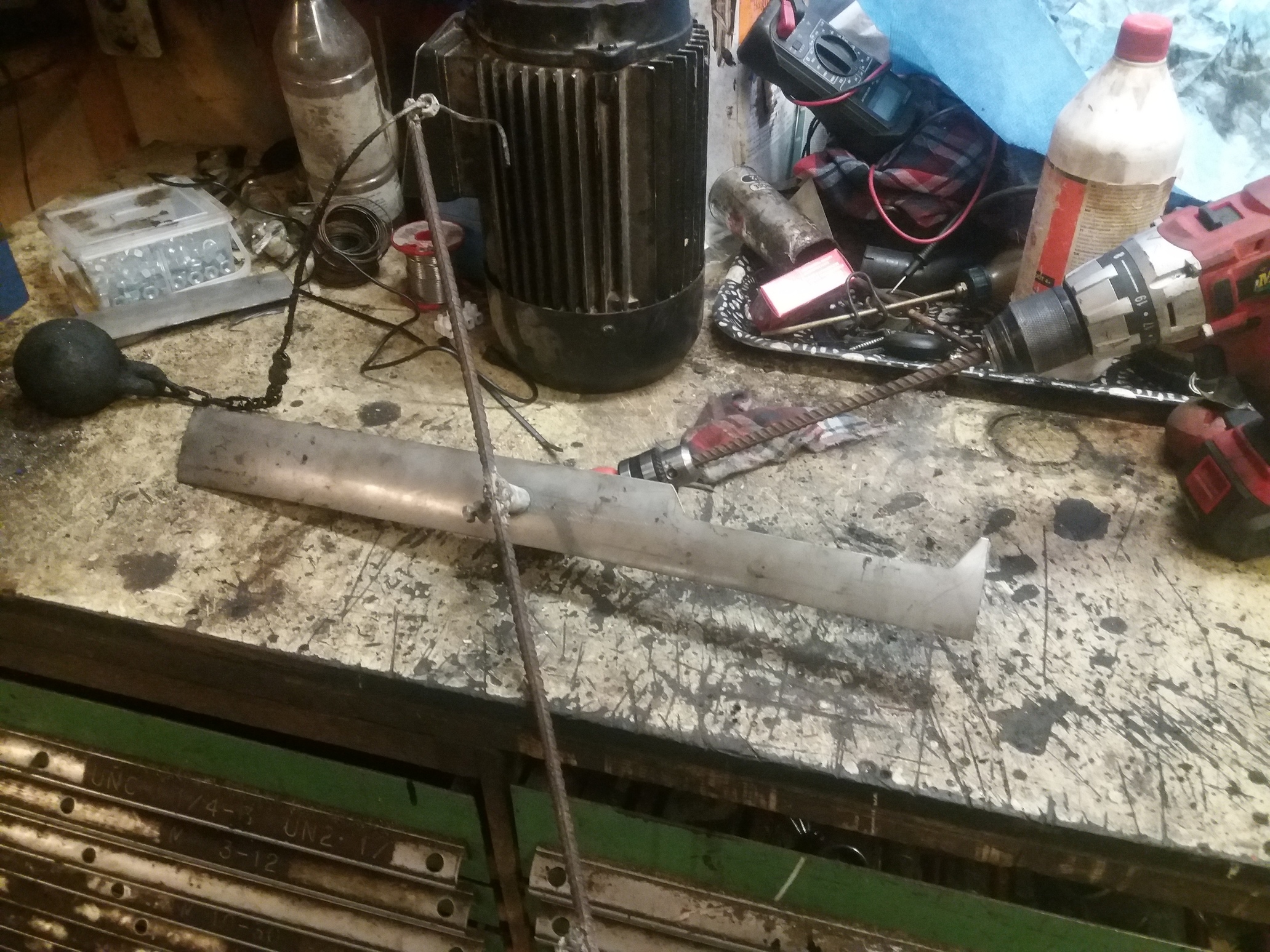

Max, I’m a little lazy, so I have to believe in what I do.
I have tested with a chain and a soot ball, without any better results.
The bridge starts 20-30 cm above the nozzles, and the nozzles only protrude 15-20 mm.

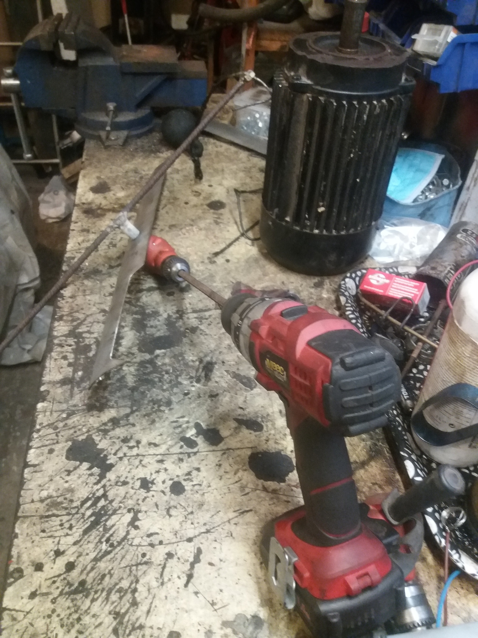

Thinking of something like this, I screw the stainless steel plate under the lid and put a motor outside, driving the rebar with the help of an angle gear.
Tried with screwdrivers, it was too weak at low revs, an elevator motor to the window of a car, would it work?

Hi Jan, the heavy bar will make more contact to thr wood in the hopper than a ball. May be @Wayne Wayne might have a answer.
The ball weighs 1.5 kilos. (3.3069 Pounds)
Hi Jan, 10 pounds is a lot more energy to bang into the wood with.
