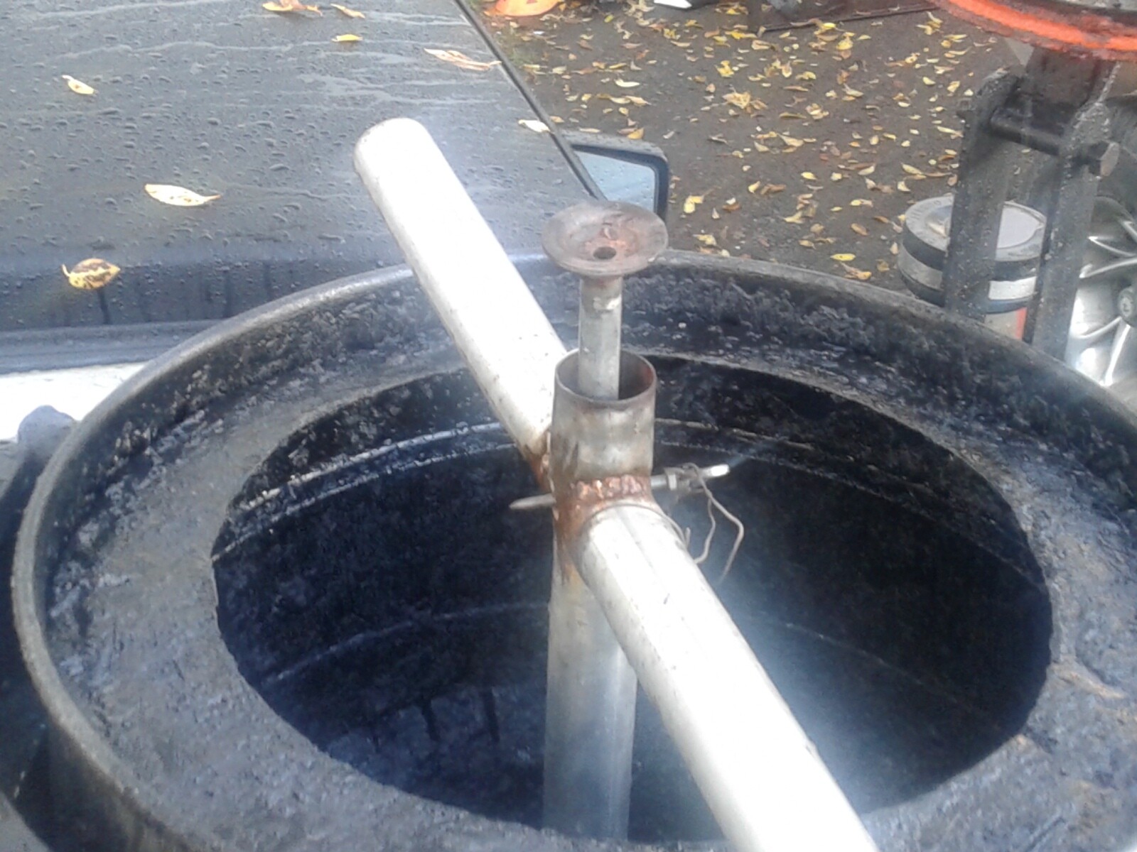

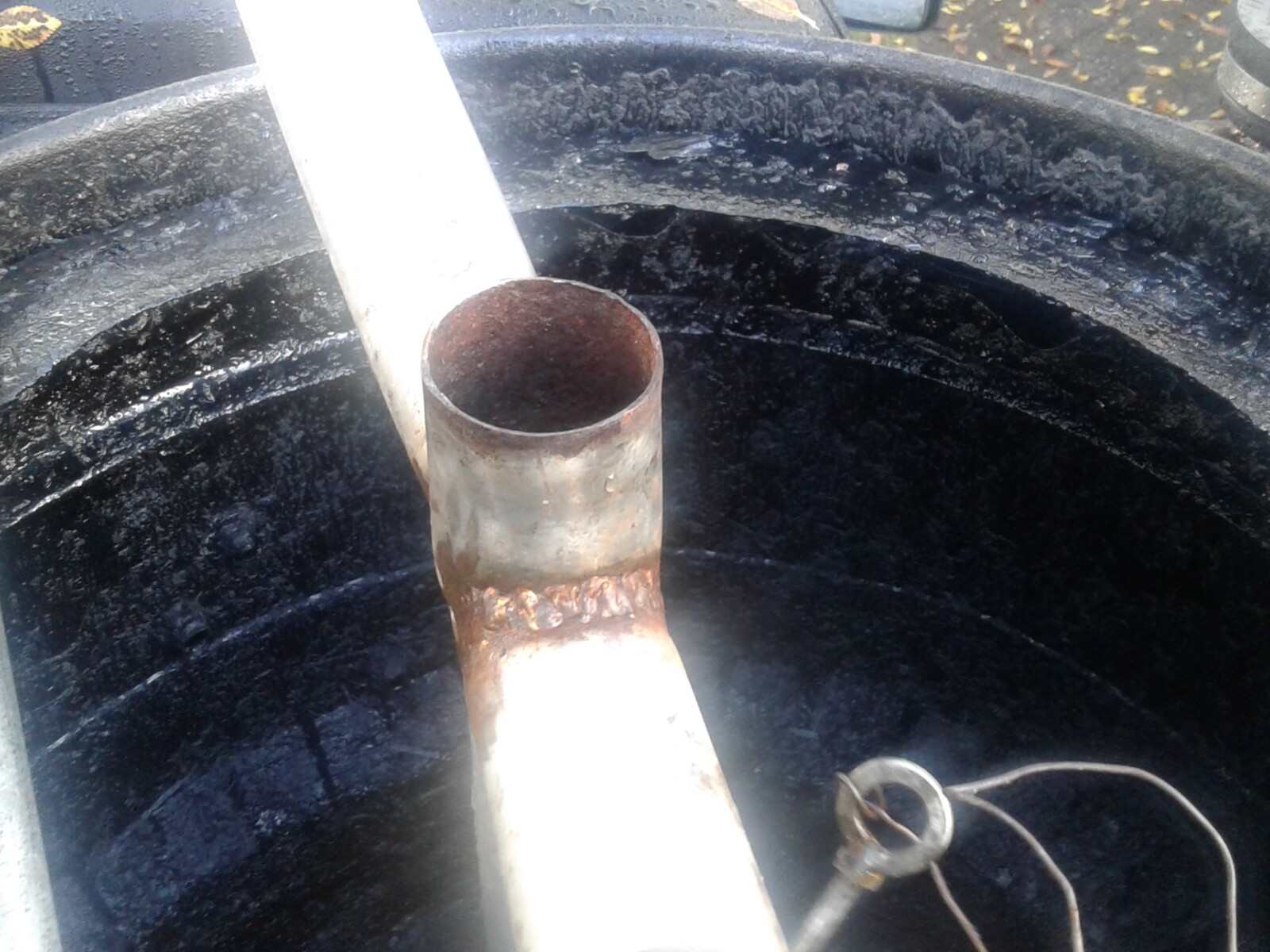

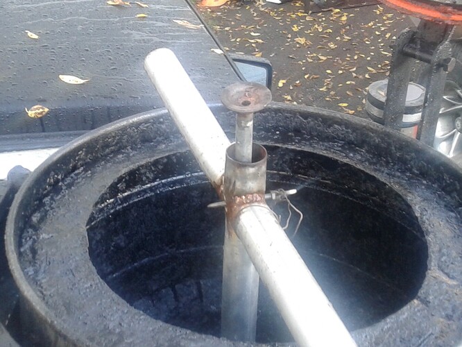

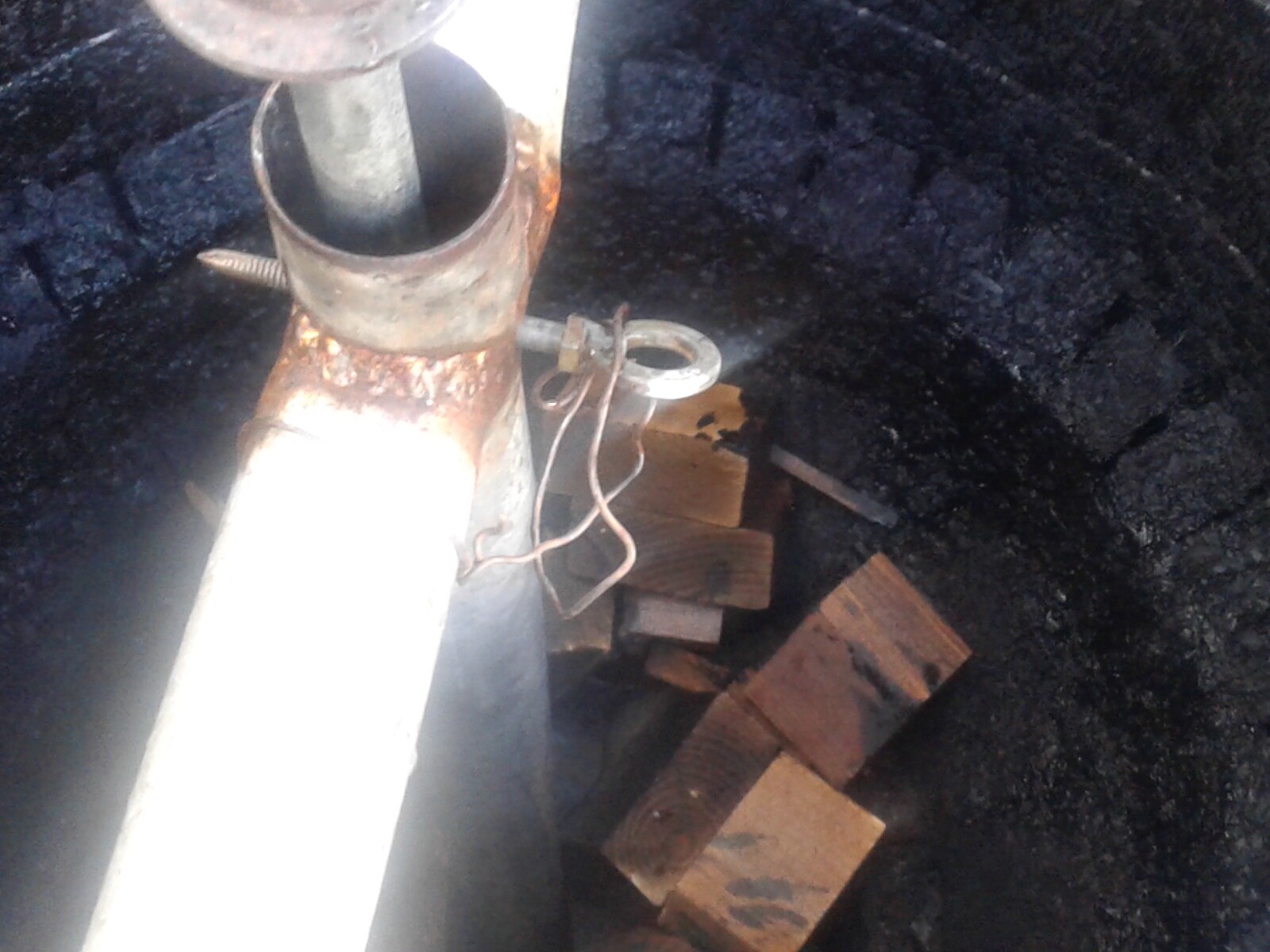

Hi Jan, when my hopper is that full I work a 2" or 5.0 cm pipe down to the nozzle area then drop pieces of charcoal that has been lighted with torch. This works great or me. It is part of my grate shaker tool that I use if I have too shake a tight charcoal bed.
My hopper was not full but you can see that the tool is all the way down to the grate for easy lighting of the charcoal and where I want it to light.
I place charcoal in the tube the pin holds it, and I light it with the torch and pull the pin. The hot charcoal drops to just above the gate for a fast light up making good gases to start on right away.
I take the grate shaker out right a way it will get hot fast down there.
Hope this tip is helpfull for you when you have a full hopper. I like you long torch tip for lighting up not sure if it reaches down to your nozzles but it is a great idea. A lot better than my short tip torch that I have to turn upside down and place all the way into my hopper. It looks to be a much safer way to light up the gasifer. I like it very much no reaching into the hopper to light it up.

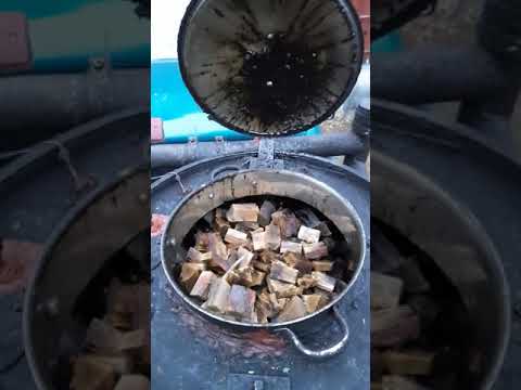

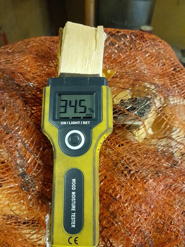

I tried to drive on a little wetter wood today, but it made no difference, it does about 100 kmh, but goes down to 70 kmh on the slopes.
I try to find what happened when it accelerated so well a couple of days but do not succeed, have cleaned the ash door, the whole unit, the filter and now tested wood, without results.

No wind, 2 mornings in a row after lowering the restriction 1 "approx, and went back to 120mm restriction, on the advice of Johan Hedenberg, the car accelerated as with petrol.
What I know I had done, was to remove the charcoal down to the restriction and clean it, and that I ran on 1 bag of pine and the next bag of birch, a little wet.
JO, the heat went up when I put back 120mm, but am not sure if it is restriction or if it is the thermometer.
