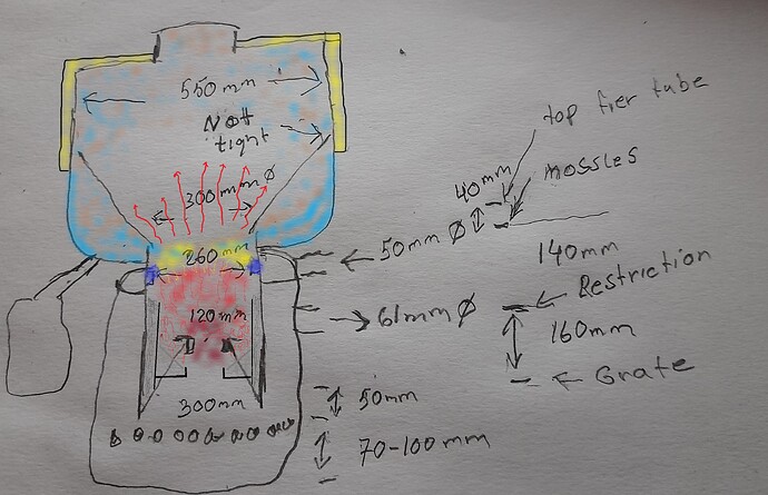

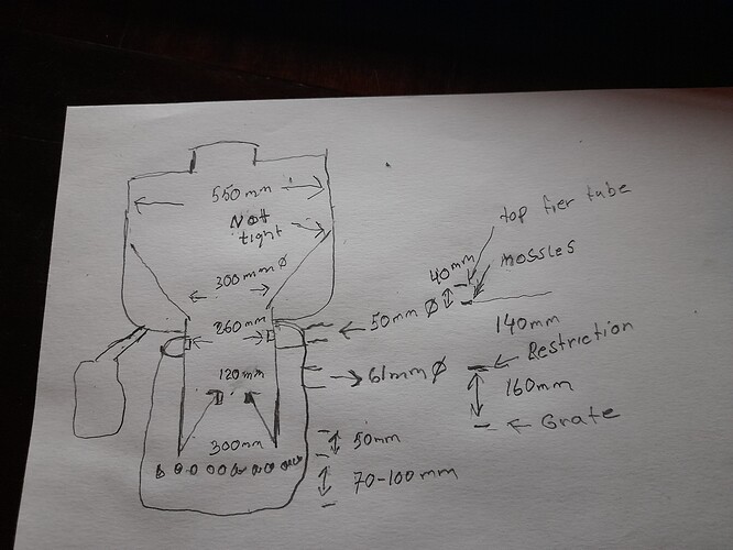

Jan, can you post a skizz of your current gasifiee with crude measurments?

Jan, it seems on the first glance your sizing is spot on. Calculation comfirms this. Your oxidation zone is 4.15l wich is preety damn close to bullseye. Same with the reduction zone.
Can you lower the grate on the existing system? You can try that, but this does smell like a hot leak…

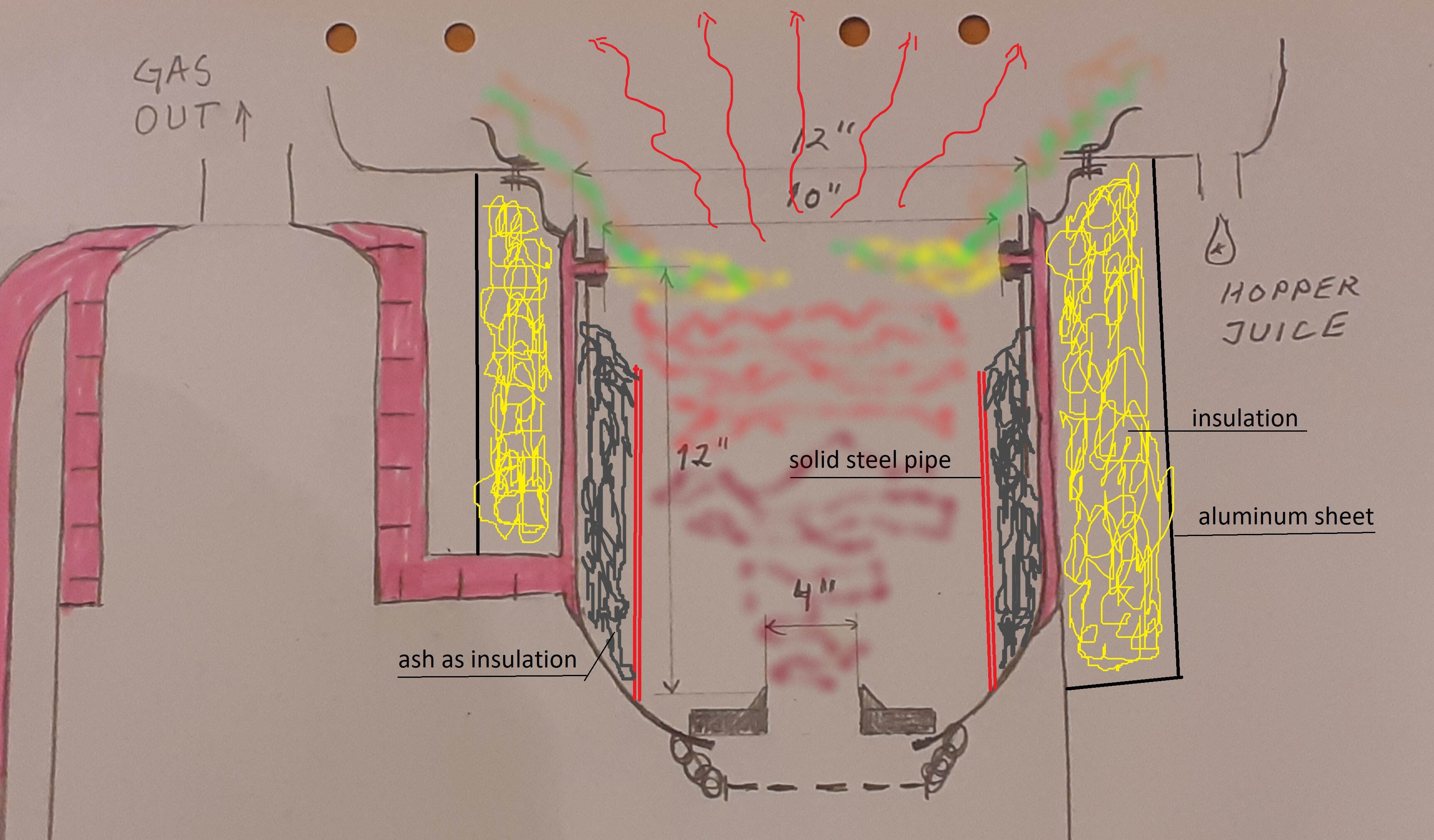

Here I have drawn my thoughts on the flow of gases. Water vapor does condense in the housing, but only a part, there is still a lot of steam in natural gas, which is good, according to the current understanding of the process
maybe another stupid thought Jan, if the top part is not covered with insulation, less water would be extracted, but the pyrolysis temperature would rise, more gases would be produced, which would improve the reduction process and overheating.

Jo and Jan , that’s how I imagine a gasifier rebuild , insulated top , to maintain higher temperature for higher pyrolysis gas production , upward nozzles to mix fresh air , pyrolysis gases and hot water vapour to form H2 , CH4 and CO , CO2 formation has no conditions , and a solid pipe is inserted to redistribute the temperature across the hot zone and raise it , at the same time, the reduction time is longer and the high temperature persistence is increased. However, lowering the restriction opening is unlikely to be easy. Jo, I hope it won’t be too funny, but you’d better say something from your repertoire. ![]()

Don’t you think insulating the hopper would make the charbed overwhelmed with water vapour, pretty much like with the old true Imberts?

Is it not the ash, the charcoal that insulates the fire pipe outwards, is an inner pipe needed to cool the outgoing gas?

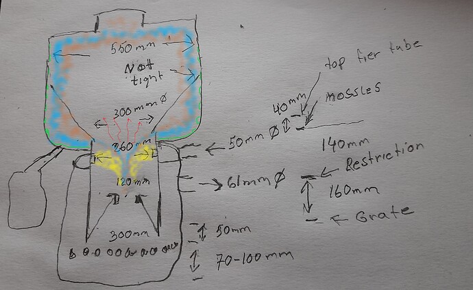

I have insulated the outside where the outgoing gas goes, so the heat will probably remain quite good, but if you look at these pictures it looks like the temperature will go down quite immediately, and I have a large cyclone, which must cool quite well , uninsulated.
If I look at the pictures, does it look like I would insulate the lower part of the hopper, to increase the heat during the pyrolysis so more charcoal was made?

Well, as you show in th pic the gas leaving the grate is relativly cool. If the outgoing gas flows next to the hot firetube, the gas will pick some heat up.
Ash cones, double walled firetubes, insulation, air voids or the way I’m trying with the Volvo - sending the gas directly to the heat exchanger - are all ways to try resque or keep the the heat in. Every little bit helps.
