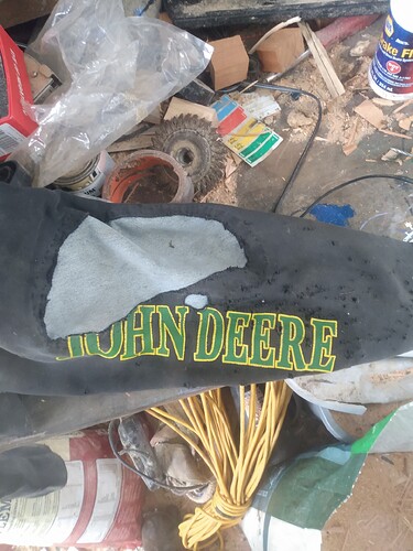

It seems we all have those stories. My brothers 78 f250, faulty starter solenoid coupled with flooded and junk motor mounts, starting from under the hood jumping the solenoid truck fires up and lurches forward crushing his legs pinning him between the now tire smoking big block and a small car behind him. Lucky to only hyperextend his knees when he reached up and in a attempt to remove coil wire ended up ripping distributor cap off and getting shocked to hell by the hi power msd ignition. Same brother had 73 Ford Maverick I claimed after it was beyond repair from cancerouse rust, no fan shroud and steel fan blade. Shop teacher in high school harped on no long hair, no jewelry, no loose clothing. 17 and dumb at home by myself I learned why, cost me a beloved John Deere sweatshirt shredded to tatters when I reached up to run the throttle manually. I took things a little more serious since that day

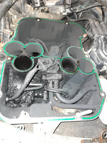

I have tested a bubble can for about 3 weeks, but see no major difference in what the intake manifold looks like, should apparently counteract tar on valves.
The first image is before the bubble can.

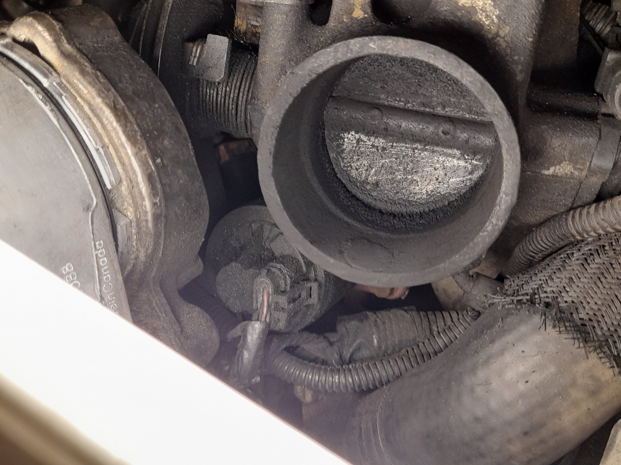

Have you tried to burn the soot yet? Very easy cleaning.
However, I find the downstream side of the throttle plate needs some manual cleaning anyway.

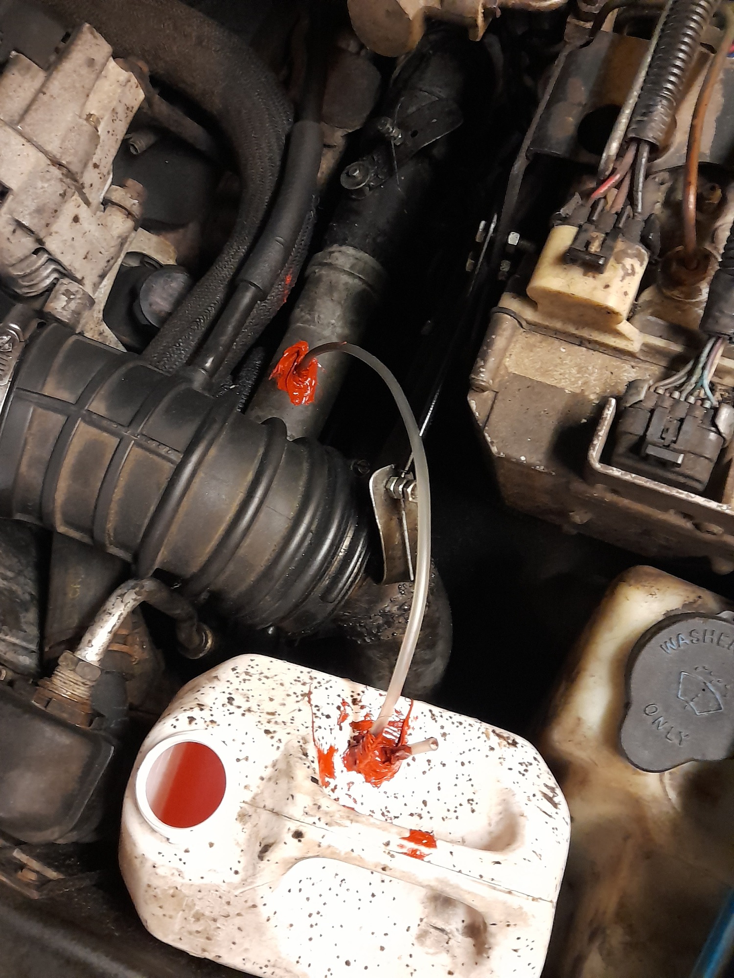

No, I have plastic pipes for the nozzles inside the suction pipe, I do not know if they would like it.
Hm… plastic protruding into the manifold?
In that case maybe best to avoid a glow fire
