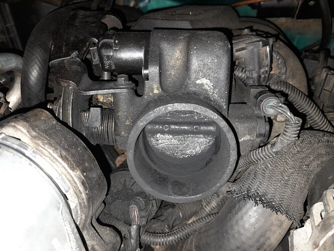

How many miles until the throttle body looks like on your pic?

I have driven about 300-400km (190-250 miles).
Is most of your driving low speed? I’m curious if rpm makes a difference in how the soot travels, I’m doing 40-50mph mostly and can clog the carb in about 3-400 miles
I usually drive at the same speed about 40-50 mph.
