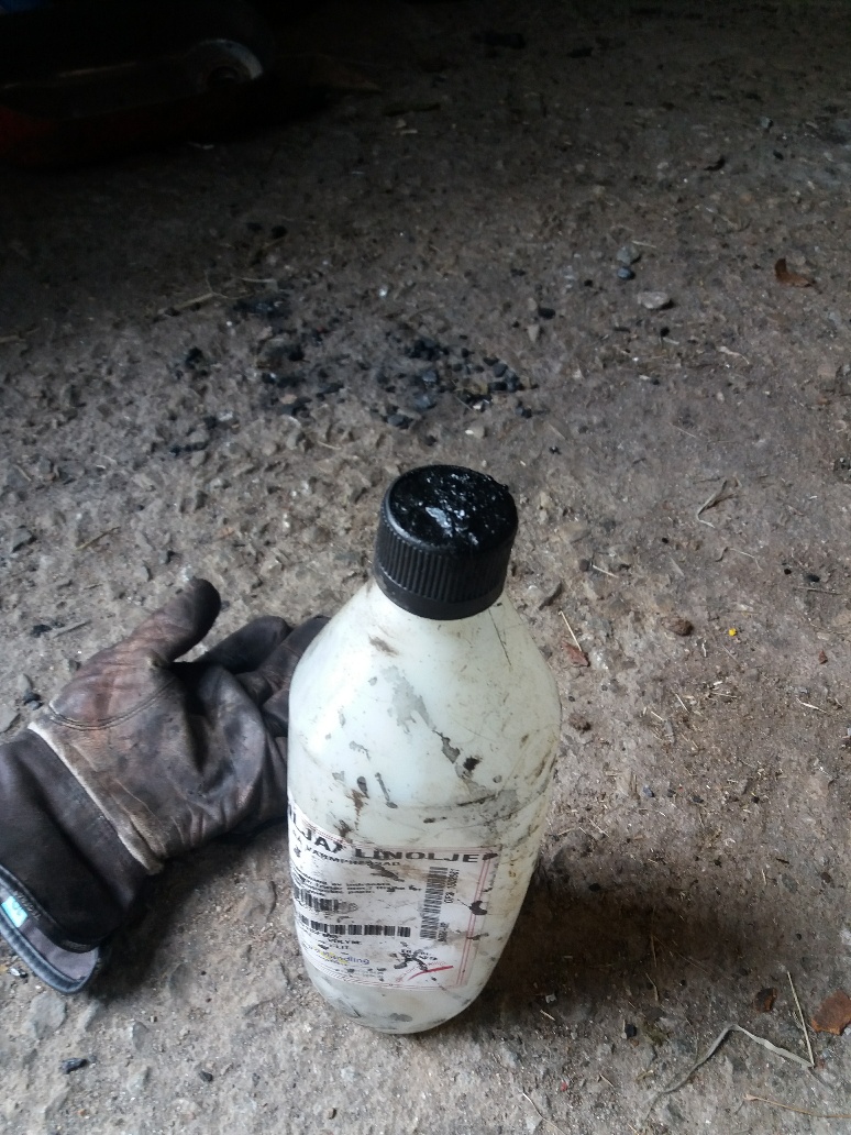

Yes, it does not seem that the unit works to removing the water, I have not received anything in the drain from the unit since I put the cone in it. But i was out and heat the lecan (clay), it contains lots of water, must probably dry it before the next test.

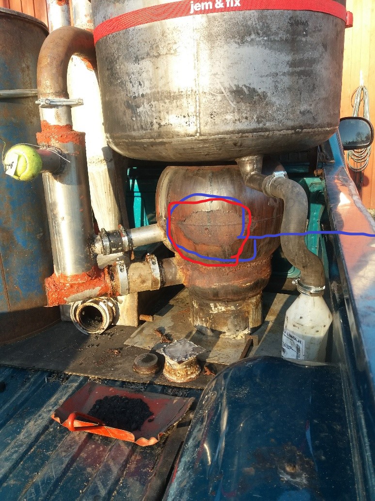

Thank you for helping me. I was thinking about what the error might be, it seems that what I do has no major impact. When I look at how I made the unit and what it looks like today, I see a place that has been very hot on the cylinder for incoming air.
Do you think I have a leak between the outgoing gas and the area around a nozzle?
I was just about to say this. There is a saying among woodgasers. There are usualy 3 bigest causes for gasifier malfunction. Leaks, leaks and leaks.
What you describe seems like a clasical hot leak problem to me. That is a leak in a hot area that burns part of the gas.
You use the push blower the leak cant pull in air so the problem is gone. Gas is good, car starts right away. Uses the good gas in the unite, but the vacuum starts leaking air in and burns the gas, resaulting in lean and wet gas (from H2 burning to H2O).
Agree. The air mantel should stay relativly cool.
Agree. This adds to the moisture problem - or it’s probably even the main moisture problem.

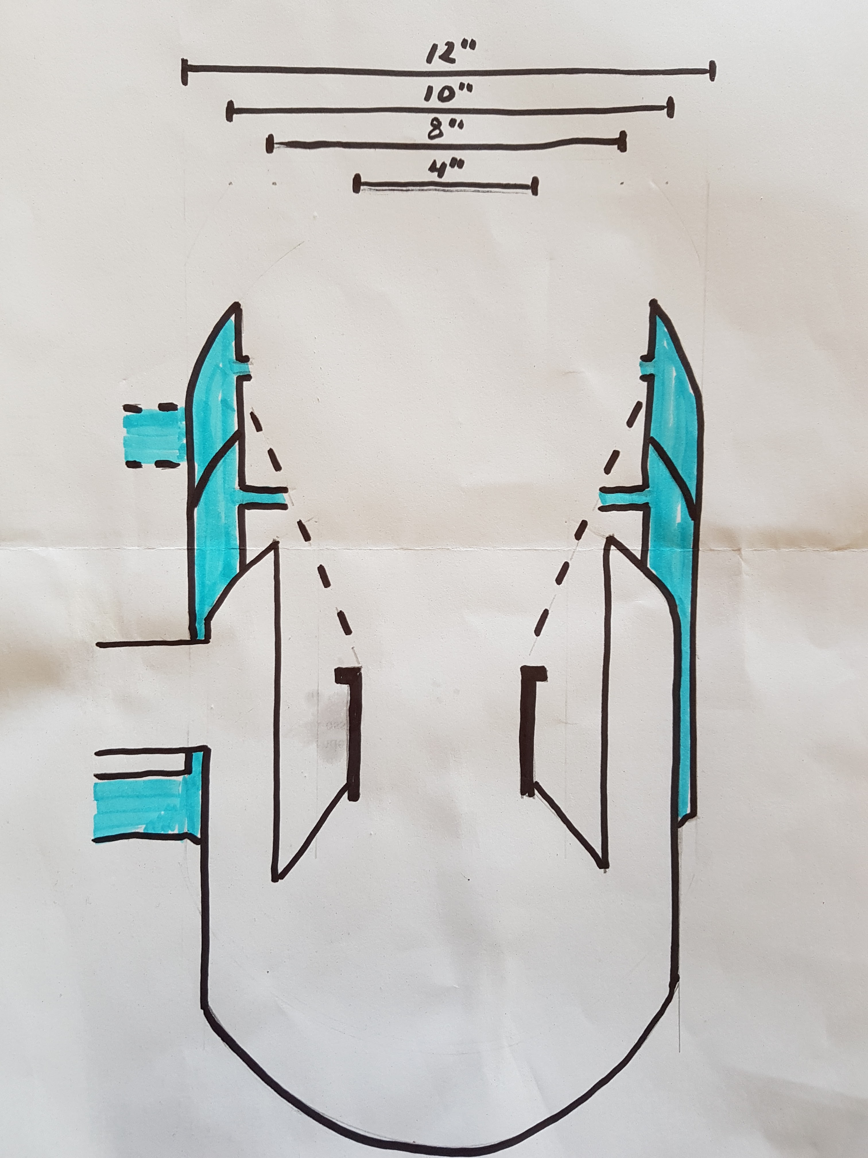

I gave a lot of thought to hot leaks when I started my build. I didn’t trust my welding skills and I think I came up with a way to have any critical weld with air on one side and hot woodgas on the other, buried in the ash cone. My thinking was the tary crust and ash would seal any pinhole. You’ve seen this old scetch before.
I took apart the heater yesterday, found no leak, tried with water but seems to be tight.

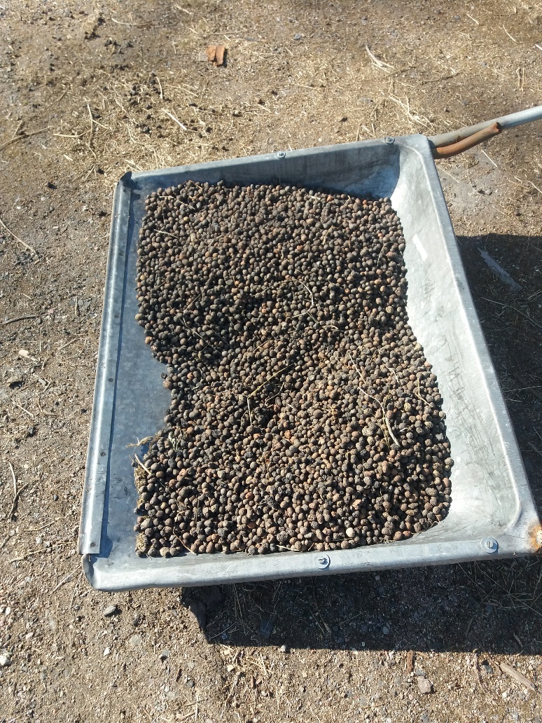

I have clay balls as filters now, these contain water, can it make the gas get too wet?

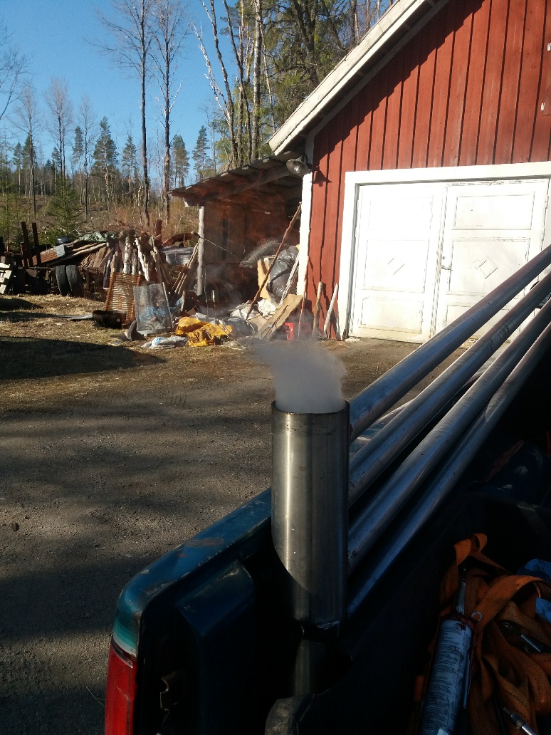

The gas burns well but is very humid.
Has run the unit with the fan about 1 hour got about 1 liter of water in the bottle, (had the cork left on the bottle yesterday when there was no water hmm, can I blame the age?)

It seems to be going much better now, but thinks it smokes a little here and there, see if it is leaks or it burns garbage.
