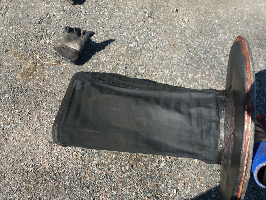

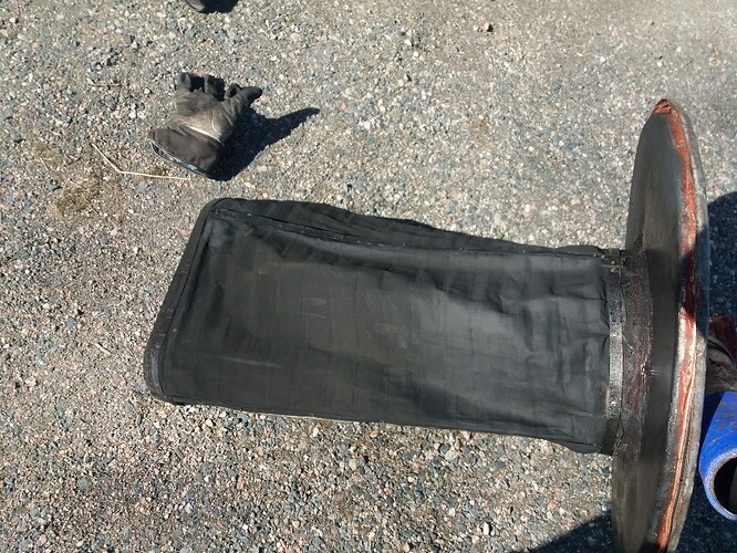

Jan, if l remember correct you use a tightly wowen fiberglass fabric? My advice is you bypass the cyclone. Now only smallest soot that gets past the cyclone gets caught on the fabric and plugs it. It is generaly better to pass all the dirt in the sack filter to make a thick porous cake that falls down on its own, exposing clear area.
No, I have a stainless steel filter, but almost as tight as the fiberglass filter.
I tried to have only the stainless steel filter, and it became a cake as you say, but have not tested if it would come off when I go with the car.

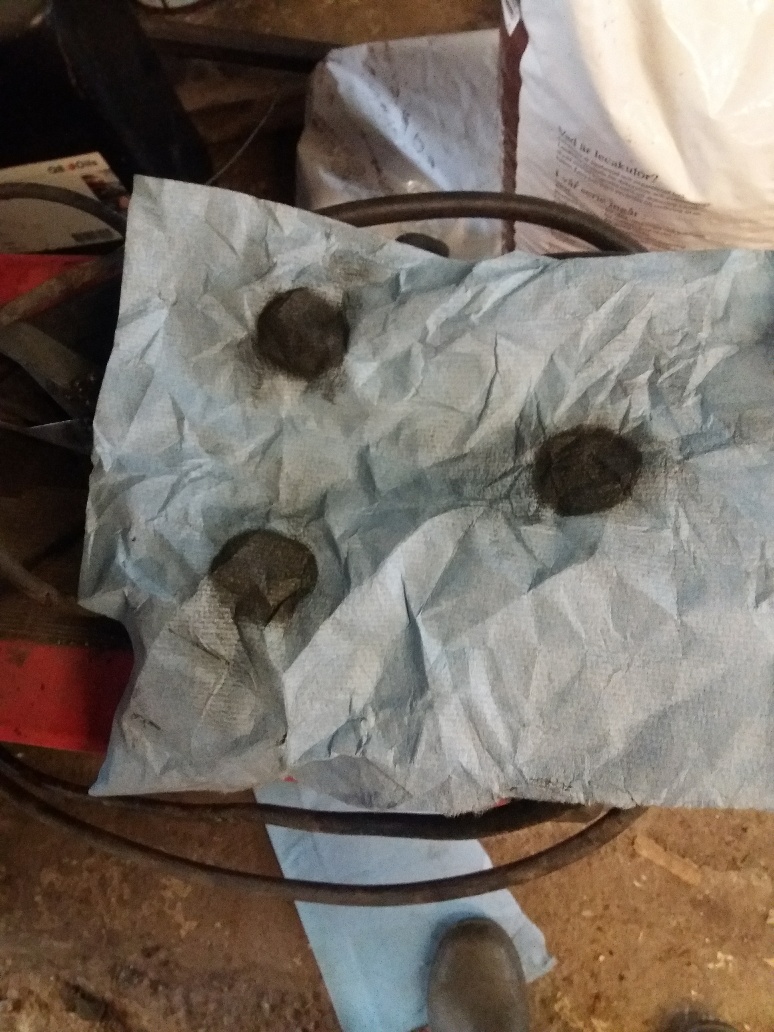

After all, I have pressure fan, so I removed the pipe under the hood and pulled the gas in there, burning well, but looks like there is a lot of water.
Very much soot, too, had the cloth against the tube about 5-10sec.
Neither gets any water from the unit, which I got before the cone.

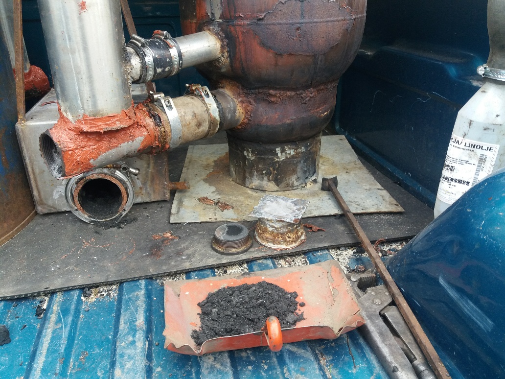

Can I have made too little space, or too low outlet for the gas on the unit, so it gets too tight down there? The carbon that is in the shovel is what was in the cyclone, also quite humid.
That carbon looks pretty close to what I get also. On short runs I get humid carbon but on long runs it stays dry. Do you have rubber connectors on there? Do they take the heat?
The upper is silicone hose, it is incoming air.
The bottom is outgoing gas sheet metal with copper paste underneath.
