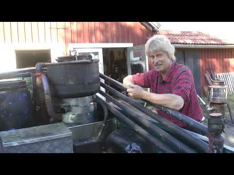

Good video, Jan ![]()
Just hope I didnāt say too much wrong, so Iām fooling someone
I need to go back to studying Swedish if I want to keep up with that sphere of influence.
Everything good. And you added a few more gizmos you never told us about. The diff-pressure meter for example. I like it.
