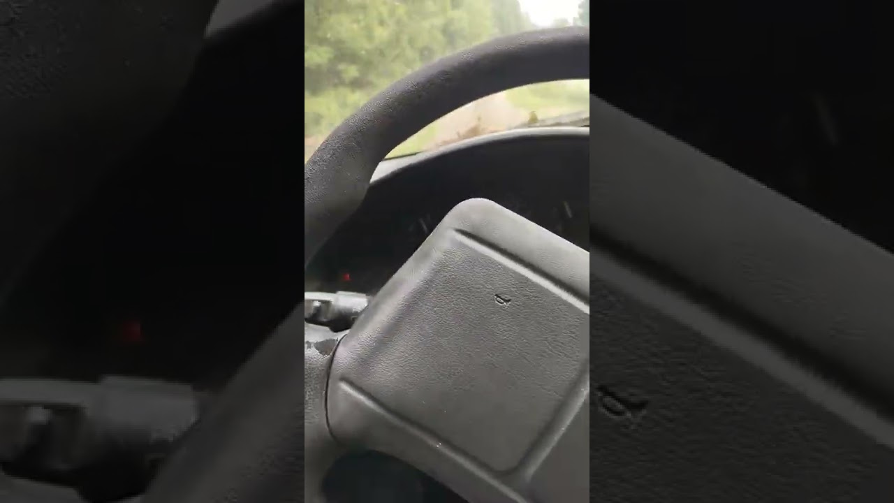

Took it for a short spin up and down my driveway, it’s actually shifting through the gears and the brakes stop the car! I’m amazed since this car has sat for so long. Really glad I did some TLC stuff like flushing the coolant system before riding it around.
It’s ALIVE
Looks like you live out in the country far enough, that motor sounded like plenty of power, it should power good enough on your charco unit. I think we have title laws here in michigan for lost titles, i got a toyuota motor home i would like too change ofer too pickup truck flat bed, and use the fiber glass camper shell on a trailer, I got too get that set up for inspecting before i chop and seperate, Good luck with the cavalier, i got one i could charco power for experiance building allso.OR USE WHEN GAS IS NEEDED.
