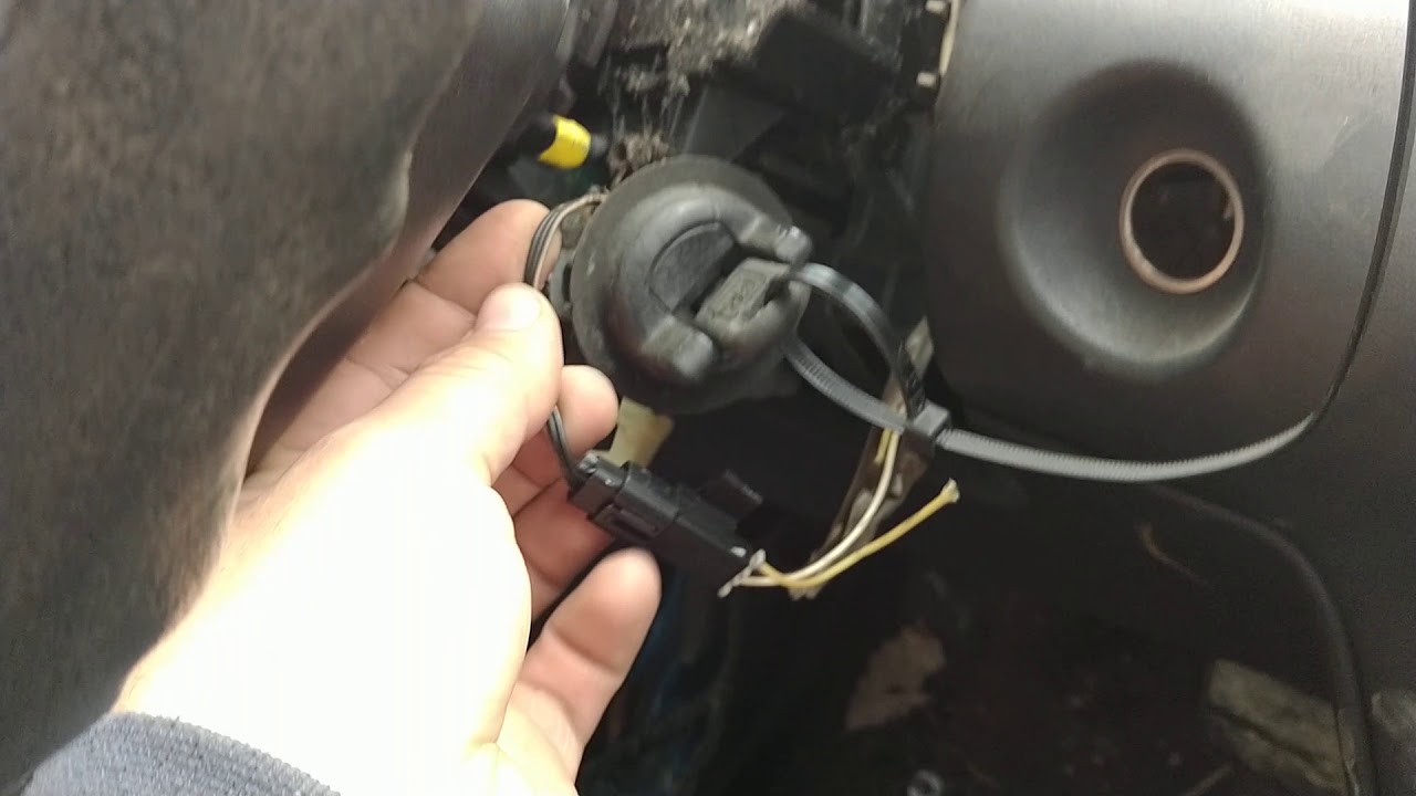

On my Jeep the way you reset the anti theft is put a key in the passinger door lock unlock lock it unlock it. Then crank the engine over and start it up. The lights and anti theft alarm will stop blinking . There was a wire on the lock that went to the computer, by turning the lock in would go to ground. I wired it to ground now the anti theft relay auto resets if tripped like removing the battery cable form the terminal. Really! Oh some one is stealing my jeep by removing the battery cable. They all ready got into the jeep and releasted the hood latch. Go figure.
My Cavalier doesn’t use a VATS system. The key that is in it now is just a metal key without even the black part on it.
If yours has the VATS system then the resistor in the bypass has to match the original in the key.
I did find a video on what wire to cut to supposably bypass whatever security system it has.
Okay so I guess I don’t have VATS. It had a standard metal key.
Since I’ve removed the pins in the tumbler it’ll move freely now. It was the bar that presses down on the pins to give tension that was hanging up in the cylinder. As soon as I crank up the car the Security light goes away. Not sure what’s going on but the car will start so I’m going to ignore the light I guess.
