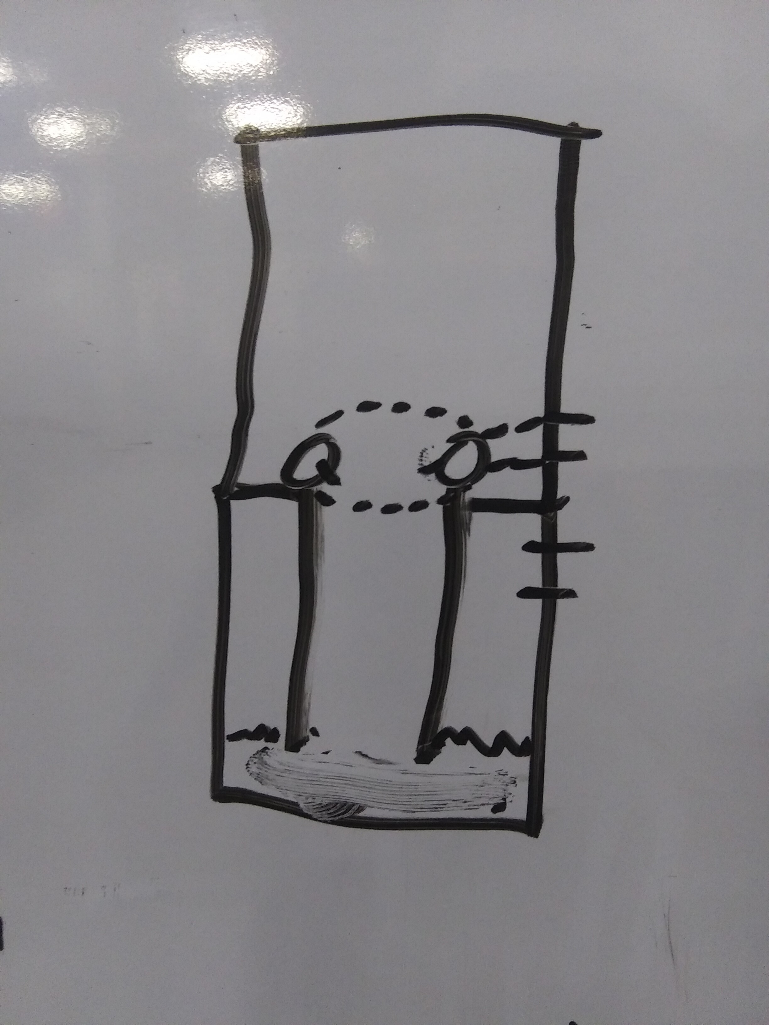

If I do make a reactor for this it will be a downdraft charcoal, I’ve been practicing making pipe rings. I just need to get a Reece Hitch adapter on the back end. Trunk is very deep and long but the trunk lid only opens up a small amount and the backglass covers the rest of the trunk compartment. Plus it is connected to the back seat.
Depending on how high the luggage rack would sit, I’d like to make the reactor in two halves, the air inlet and where the magic happens being below the rack and the hopper being above the rack. I can reuse my ammo can sack filter and I can make up a small cooling rail to go around the unit.
I have in mind a rectangular hopper with some ramping to allow charcoal feeding. I’d like to still have visibility through my back glass.
I’ll try to draw something up.

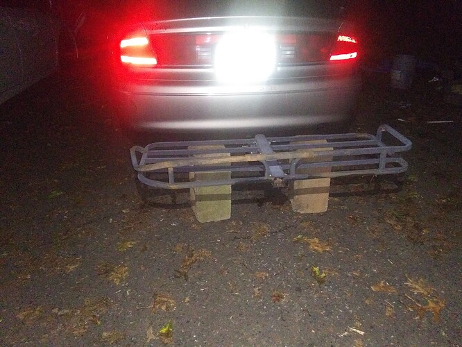

Looking at how this luggage rack sits compared to where the hitch would be, maybe having it over and under won’t work so well.
The 500lb capacity racks at harbor freight don’t dogleg making them sit lower. This would give me more height for the reactor. This dog legged one is only 300lb rated.
I would need to get air ride shocks so the weight of the whole unit won’t make the back end sag leaving risk of scraping. Or at the very least some very stiff struts and new springs.

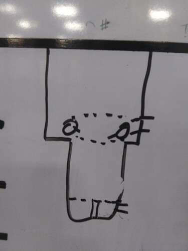

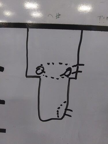

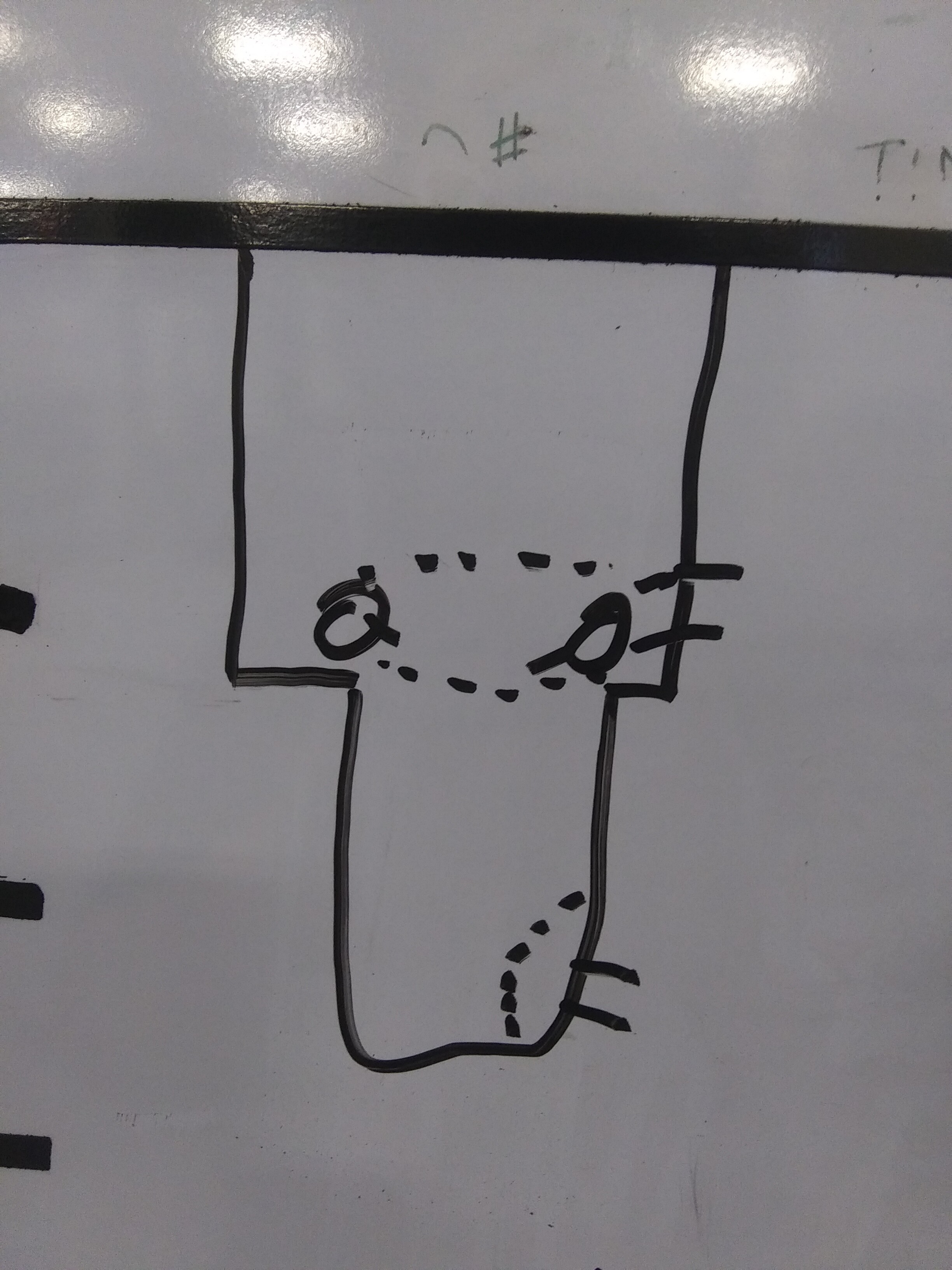

I’m wondering if a grateless Mako would be worth the effort or if I should go for a rotating grate like the original? It seems like it would act like a fixed grate until you rattle the shaker manually.
Think bottom drum with fire tube going in, and charcoal just spills into the bottom of the drum with gas exit being below like most others.
