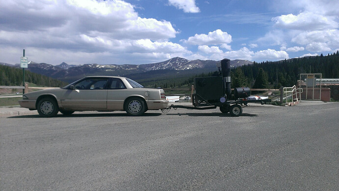

There she is! I drove that car all over the country coast to coast many times when I traveled for my job. It hauled that trailer with those gasifier to V Grid Energy Labs from Mich to LA twice. Over mountains and deserts and she got her done.
