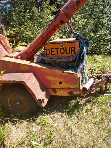

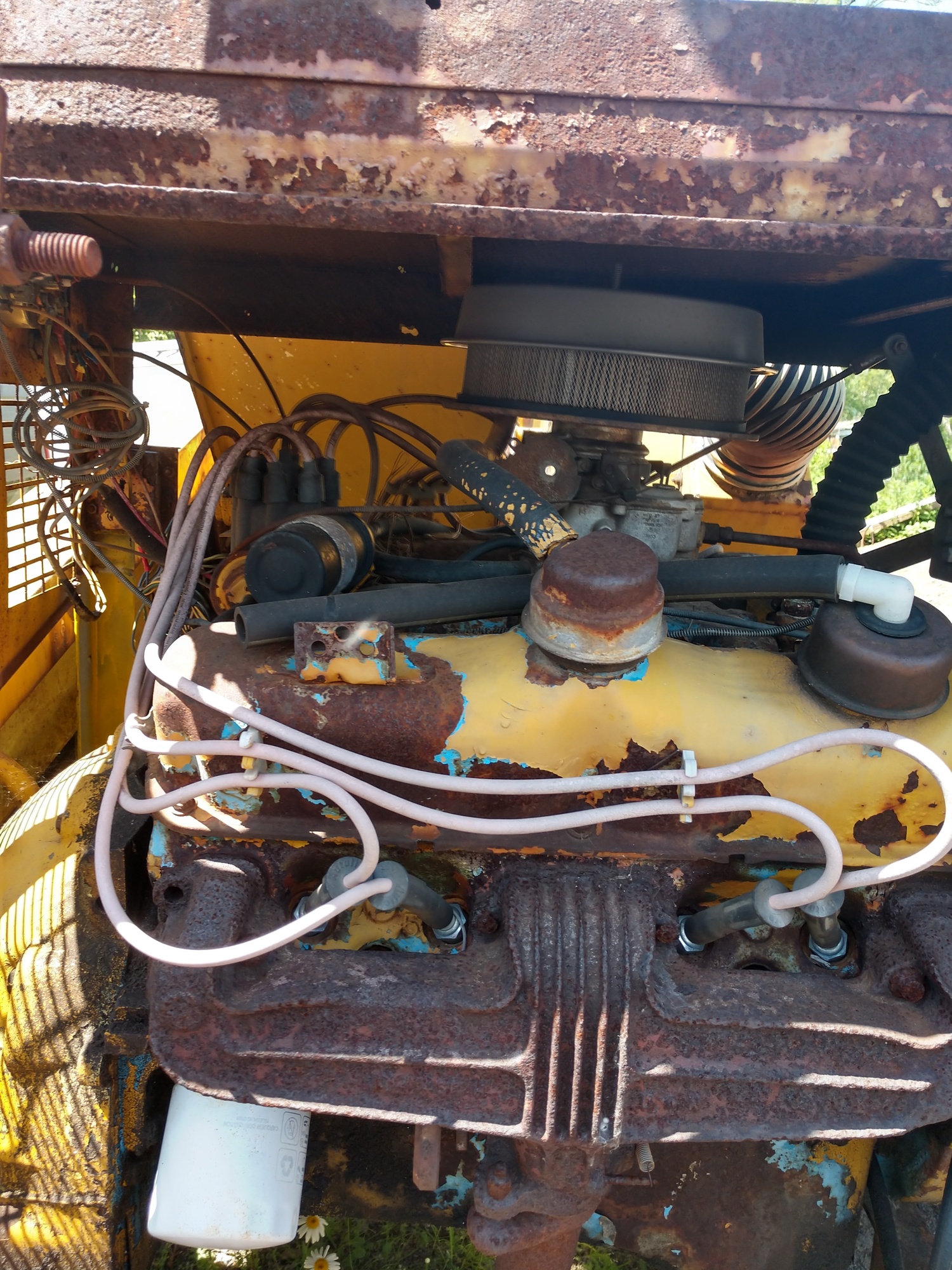

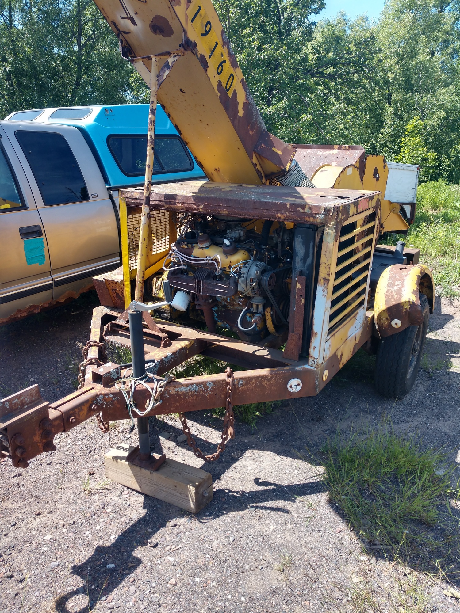

Bruce, that is the type of machines I look for – if the price is right !
Another one $1200
I watched a video about Jean Pain on YouTube. I have most everything we need just need an industrial chipper or a road legal dump truck. Chip can be had free at the township dumps, or there is enough brush here to chip.
Something closer to $200. I don’t recommend doing a heat compost pile, unless it is just for entertainment. Don’t spend hard earned money on it. At least wait until I finish explaining my experience.
