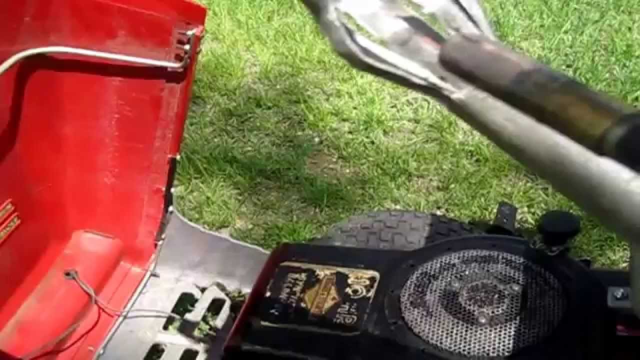

I have been hi-jacking the Simple-Fire thread when showing my attempts at charcoal gasification so now that I did the walk around video I promised, I thought I would start its own thread. Sorry Gary. Every time before when I started the tractor it started right up and stayed running but you know it never does that when videoing or showing somebody. I had the throttle closed when trying to start it for the video
Here is the video:

Hey Jeff, that fill lid was already on that container when I first saw it at an auction. I right away saw the advantages of that container for a charcoal gasifier. It was used previously for military propellant storage. I love walking past aisles of “junk” that is meaningless to most people and visualize potential uses for it. Sometimes I strike it right and sometimes it sets around a while before it gets used. This time I struck it right.

Well I made a happy discovery today. I mentioned on the hangout last night that I had a bad oil leak in that lawn tractor engine, When I filled it to the full mark on the dip stick, it would all leak out down to the bottom of the stick. Well I found out today that somebody put the wrong dip stick in there and I was over filling it.
I now have the exhaust hooked up to the gasifier with a valve to temper the reaction. It is really interesting how adding hot exhaust will cool the reaction and opening the valve turns that white hot inferno into a nice orange reaction. Started right up today while I was by myself after that humbling experience the other day when my throttle was closed for the video.
