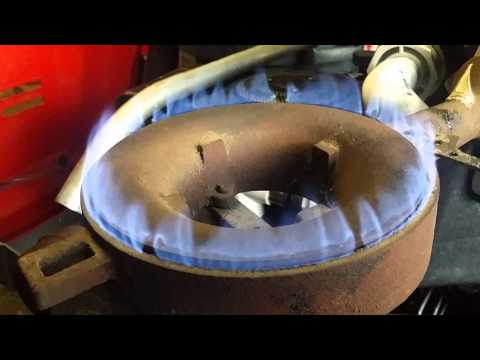

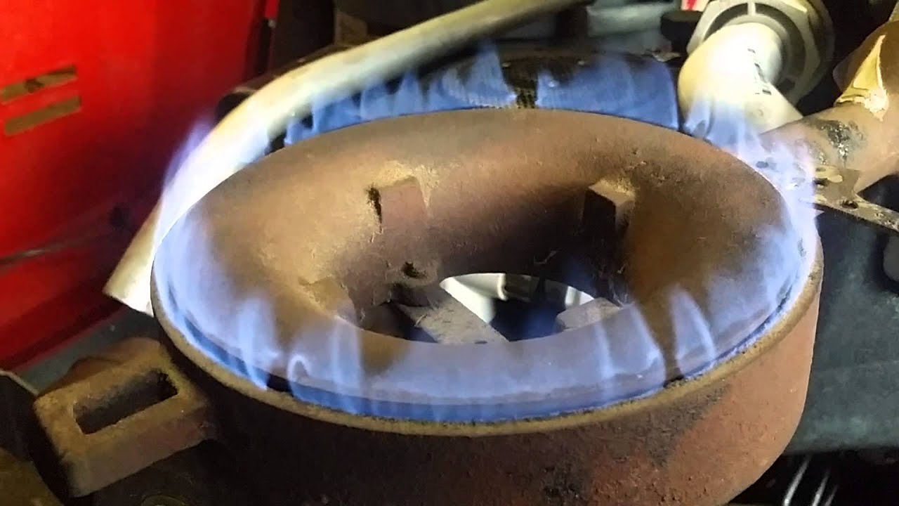

I found an old cast iron burner that I hooked up to my flare discharge just to see what would happen. This happened . . . .
I like the burner Don, even a new zero turn won’t cook lunch. I have not played with charcoal all summer. that will change as soon as I get my mobile WK retort up and running.
That’s something to write home about! Sweet!

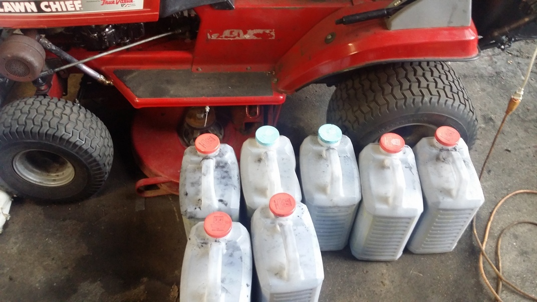

I snitched 7 wide cap 2 1/2 gallon plastic jugs out of the recycle bins to use for storing and refilling the fuel for my charcoal lawn tractor. This will make for fast, clean and easy fill ups with just about the right amount of charcoal using 2 jugs at a time. I think they originally held kitty litter. (notice my mower deck? - not hooked up yet.)
Pretty handy, Don. Do you need a particulate mask when refilling?
Not if the wind is right

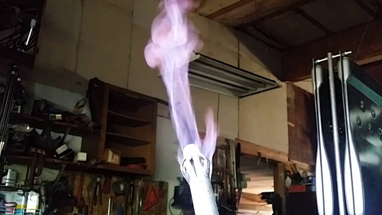

I lost my governor spring and the one I found in my box of springs would only give me 2600 rpm so I ordered the correct one and now she really goes! I have a belt driven generator that needs 3600 rpm or I could use step up pulleys but I would like to milk out all the power I can. In trying this out I got this beautiful flare that I just had to video!
