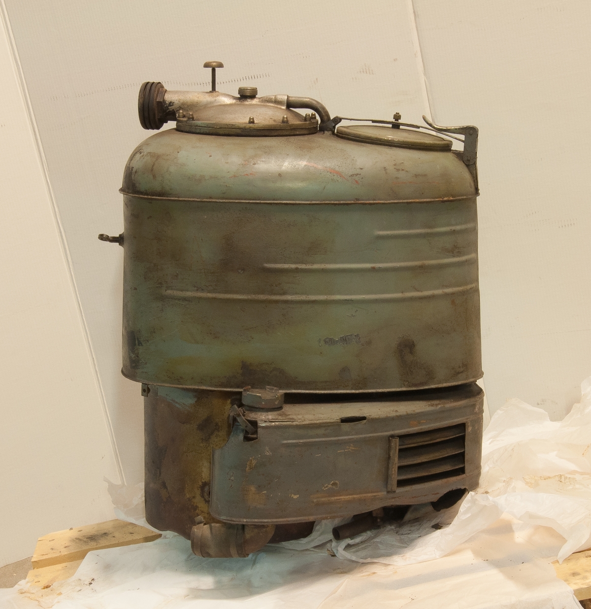

Still have the Svedlund gasifier in the barn. Tell me what dimensions you are looking for and I’ll help you out. Haven’t been active here in a long while like you said but I haven’t lost interest. I’ve become a welder so that I can build components of high quality and I managed to spend six months as an apprentice at a engine rebuild firm. Taking the long way round to building my own gasifiers. :wink:
Good to know you’re doing alright. I always have liked the idea of gasifying motorcycles. I might get a sidecar mod for my Kawasaki Vulcan just to do it.
As far as dimensions I was wondering what the inner diameter of the nozzle was if it’s still that single downwards pipe.
Honestly a photograph of the inside of the reactor would be really neat.
Sidecars are fun! And gasified motorcycles even more so. I’ve managed to see some on events around here. I think I have a picture or two laying around. :slight_smile:
I don’t live at the family farm any more but I’ll go there next weekend to chop some wood. I’ll take some pictures and see if I can reach the nozzle with a measuring tool. :slight_smile:
