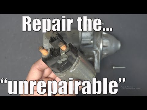

It is probably as simple as the body roll crimped in main contacts in the solenoid are arc-worn down not making a good electrical delivery contact.
Some low percentage faults you can check for from 16 years and a few hundreds of thousands of starters:
That copper washed round body magnetic plunger should be able to be easily pulled in& out. Have no binding or catching points. lever arm pivots wear - especially the plastic ones! The machined splines on the armature shaft can groove wear causing movement binding.
Another one:
the end gears on the overrunning clutch drive is chamfered on one side. This is to allow for a slight turning back engagement. The gear teeth tips be worn back, then blunt. You will then just go clicky, clicky. The overrunning drive clutch can freeze lock up not allowing the turning back for alignment and full throw gears engagement: then again click’s, click’s only.
You can with the starter out test for drive clutch slipping by jamming the end of a piece of hardwood against it kicked out running. It should eat up the hardwood and make lots of wood smoke.
The wood stops the drive gear - then a bad worn drive clutch.

it is possible to make roll crimped solenoids serviceable, if you have access to lathe.
cut it open,
then cut a fine thread on the rear end of solenoid (1mm pitch or similar in order to keep the thread shallow)
and make a knurled nut so it can be tightened by hand.
