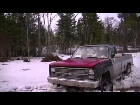

Here is a 1991 Chevy 6.2 liter diesel. We had it running well enough to go up onto the trailer. We paid less for the whole truck, then we could find a used injector pump for…
